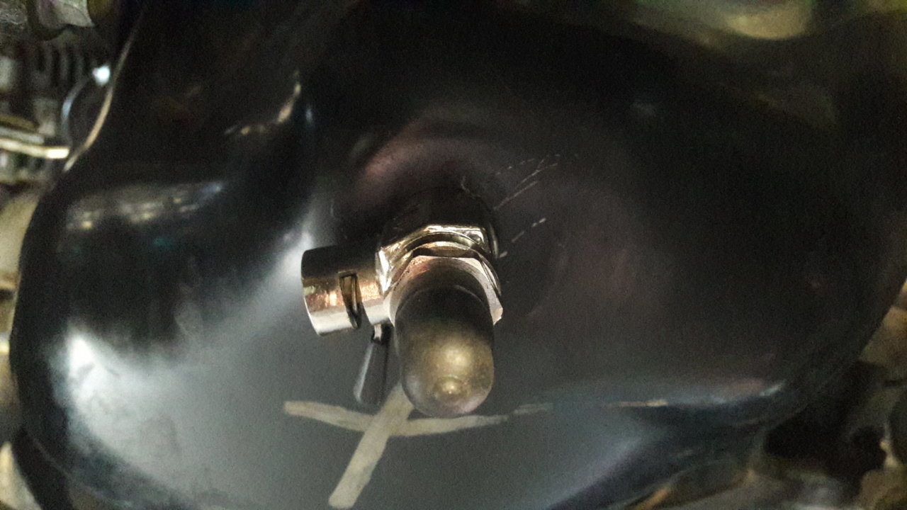

    I also installed a Fumoto valve. I'm going to try using an inexpensive 12v transfer pump to speed up the process.

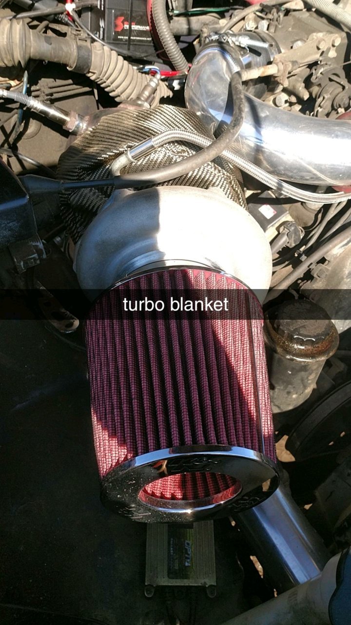

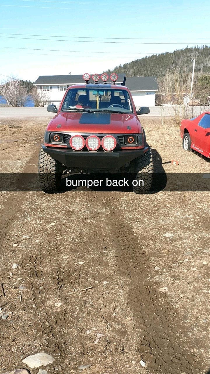

    put a turbo blanket and gona heat wrap the piping post intercooler. rebedlined my bumper too.
    not shown but i relocated my trans dipstick away from the wastegate.

    Going to wrap the cold side piping? You may be better off with that gold foil. The wrap might keep heat in. The foil will just reflect heat from absorbing.
    Plus it looks race car AF.
