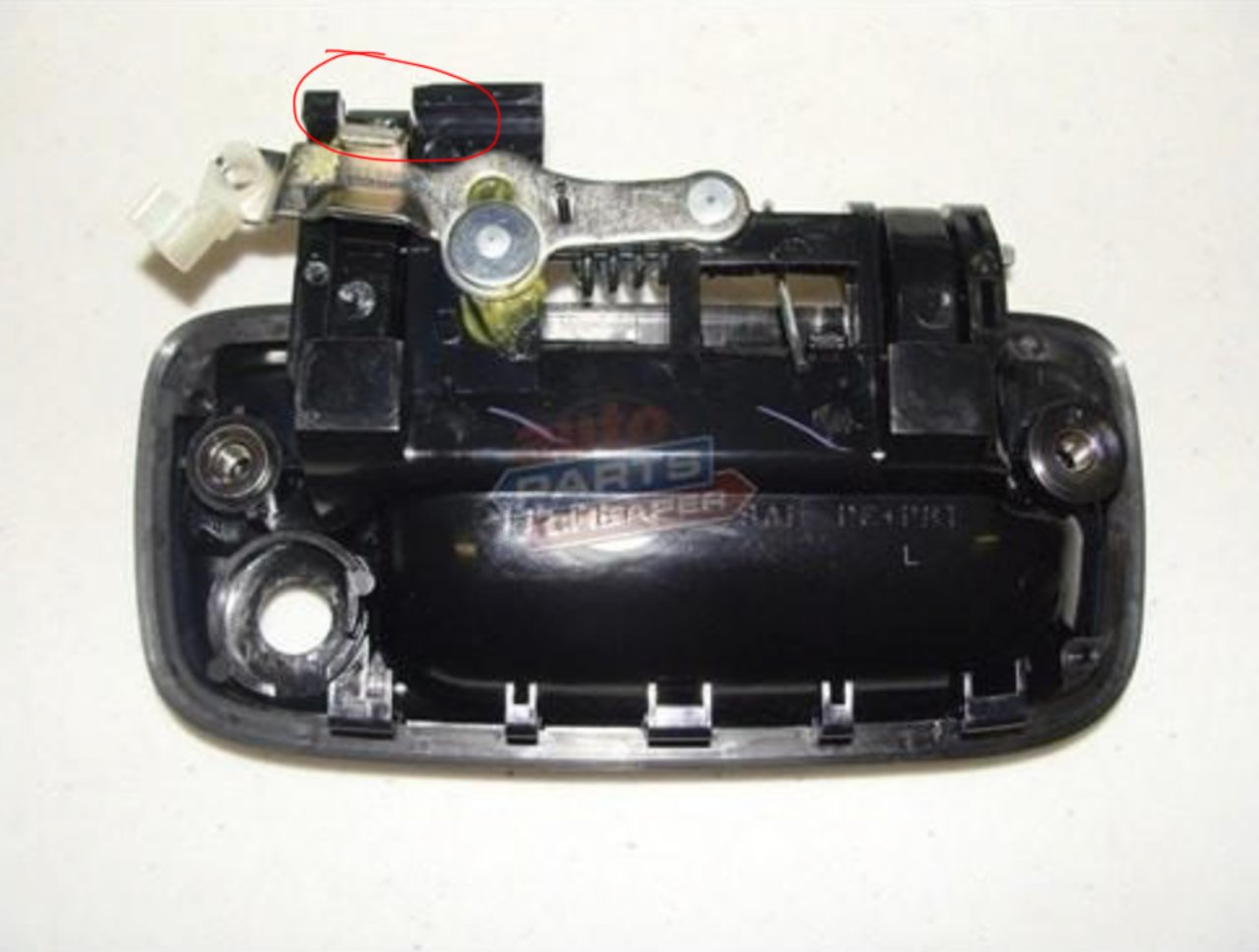

    unfortunately it's not a part that has to do with lubrication, at least not as far as I can tell. It's the lip (circled in the photo) that stops grabbing and pushing on the metal latch; it basically just falls behind it and doesn't engage the handle at all.
    I've had this happen to 3 OEM handles, 2 were brand new. The Dorman brand has a bigger lip that goes over that metal latch.

    it's weird though because they were all brand new, greased up from Toyota and everything. To fail so quickly (each one within a week to 3 weeks) makes me think there's something up with the rods in my door. That one rod that connects to the white plastic clip on the inner handle might be pulling backward and causing the metal latch to fall out of alignment with the lip. Who knows...I'm so over my door issues lol.
    Knock on wood the Dorman handle is holding up the best so far, so hopefully I'm good for awhile.
