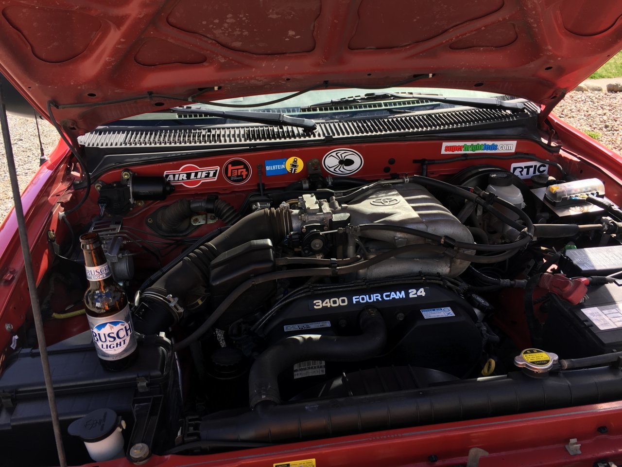

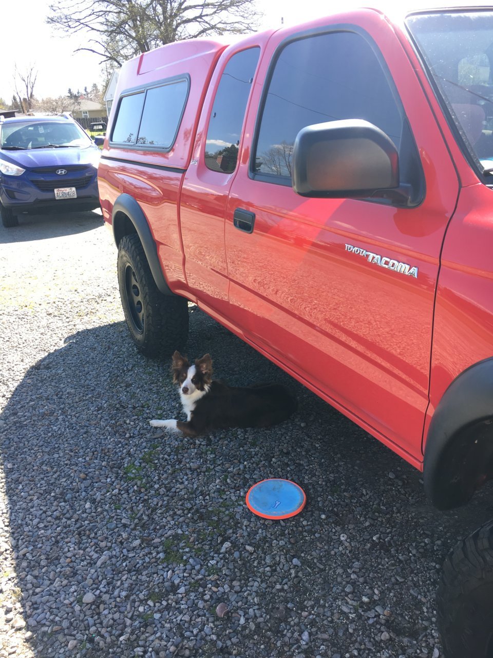

    Rotated my tires today (idk why they rotate every time I drive), notched my air bag perches so the drivers side would stop coming into contact with my shock, removed my rusty center caps, repainted my rear reinforcement plates, now I’m working on new belts and chasing a pulley squeak. I went with autozone belts because they only have to last 20k until I do my complete timing belt kit but one of the belts are already frayed. Typical autozone. A7C098E8-3886-4C10-8F91-218952523675.jpgF1BF266E-5EEF-4BE6-A8AF-3CD06CB11D44.jpg4FA80C5B-FABF-46D6-938D-3AE3FD7023AE.jpg
    Also detailed my engine bay up real quick. Still needs some work.

    If you're having a pulley squeak issue it can be from misalignment with other pulleys and be causing your belt fray issue too. Engine bay looks super clean, mine is a full on mud pit :/

    The frayed pulley came like that out of the box. My pulleys all look good and the only one that seemed to have a little bearing play in it was the ac compressor. The bottom ac idler pulley does it matter which direction it goes?

    So I flipped my idler pulley around from how it was last time and no more metal on metal constant squeak! I think my last one was bad and then I put the new one on backwards (I matched what was existing so I’m not sure what happened there). Also replaced the fuel filter today! Onto the GFs sway bar bushings.

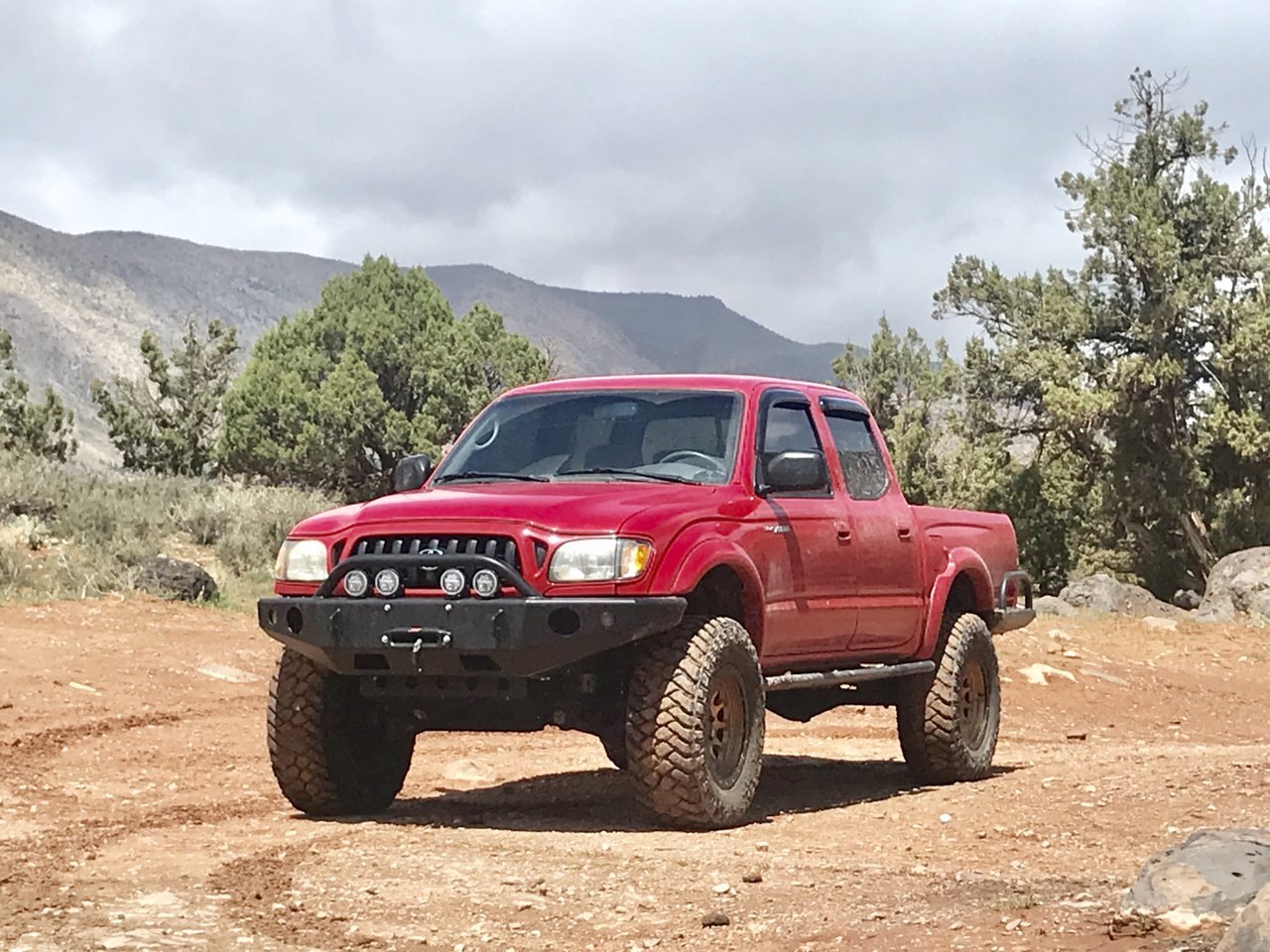

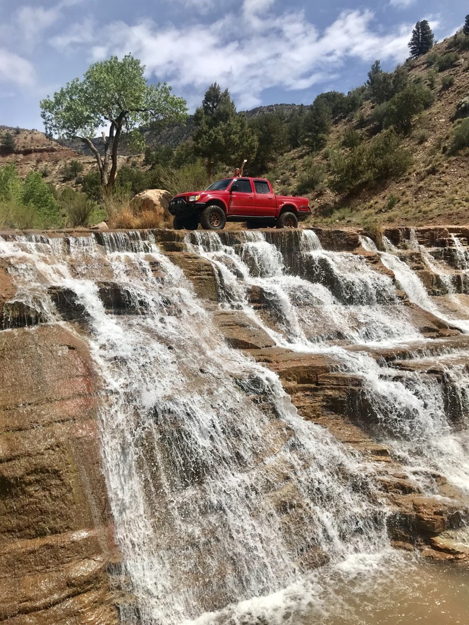

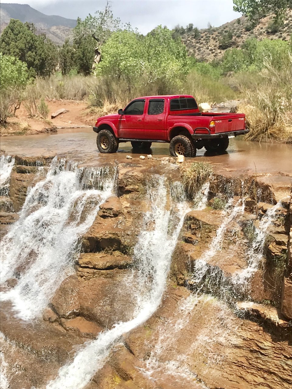

    Not all done "today" but last week was finally able to get the front bumper, winch, lights installed (still need to install final 2 lights in the fog cutouts), Shrockworks skidplates, CV's pulled and new CVJ silicone inner boots installed (with boot stretch mod), new OEM outer boots, 700lb coils installed for the added weight of the front bumper and winch, and front and rear 4.88's installed.
    Then we promptly left (after breaking in the gears of course) and are in the middle of a 2500 mile road trip right now! Kid is on Spring Break and we figured we'd get out of the snow for a bit and head to warm weather...spending the week in Zion National Park/St George area. Hoped to go wheel at Sand Hollow while i was here for a day or two, but we've ended up spending more time in Zion than we expected (and that was the main point of the trip anyhow). However, we did get out today and checked out Toquerville Falls just down the road from Zion thanks to a recommendation from @Mallburg and it was pretty awesome!
    Heading back home tomorrow, but here's a few pics with the new front end and other components you cant really see lol...

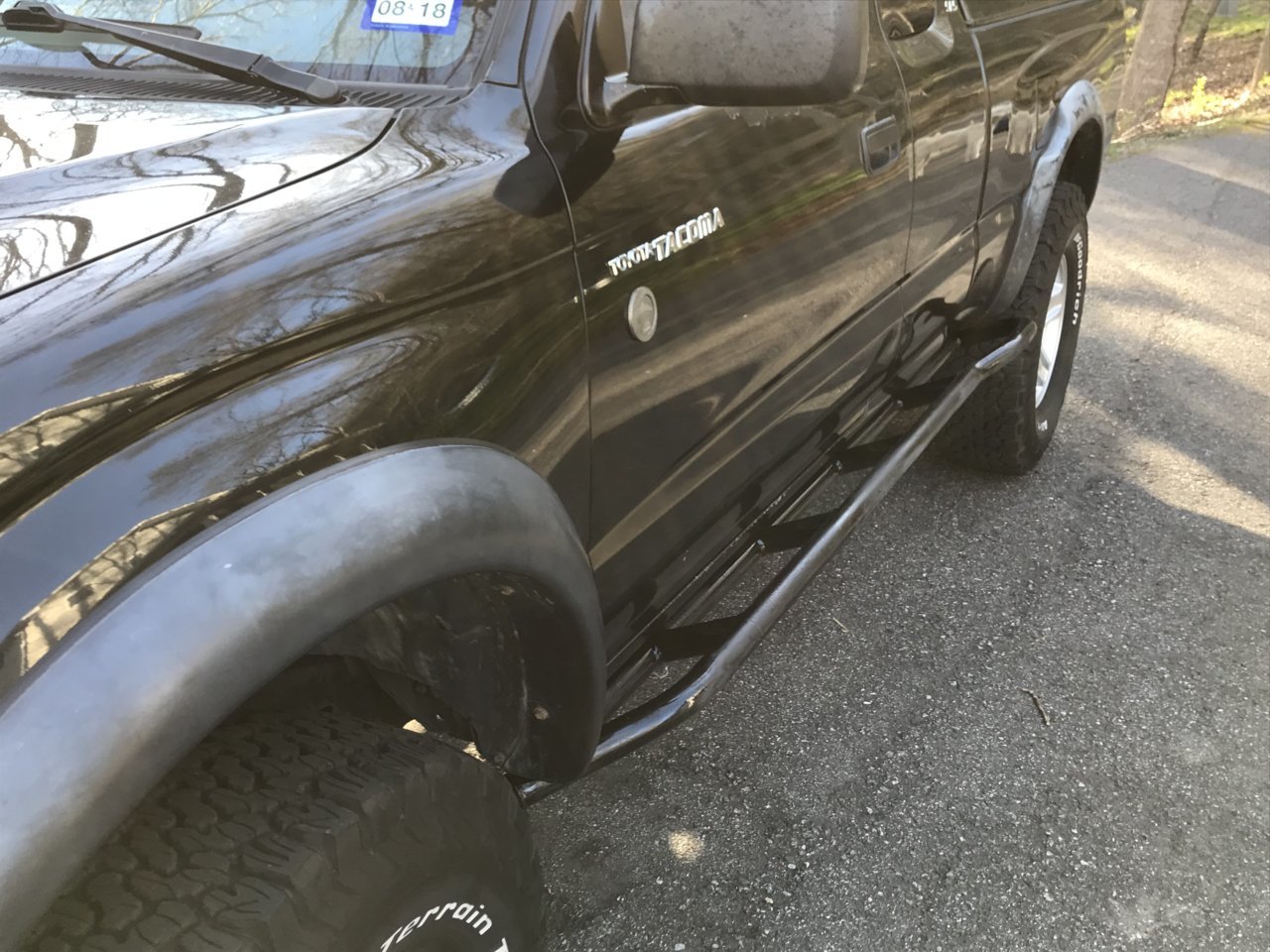

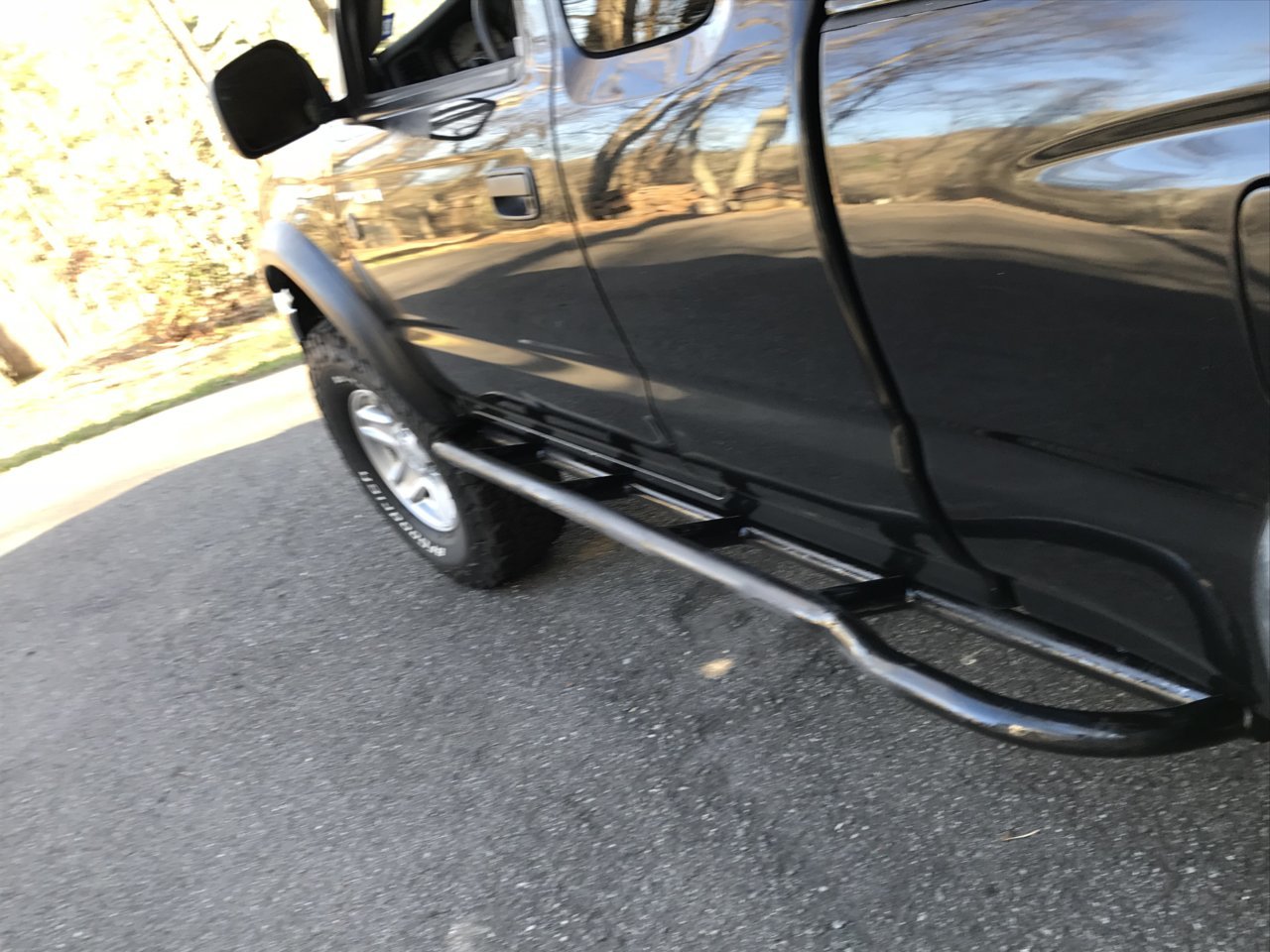

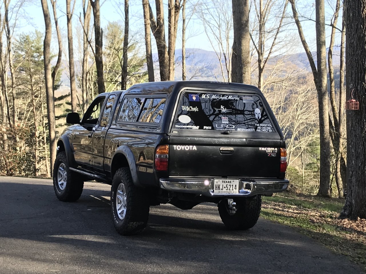

    After three visits to the 4x4 shop... finally got the sliders welded up...can’t wait to get em scraped up! :mudding:
