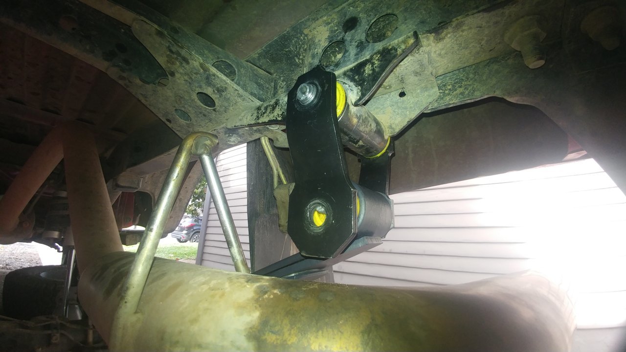

    I might not be using the right term...the hangar toward the back of the truck that holds the leaf spring, there's a plate that pops off when you unbolt the 2 bolts. I put the new leaf pack in and now that plate won't line back up with the 2 bolts, I'll post a pic...

    I'll give it a shot, I've tried moving the axle in all different directions but it doesn't matter, I'll try doing it via the spring pack.

    This is what I mean, been fighting this for 2 hours

    It's upside down...

    ...not according to how it's mounted on the other side (still my old stock pack), wider side on the bottom

    Well, everything looks to be right otherwise and there's really no way it can get out of whack. You should just give flipping it a shot

    Yeah it's weird. Here's a better pic of it, looks like it's bent but when I remove the bolts they're straight.
    It's the pack itself that's slightly twisted, moved the axle in every direction and it won't line up.

    That pic helps a lot, your shackle stud is backing out so it is bending upward a bit, either pry the leaf down by the shackle or maybe rig your jack to push it down. Even releasing your other side of your axle will help, it is just pushed too far sideways. Youre flexing it and it isnt helping

    You need to cut a 2 x 4 block into a wedge and pound it in that narrow side.

    I swear I thought the same, but a pry bar and some elbow grease should lower that bolt. @eon_blue

    FUCK YA I GOT IT!!!
    Feels like I just won a battle, haha. Had to rig up a pulley system with ratchet straps going around the floor jack while it supported the weight of the truck, was sketchy but I managed to just barely get it to line up enough to slam it home with a mallet. Now on to the next side.....

    Loosely yeah, believe me I read 100 different ways to make it work from different threads on here, half said U bolts on half said off...tried with them off and it wouldn't line up either. @Speedytech7 was right, there was a small amount of flex in the back and it was throwing it off...my driveway isn't level from side to side which was the culprit I think.
