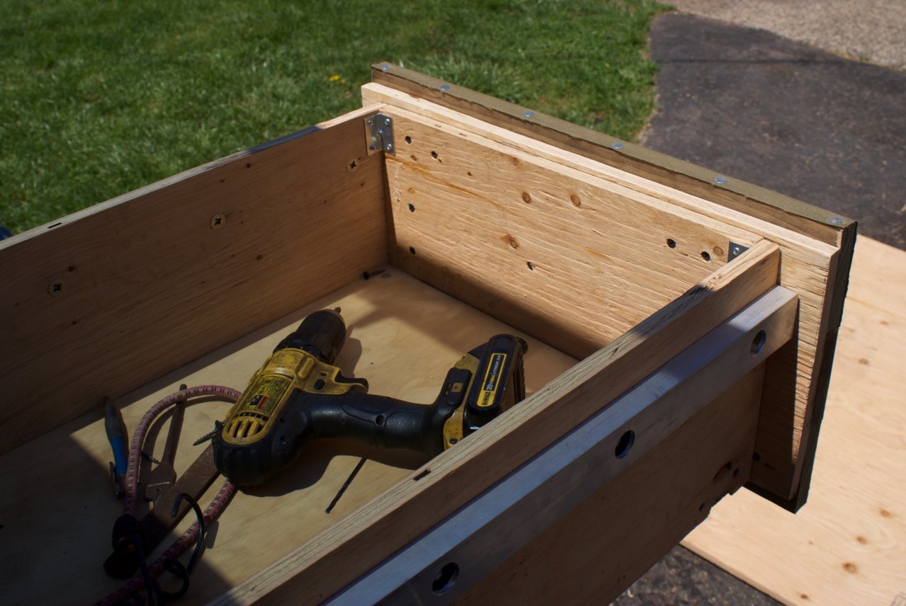

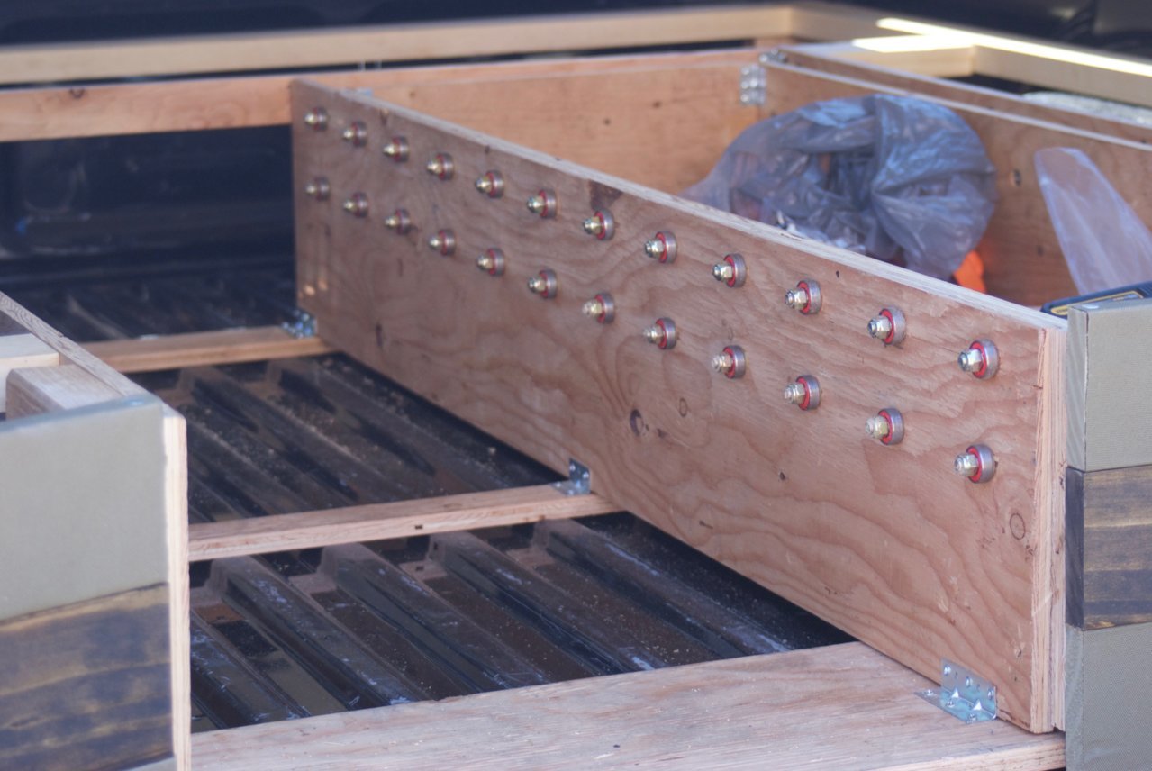

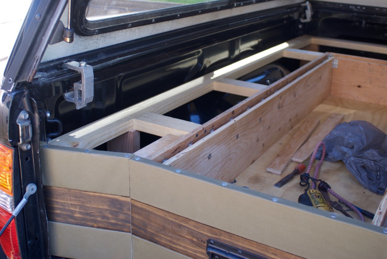

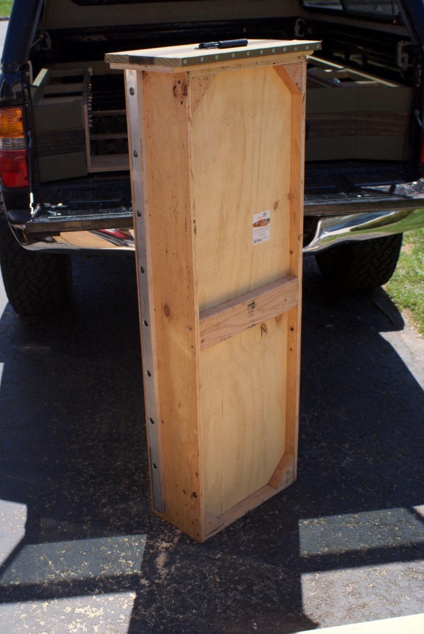

    I made most of it with 1/2" plywood, If I were to do it again Id definitely use 3/4" for the boards holding the bearings as I had a lot of issues trying to get them to stay straight. The border around the outside is 5/4 x 2.5" boards that I did to hold the weight better and to reinforce the sides with the bearings, I didnt use 2x4s because they were 1/4" too wide to fit over the wheel wells. The bearings I got on Amazon, a pack of 100 for $25, I might add more bearings near the ends to hold the drawer weight better when they're pulled out. making sure the bearings were almost perfectly straight was also difficult, probably the hardest part, and if you do this idea, take your time drilling the holes and make sure they are straight and on the exact points you marked, if they are off the drawers will either get pinched between 2 bearings or the drawer will have all its weight on only a couple bearings.
    its bolted in with only 2 bolts near the back, I put rubber washers on the inside and outside to attempt to keep water out. Im gonna have to add another 1 or 2 bolts near the front to hold it down when the drawers are out, but its extremely sturdy as is. I made sure the front boards were high enough that the platform would sit behind it instead of on top. I also made sure to keep the platform just under the tie down points so i was still able to use those, so its about 10" high. All the side compartments are going to have lift out boards to access them, The reason the front end is empty is because I plan on putting a 21 gallon water tank and possibly a dual battery setup there.
    The drawers were made with 1/2" plywood for the sides and some random thinner plywood I found in the garage for the bottoms, I used 2/4 corners and a board in the middle to hold the bottoms. The rails are 3/4x1.5" aluminum sharp corner tube, I drilled 3/4" holes in one side to fit a ratchet in to tighten the bolts, I used some countersunk stainless bolts for the insides so they'd sit flush. The fronts are made by basically screwing in 3.5" boards (can't remember the width) into a single 1/2" plywood board, I stretched and spray glued the canvas onto the fronts and then used roofing nails to hold it nice and stretched. Im gonna try to get strong magnets to hold the drawers closed but if not I have a slightly more complicated idea lol. I was planning on covering the entire platform in that cordura canvas but might go a different route now. I haven't cut all the pieces for the actual platform yet.

    Nice work!

    @Lux I'm planning a similar setup, I want some extra storage at the cab end of the bed.
    Not sure if I'll do drawer slides like that or not, I was thinking of using low friction slides on the bottoms, sitting right on the bed.
