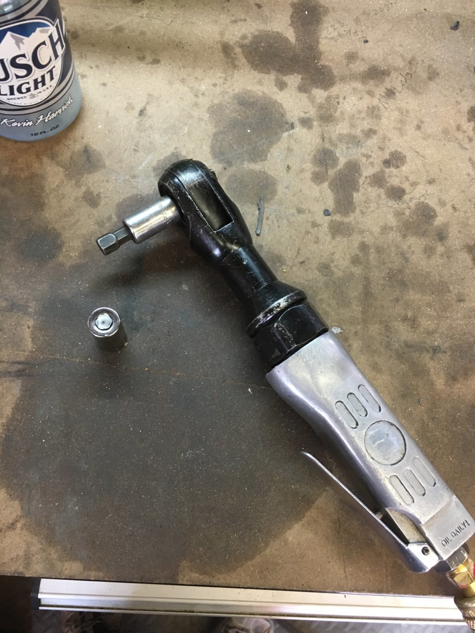

    Any tips for getting the drain plug on your front diff off? Just busted my 3/8-10mm Allen socket off trying to get it to bust loose with a breaker bar. 1/2” next? Heat?

    Airhammer with a chisle tip

    I’m not sure if I have a chisel tip. Spinny motion or jacking motion?

    Spinny motion, the cisle tip can essentially grab the edge of the plug and get it started spinning. You'll need a new plug for afterward though.

    Good thing I have two of everything. Got it off having the air ratchet going as hard as it had and me giving it all 135 pounds of what I had. I always forget I have air tools haha thanks.

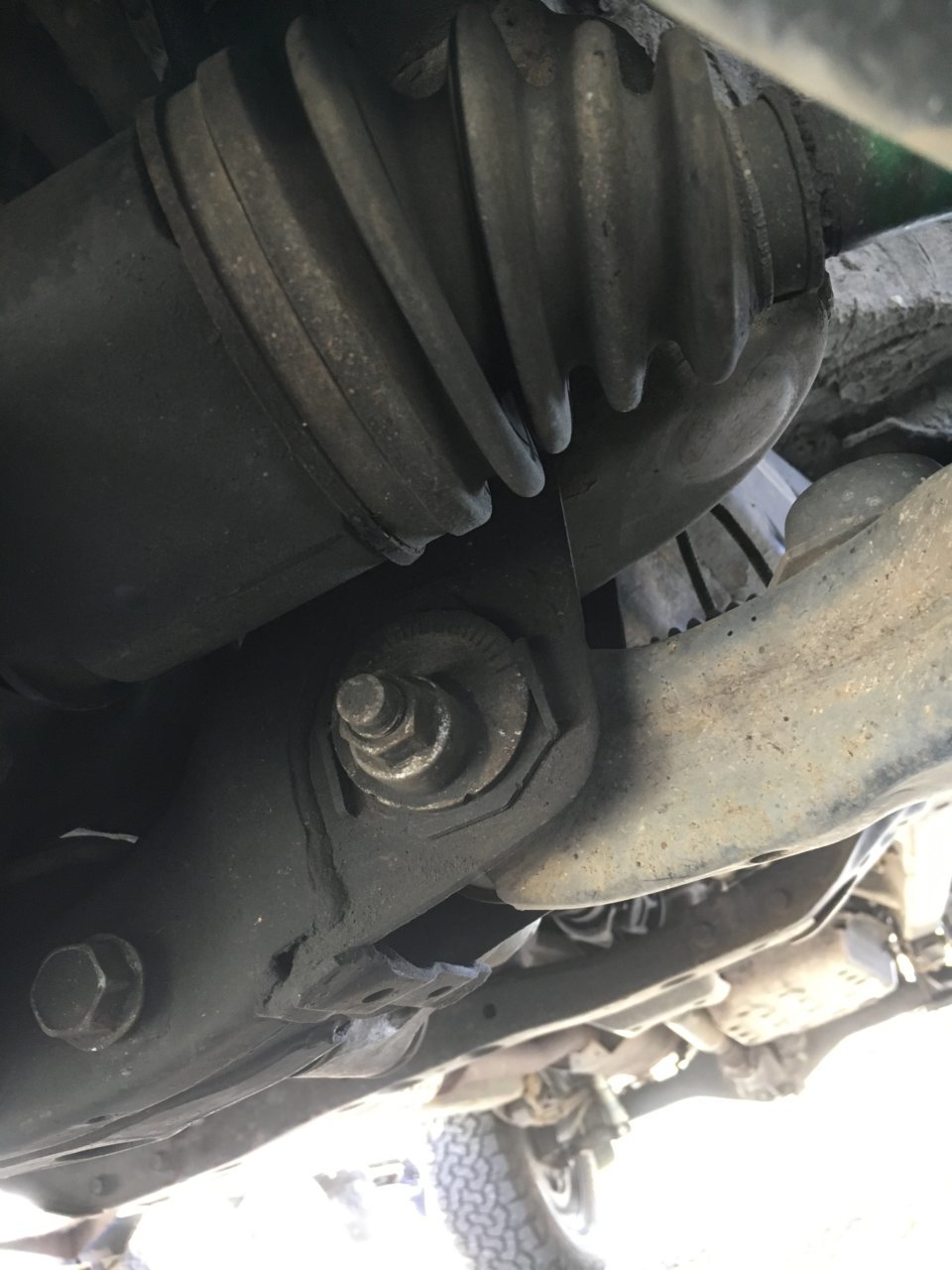

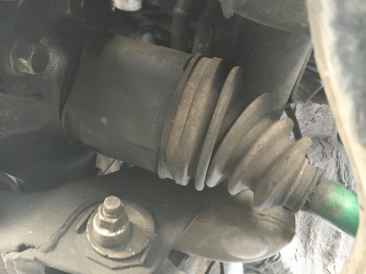

    So while messing with my front diff fluid change I decided to take my front diff drop out and take some pics.
    The top picture is with the diff drop I made removed and bolted back into factory position. The bottom is with the drop in. You can see in the top pic the middle fins are hitting pretty hard and on the bottom they have about a 1/8” gap in between them. Yeah it doesn’t change it much but I’d say it at least drops the cvs down about 3/8”, just enough to make the fins not rub.

    I have Bilstien 5100s on the middle setting and 08 FJ coils which results in about 2 1/2”-2 3/4” lift
