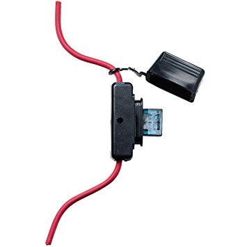

    Gotta connect my AFR gauge wire to a "10-18 volt power source utilizing a 10-A fuse"...
    ....can someone explain this to a wiring noob? Got my gauge all set up except for this part.

    That just says "connect to the battery (12v is between 10-18v) and make sure to use a 10A fuse on that wire that goes to the battery." I assume there are several other connections as well - for ground, to the AFR sensor, etc.

    @turbodb there is a ground wire, that part I understand I just didn't know if it was referring to the battery with the other part.
    So the part I'm a little unclear on still is the 10A fuse...do I run this wire straight to the battery terminal (and the other wire to the ground)? Where does the fuse come into play?

    Yes, straight to the battery, and put the fuse in the wire to the battery.
    Edit: you could also run to a bussman box, or some other 12v power source as well (as long as it can handle 10A).

    Yeah, if it doesn't want switched power then just run a fused 14ga wire from the battery positive, it is for the heater circuit on the new AFR sensor.
