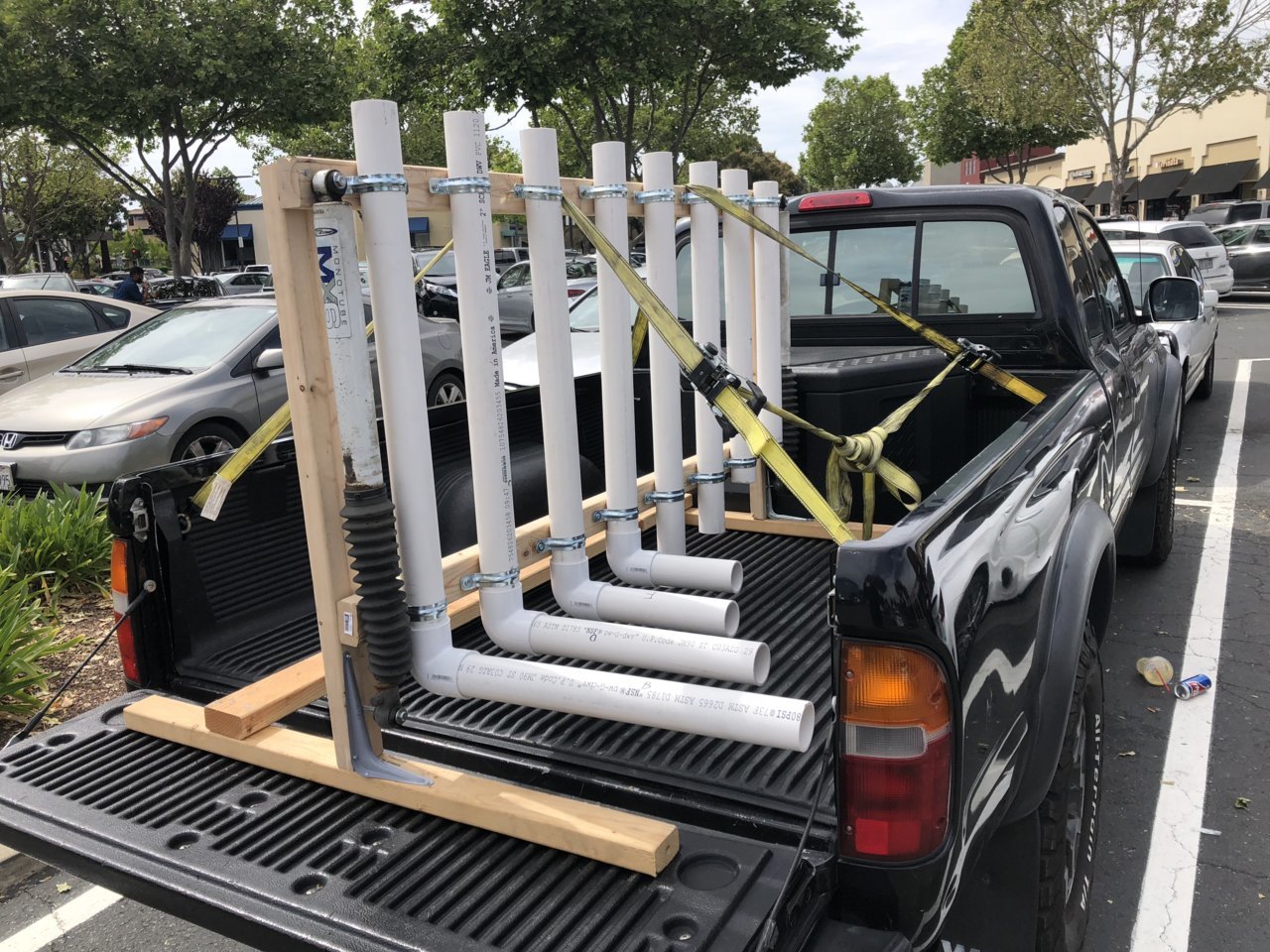

    Its the company truck
    Judging by those shocks its gunna be your new rear LT set up
