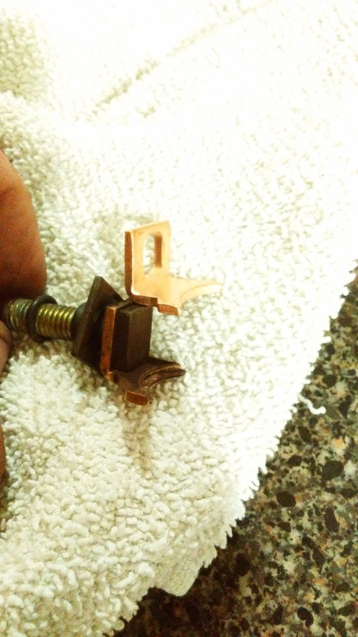

    Rebuilt my starter today. The contacts where showing slight signs of wear
