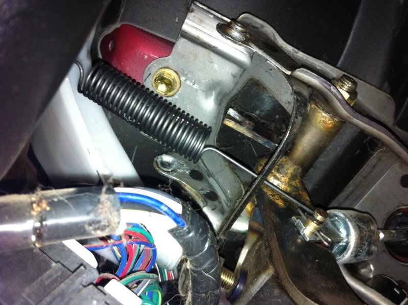

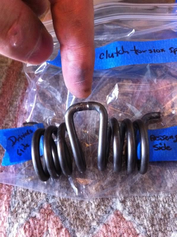

    Did the "clutch pedal squeak" mod (thanks trmarshall1 for the brake pedal return spring!)
    I actually took the bottom portion of the dash off (I mean, it's four bolts and a screw) because I'm not a contortionist and I had a hard time getting leverage on the torsion spring.
    I also only have a large crowbar... that didn't fit under there, so I was using the largest flathead screwdriver I have for the prying. I had a slight bitch of a time getting that middle part (2nd pic) out of the groove on the pedal. I'm going to go back out there and just bend the one end of the spring around the head near the cotter pin, for peace of mind.
    But all in all, it took me less than 10 minutes. Took Ol' Red for a test drive and I love the feel of the pedal now. Just slightly tighter feel than original. Plus it returns to the utmost position which is nice for the cruise control switch. (I'm just going to have to get used to not sticking my foot behind the pedal now :) )
    Oh... and most importantly. NO MORE SQUEAK!!!

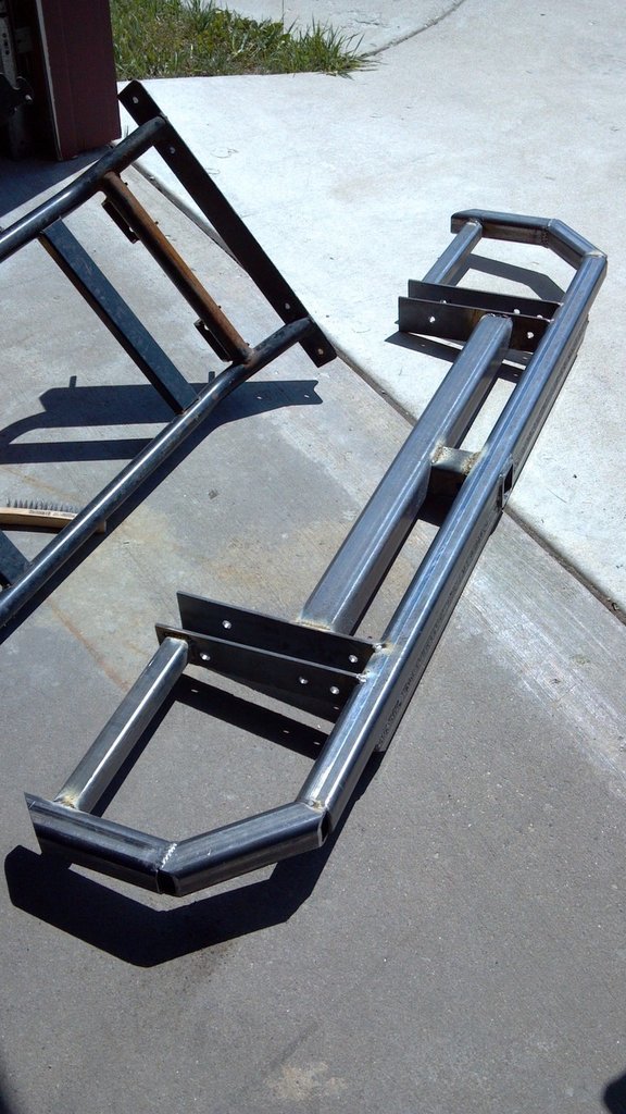

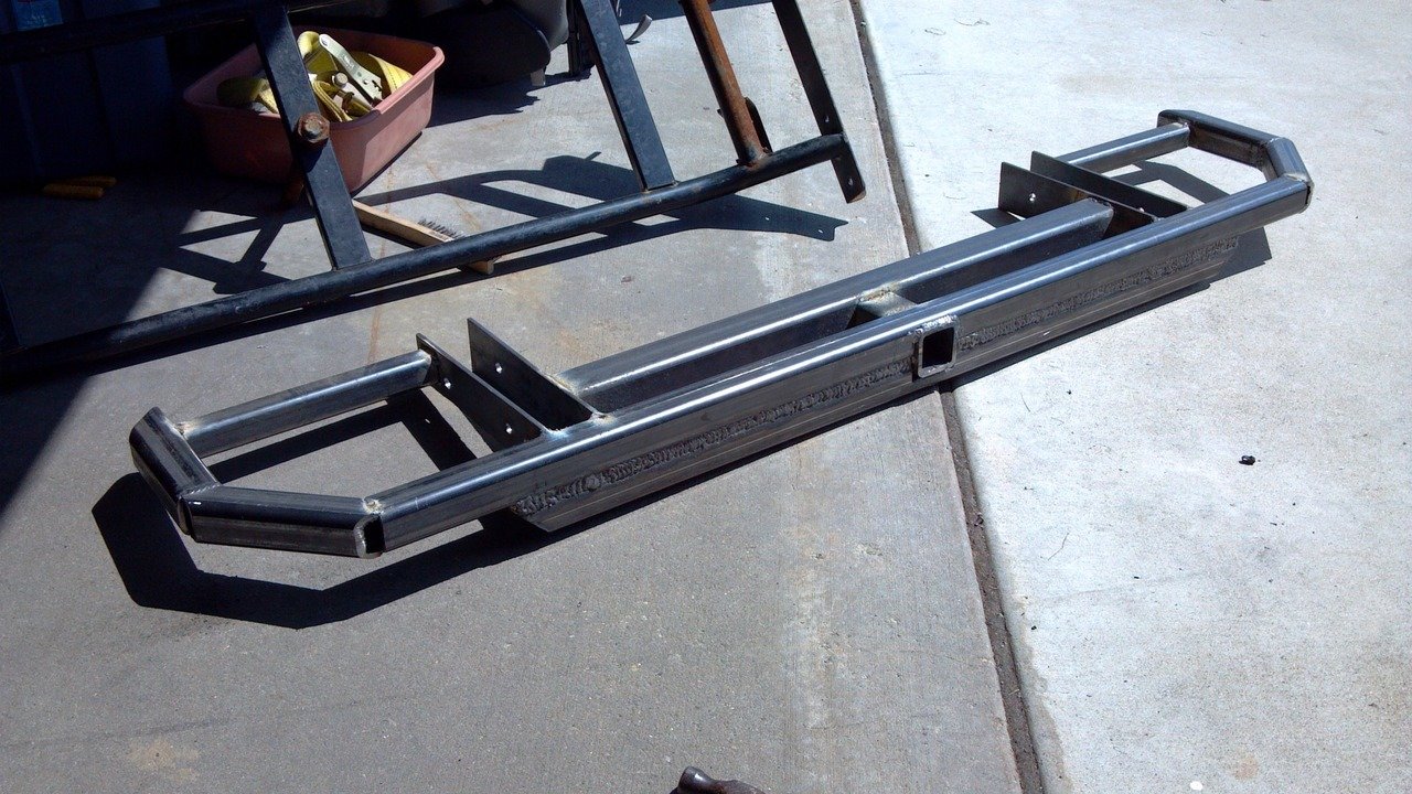

    Almost done with my bumper! :woot:

    Honestly, that's the only tube bumper I've ever liked the looks off.
    Well done, man.

    damn...looks beefy. You going to cap the holes?

    Yeah, holes will be capped. Damned thing weighs about 98lbs!

    holy sheet!
    How much did the TG bumper weigh?

    add 2 more lbs for the shackle mounts itll be a three figure fatty:D
