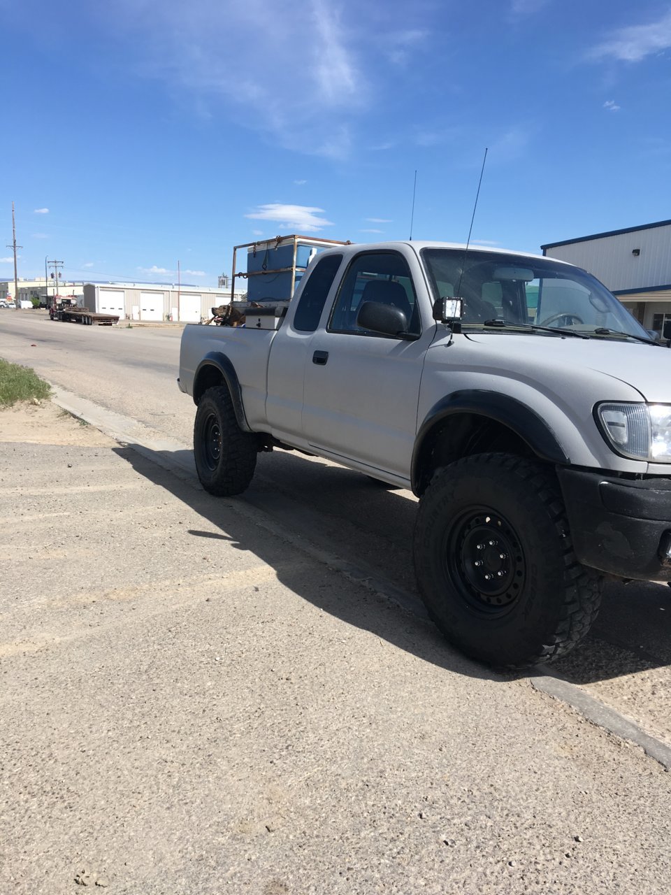

    115F03E9-A2EB-4285-9B59-C33DE3636E32.jpg See you betchs in June
