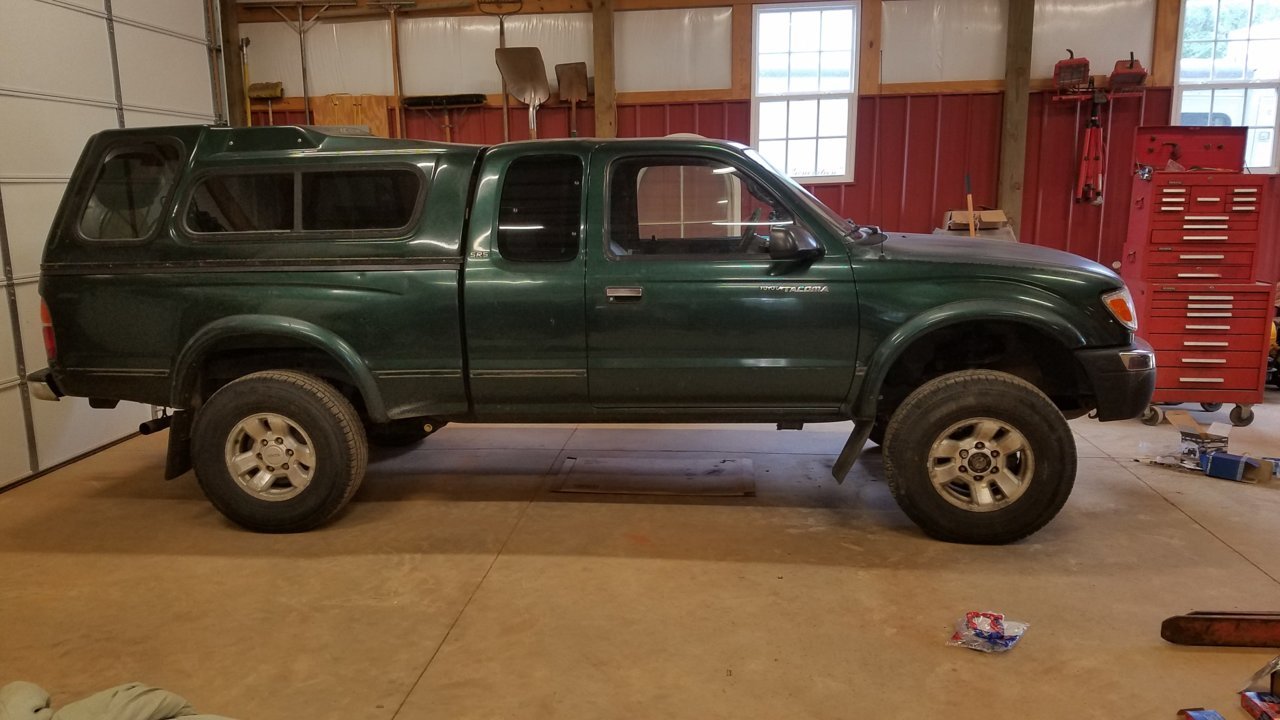

    Uuuummmmmm What happened here???? Do I have to readjust the new shackles or something???20180511_180618.jpg

    Gonna have to wait a wee bit for your front to settle, drive it a bit and get your alignment done. The rear won't get taller but the front should come down a bit.

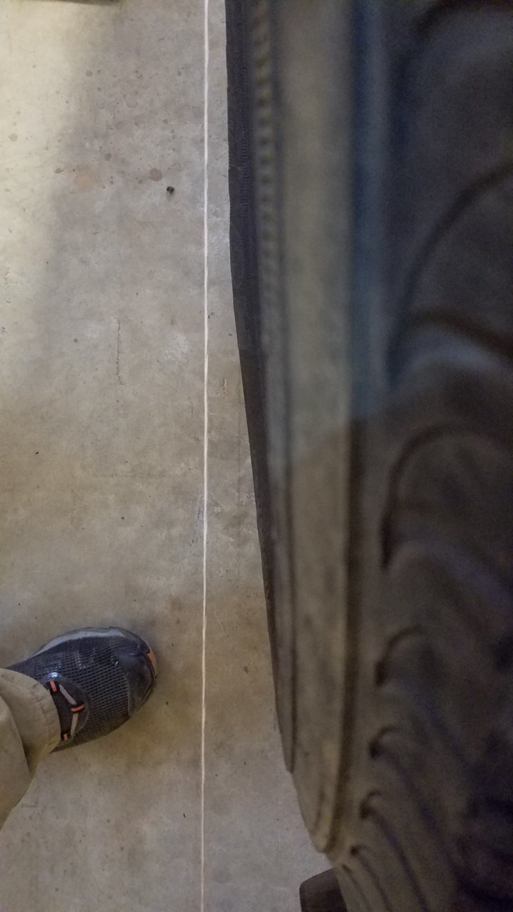

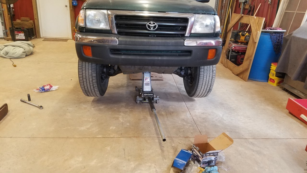

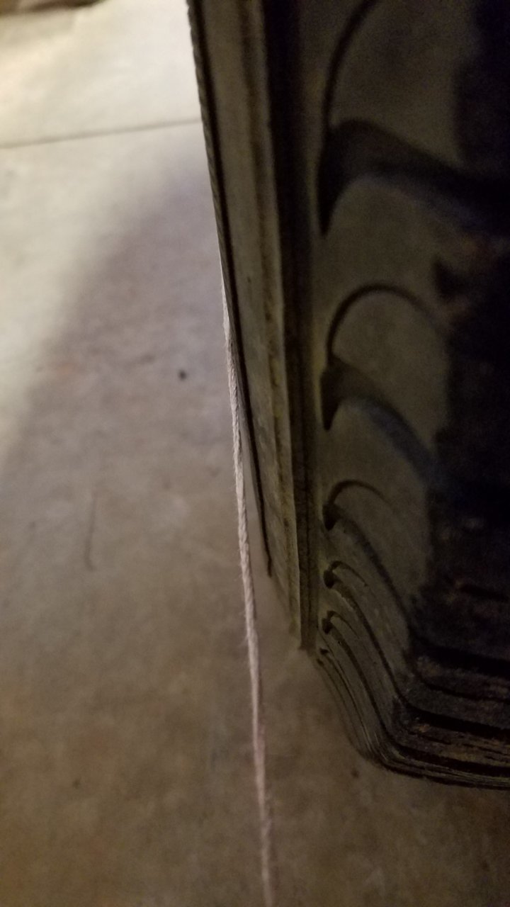

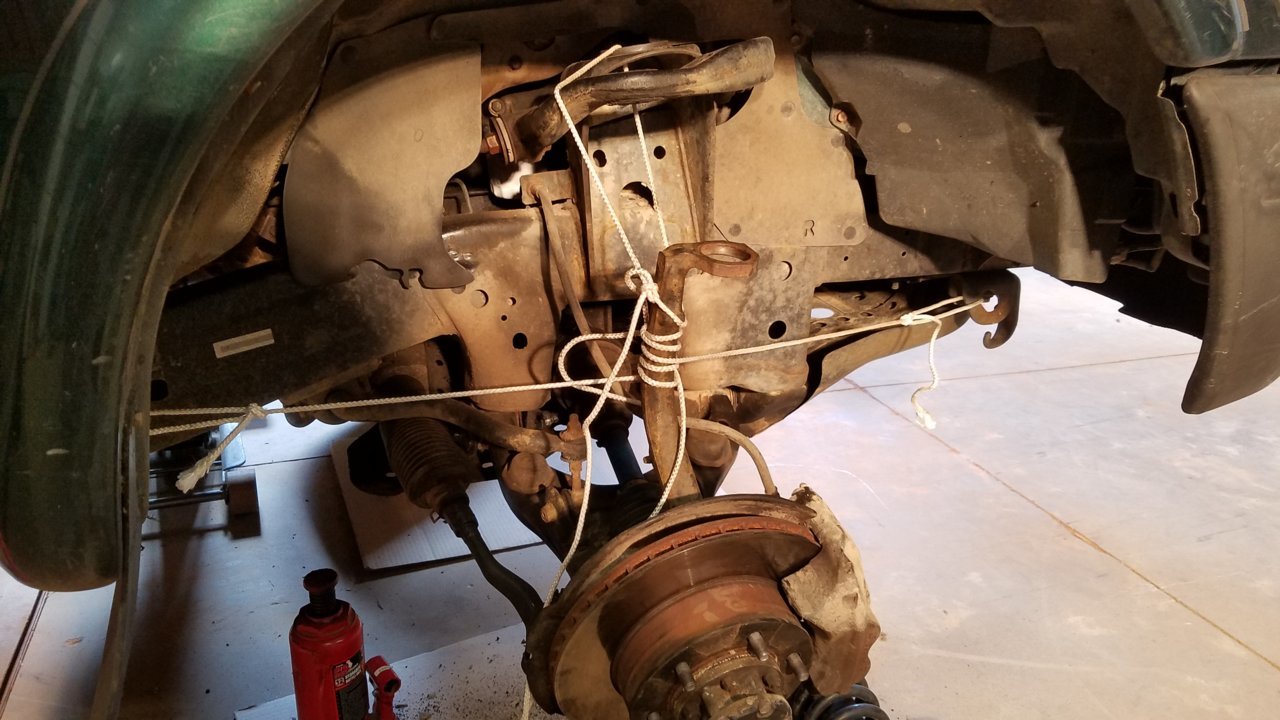

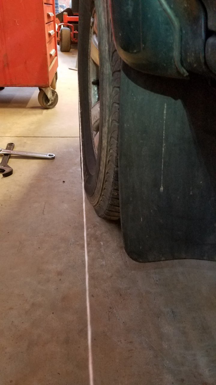

    So, the new ball joints settled as I "slipped" my way down the gravel driveway due to how terribly I re-aligned my tie rods post install.
    While trying to think of a solution to get the truck aligned well enough to make the 50 mile drive home (I won't be able to get an alignment until Monday) we came up with the solution of stringing up a line mid hub from the back of the truck, around to the front. Has anybody ever thought of this before? It might be write up worthy if no one has ever thought of it before.
    Before -
    After -
    I mean, I'm sure it's not perfectly aligned, but I'm not sure you could get any closer without actually getting an alignment lol. Although I haven't driven yet. I'll have to let you know!

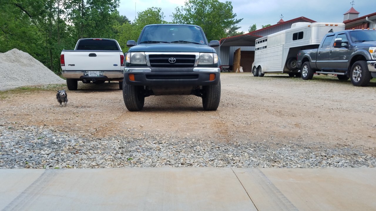

    And the truck is damn near perfectly level now after it settled.

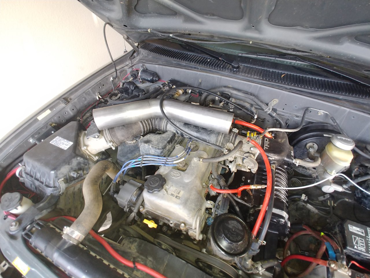

    Got my Lo-Tek pod, haven't drilled and screwed it in tho. Not sure why they color matched the roof and not the plastic trim but whatever looks fine for a wheeling rig.
    Also got some piping for a more direct intake
