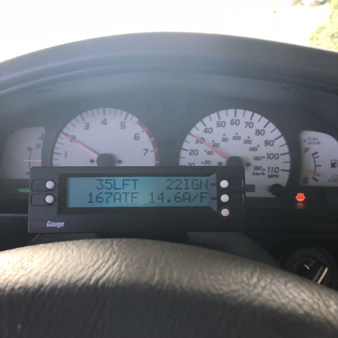

    Like he said, I already have the 7th. I’ve added fuel, taken away fuel and the trims/afr stay the same. Will throw the 0171 code bout once a week and the LFT will bounce around quite a bit. Likes to settle at 19.
    Here’s what it was jumping to on the highway today. No sign of a vacuum leak anywhere whatsoever.

    It ain't right I tell ya, theres a leak somewhere or you got some fuel delivery issues.

    I’ve now put three cans of carb cleaner and a can of starter fluid on every possible place air could come in that’s not the intake. Absolutely nothing. I’m 99.9% certain it’s injectors with that kind of LFT. It would have to be a massive leak otherwise and would leak boost as well right?

    unplug the URD piggy back and see what happens.

    What about the connections that it intercepts?
    Edit. Stupid question.

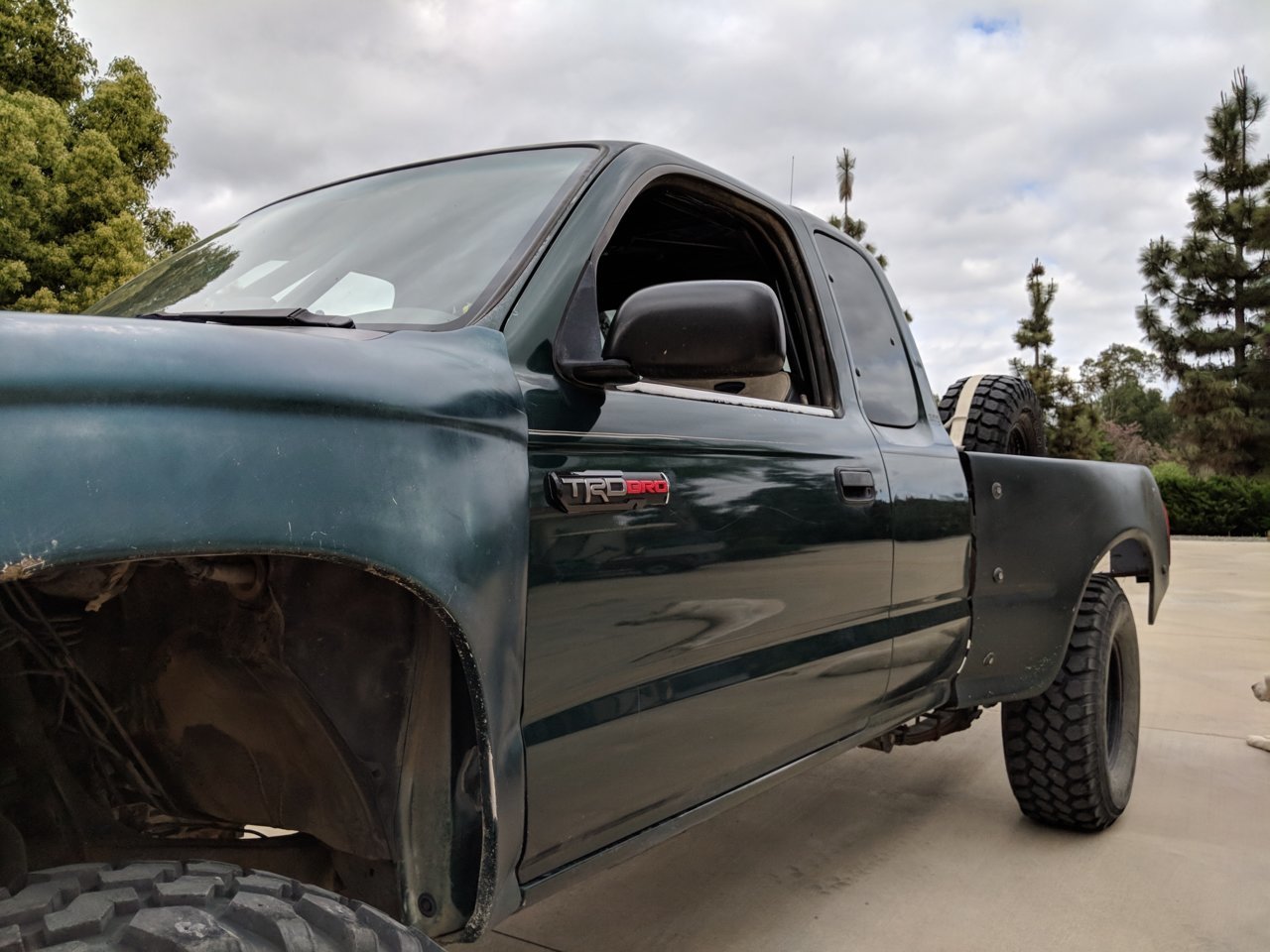

    Front end is now all buckled up . 32A5C4FE-E39C-4004-BED0-75447B15C52F.jpg17C5420C-DE17-4DA9-8374-88C7E305B9C4.jpg1AF0CF6F-43B3-4CBE-8D8F-EF97911EAC38.jpg

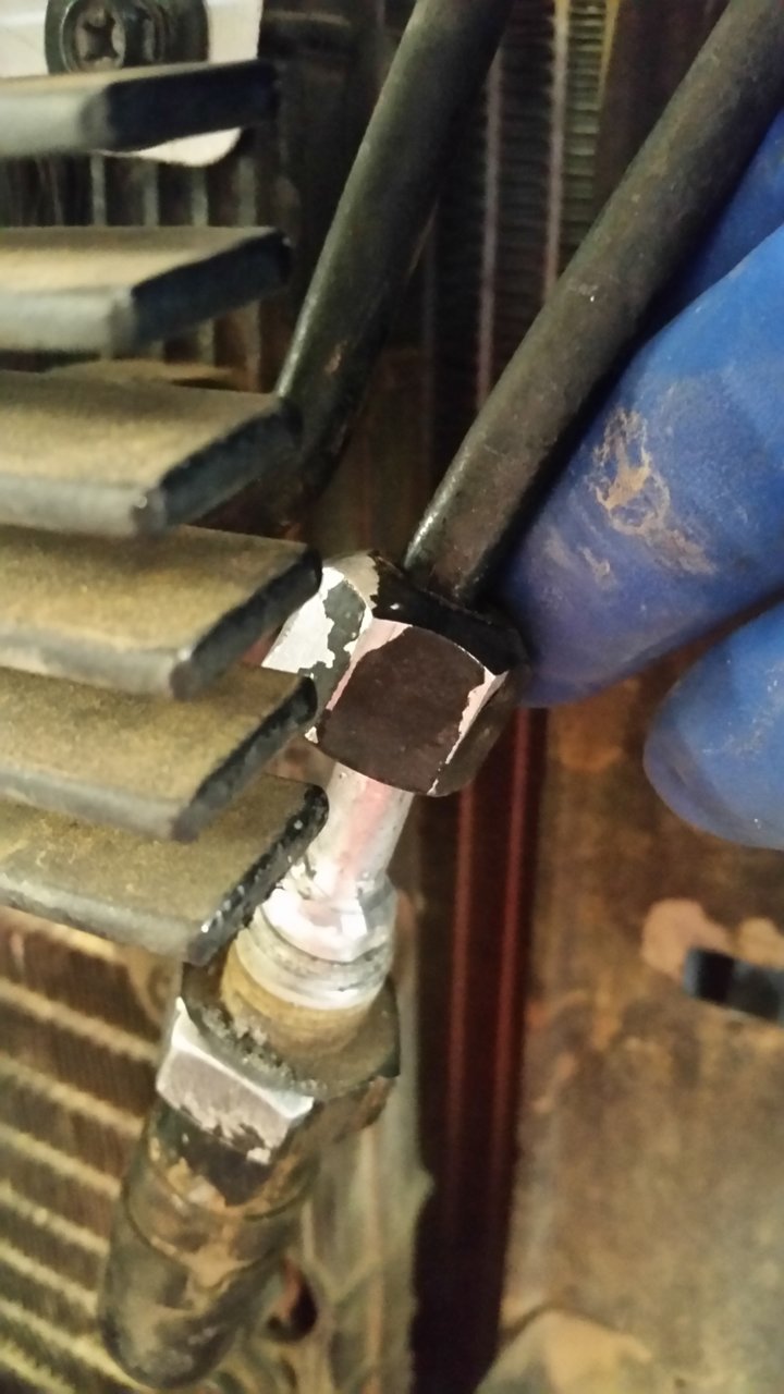

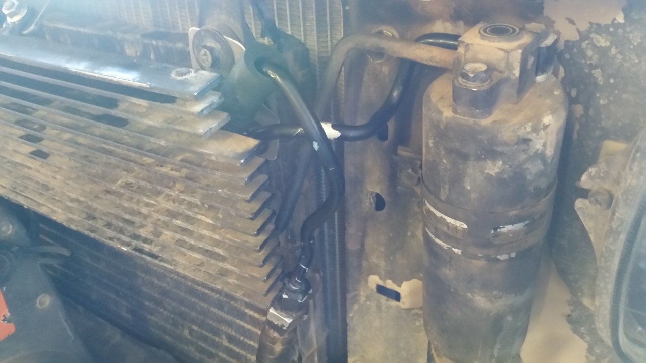

    That new AC line is the updated part to replace that straight line. The straight line would vibrate so much that it would break just like yours did. The new line with all the bends has a little give to it and less likely to break with all the vibration. I get a lot of customers saying that I sold them the wrong line until they realize it is a fix Toyota did.
