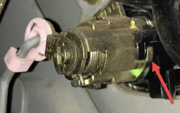

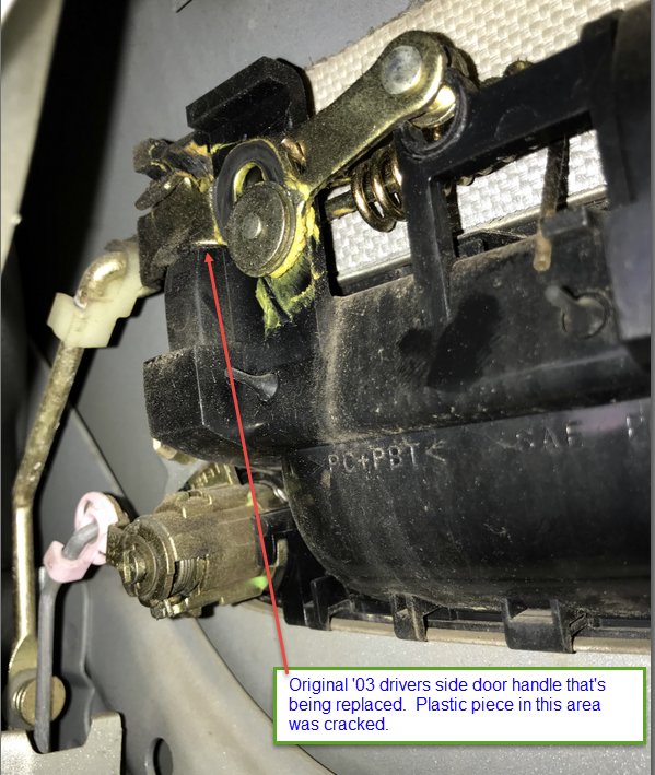

    Replaced my drivers side door handle. I noticed the door handle (outside only) was not springing back into position which within a matter of weeks became progressively worse. If I locked the truck, I would have to manually grab the drivers side knob and lift to unlock.
    After reading on this forum all the bad reviews on the aftermarket ones, I paid about $74 for an oem replacement (Part #69220-35020).
    If you ever do this, it's a great time (if you have power windows) to grease the window tracks and regulator assembly. The window would "chatter" some when going down, and now it's smooth as butter.

    I had the same experience as you except I replaced mine with 3 OEM handles and each one kept breaking. Finally ordered a Dorman brand one and it's been perfect ever since...I was breaking OEM ones every couple of weeks because that little black lip above the arrow in your picture wouldn't press down on the metal lever. The Dorman handles have a bigger black lip on them.
    Might just be something fucked up inside my door with the rods but the Dorman one works best for me.
    You have my sympathy though...I never want to see the inside of a Tacoma door ever again. Got so sick of having to take mine apart lol.

    3 OEM handles! That's expensive! Well, I'm hoping to get another 14 years out of this replacement.

    yeah it was awful. That metal latch inside the handle kept bending out of place so the black plastic lip wouldn't press it down...happened with each OEM handle I bought. Luckily I got 2 of them from Amazon when they were on sale, but one of them I bought from the local dealer for $150 thinking that maybe something was wrong with the Amazon ones, but that one lasted me maybe 2 weeks. I was pissed. The Dorman one I got for $15 and put in last time has lasted a couple months now.

    The hardest part for me was getting the lock assembly lined up in the door handle groove while positioning the handle in the door. The inside of my forearms look like a bob cat used them as a scratching post!

    For me, the hardest time was the first time I attempted to take the handle apart because I didn't have the right kind of wrench to get inside that tight space...took me nearly 3 hours with a normal wrench trying to find the sweet spot to get the 10mm socket on those 2 nuts that hold the handle on.
    Second time it happened I wised up and got a small socket wrench with a swivel head and it made the job 100x easier.
