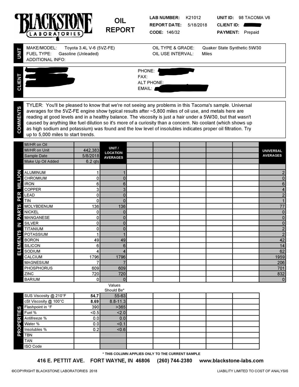

    Oh I plan on being 100% straight up with whoever decides to buy it. These trucks are popular enough around here, I don't think I'll have any problem selling it.
    I do plan on rebuilding the engine. Yeah I know it doesn't need it, but I've always wanted to tear one apart. Would look good to a buyer as well. I was very surprised the Blackstone same came back so positive, I had a feeling there was a head gasket leak somewhere.

    I really want to do one on my corolla.. curious as to what they find with 700k on the engine

    Damn... really? Post some pics.
