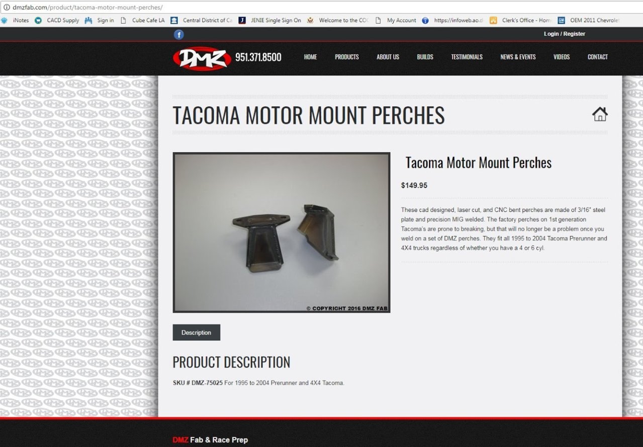

    if you ever do do it again, DMZ makes new perches I think. They are quite beef.

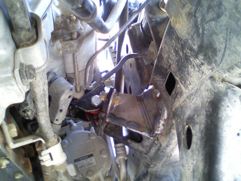

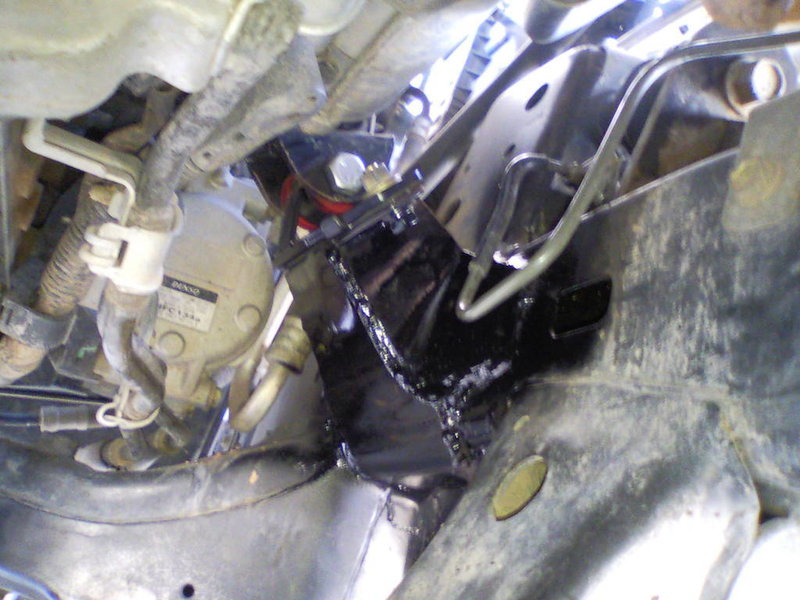

    Its kind of common in the long travel trucks. Mine are plated and boxed with an extra layer on the frame side, the factory frame mount is sandwiched in between the new plate and the motor mount. Some have even beefier than mine and have still torn them apart

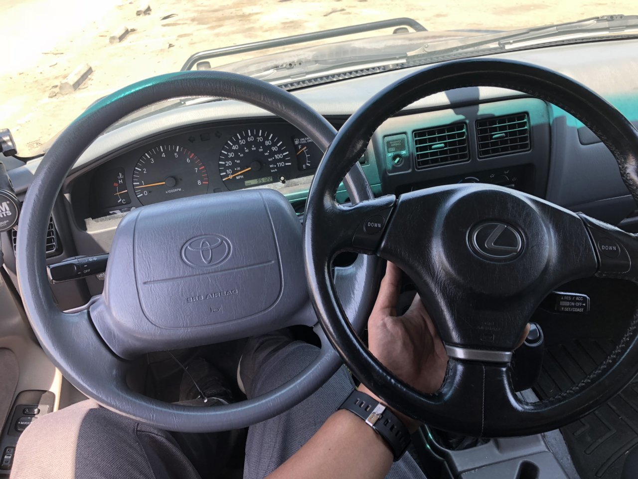

    Will be cruising around in style with my new 2002 Lexus IS300 steering wheel. :rolleyes:
    Black to match my 4Runner shifter console.

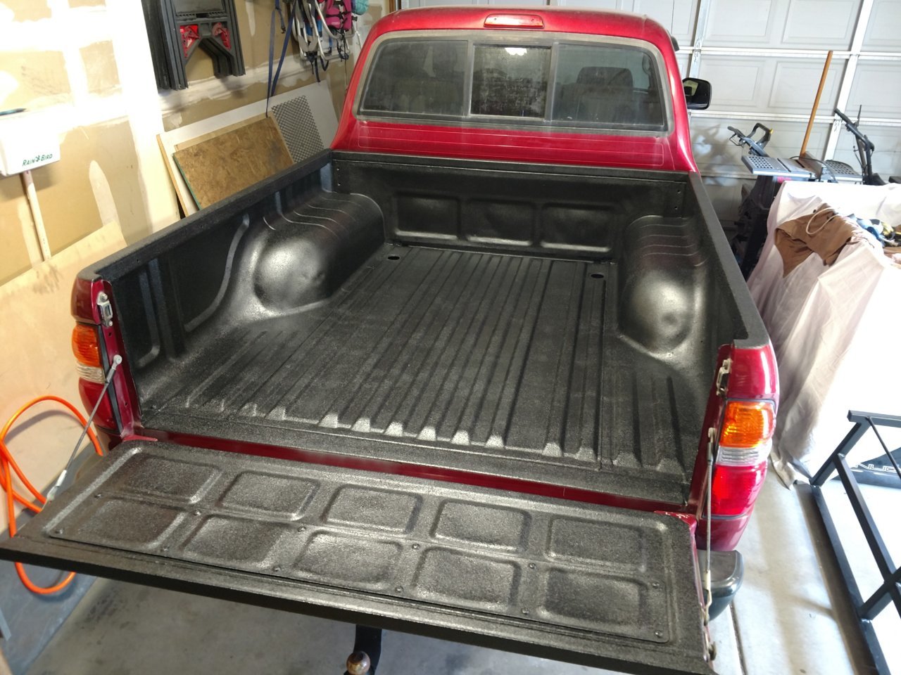

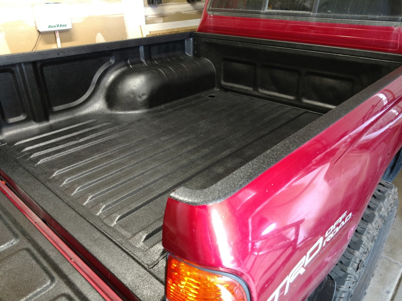

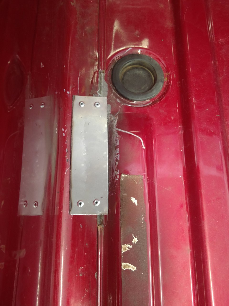

    Wasn't today, but rather this weekend. Bed lined the truck with Raptor Liner.
    Only had one rust repair to make. Used some rivets to put in the patch as I didn't feel it was necessary to break out the welder for such a small hole.

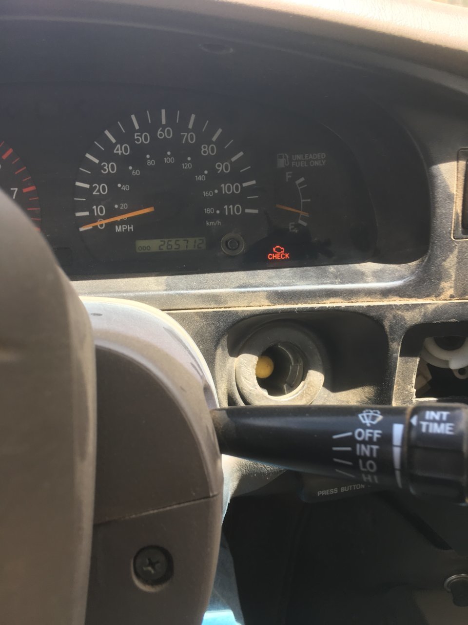

    Well this is neat... I feel like it has to do with a dirty MAF....

    Where have you been.
    It just showed up this morning, still runs fine, being 80 miles from town I’m just gonna send it...

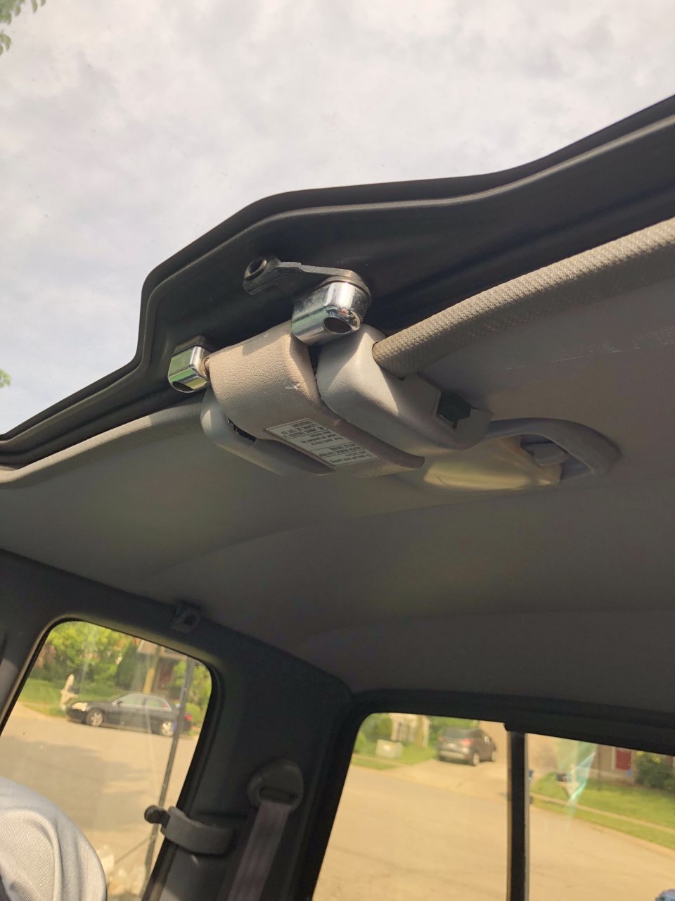

    And then when I got into my neighborhood the truck developed the most annoying metal on metal rattle. Took me awhile to find but the months of leaving the sunroof popped finally took its toll and loosed the bolts for the latch, tightened em up and she seems good to go!68D359FE-2B8E-40F9-8434-2579248852D6.jpg

    Apr 1, 2016
    #183054
    9,116
    Has that truck always been in Utah? Toyota really fucked the dog when it came to the seam sealer on the bed floor seams. It's rusting from under because they relied on the shultz coating to act as a seam sealer and the seam is right at the edge of the wheel well
