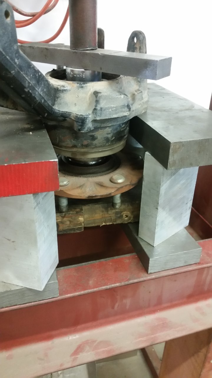

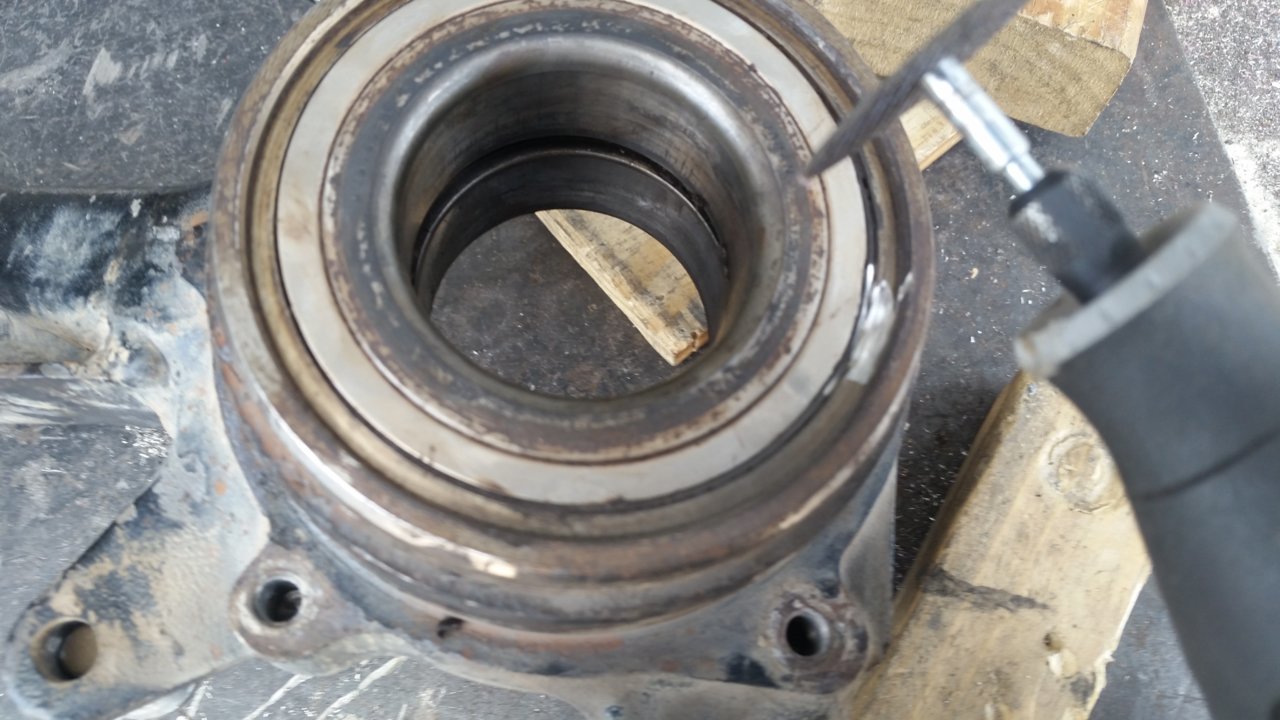

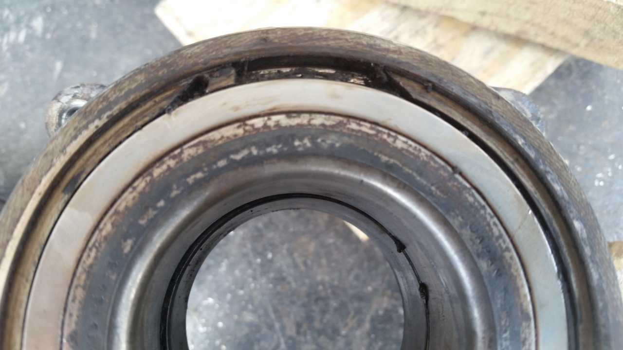

    Pressed the hub out no problem, but snap ring was stuck so I tapped it with a hammer and the lip broke off. Lame. Dremel cut 1/3 to weaken, then pryed out. Off to Toyota for another. 20180526_111930.jpg 20180526_114131.jpg 20180526_114152.jpg
