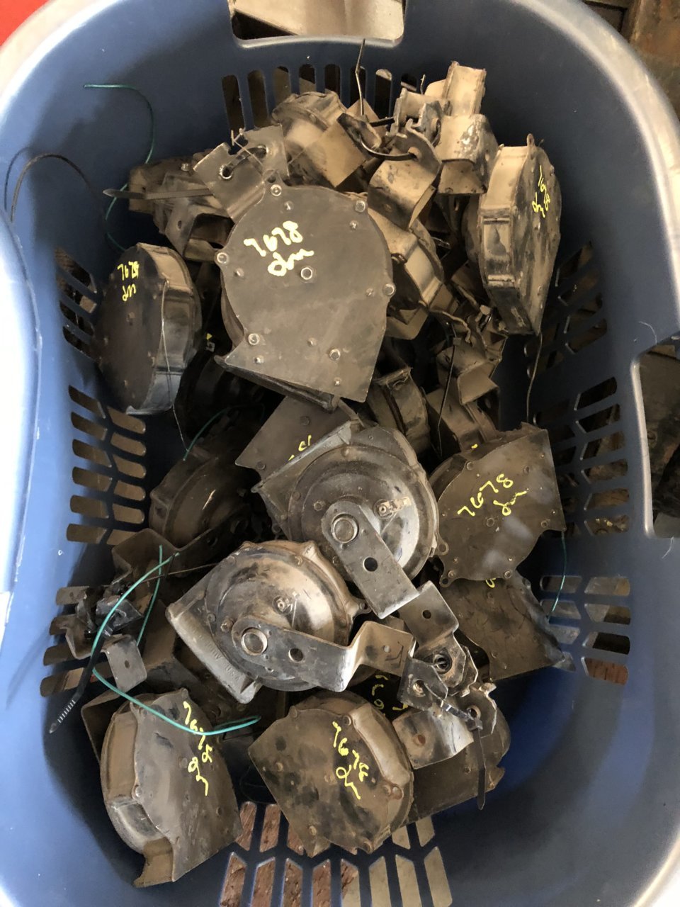

    I robbed the Bay Area of every Cadillac horn I could find. Still don’t have enough.

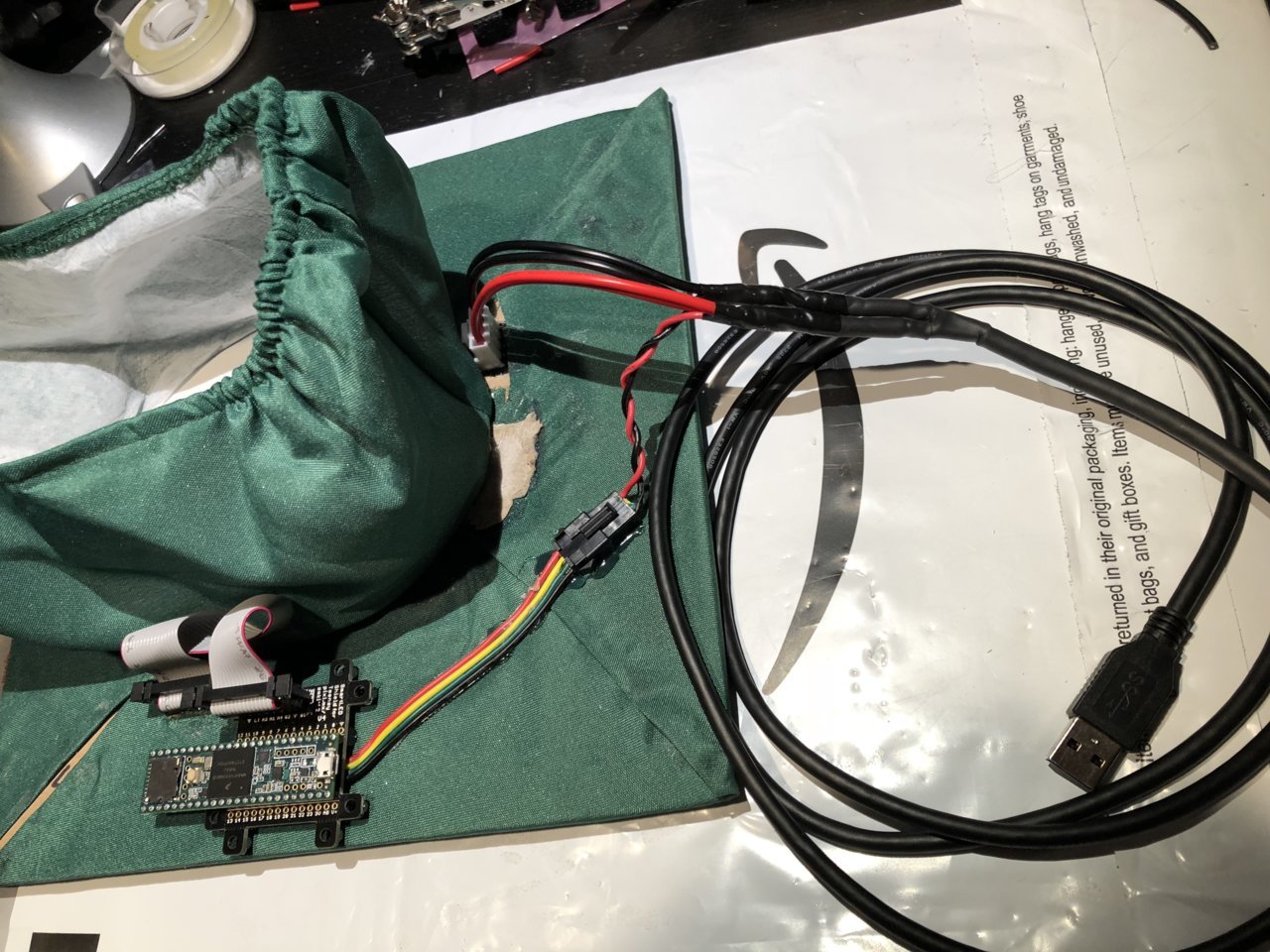

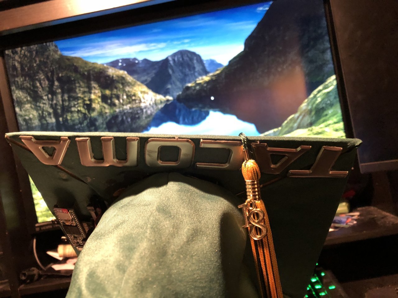

    Oh... and you think I could forget about you guys? Haha.

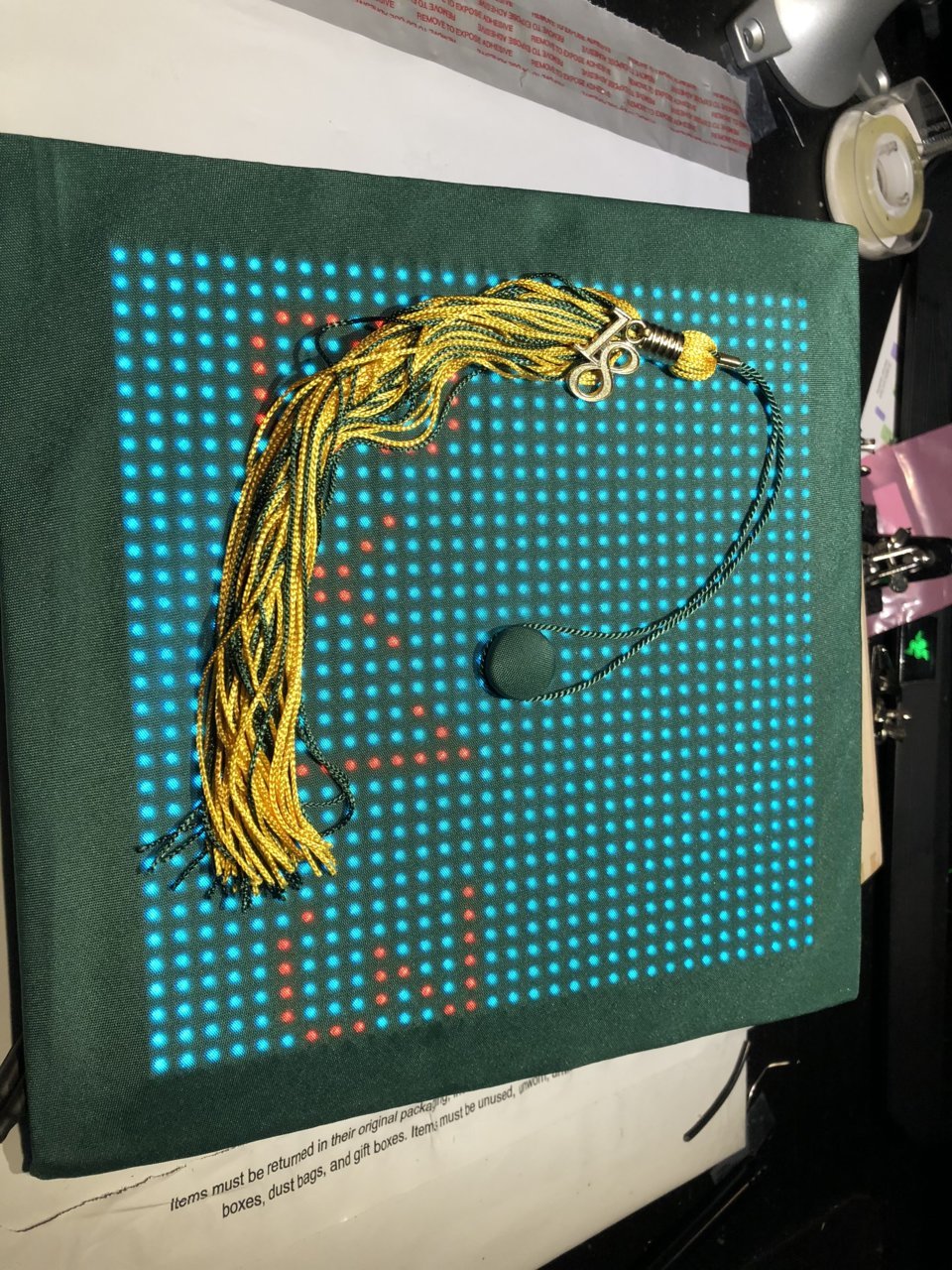

    If you’re asking why there’s a circuit board on it, it’s because I put an LED Matrix on the top of it.
    Remember that episode of Top Gear where they lit the Hilux on fire?
    Interstellar and Die Hard
    B4AE3435-4411-41B2-9879-D7315305A0D9.jpg 4F0E24C8-26CB-45C1-AB65-3C7B286B413A.jpg
    For anyone curious, it’s an Arduino based platform called SmartMatrix Shield v4 and a Teensy microcontroller running a custom program written in C#. I bought the LED matrix panel from a Jumbotron manufacturer. They would have hundreds of these put together in series to form a billboard or digital signage. Runs off of 5v from a battery bank in my back pocket. It plays GIF’s loaded to a micro SD card.

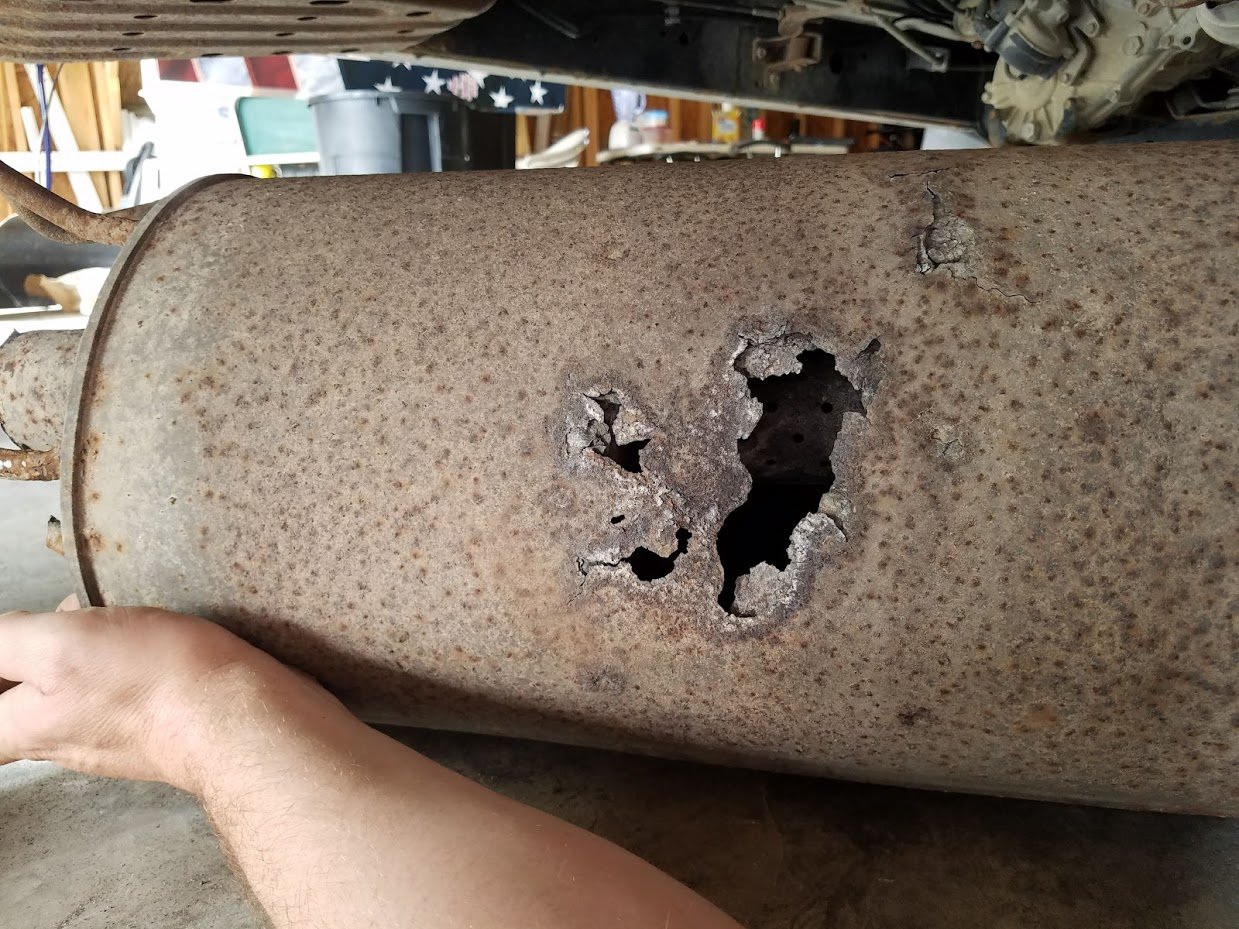

    I replaced the muffler on my '01..
    Old and busted....

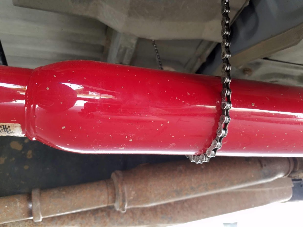

    The new hotness.. complete with custom bike chain hanger.

    Dont mean to be the bear of bad news but the exhaust vibrates a lot and that chain is going to make noise and wear into your new muffler.

    Better off with some 12 or 10 gauge copper electrical wire. Flexible to install, and won't rust, plus you can twist it to get all the slack out. Will last for years!

    A couple soup cans and you wouldn't even need to remove the muffler.

    Attached with stainless steel pop rivets.

    Yeah just a temporary fix. I have a hanger but I need to extend it out to reach the factory point on the truck.
