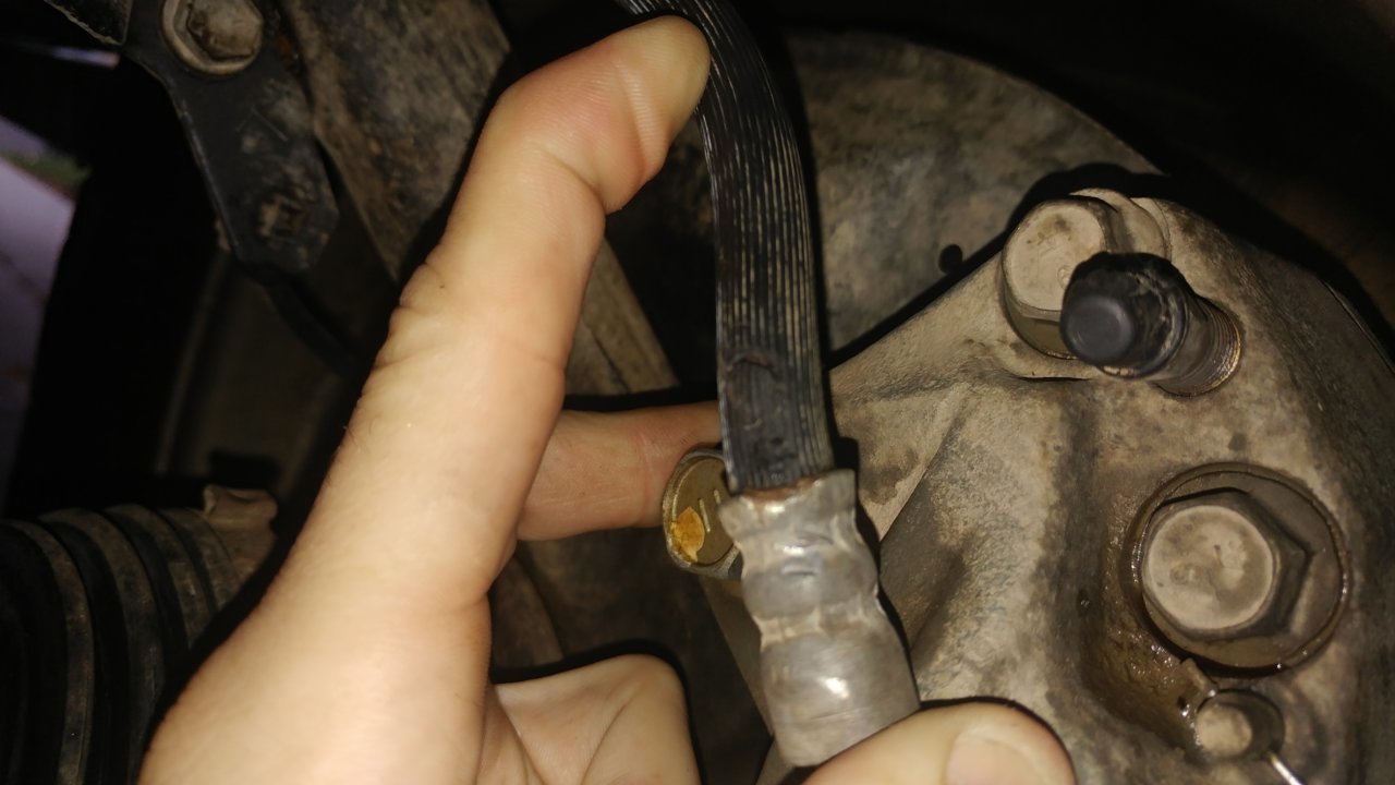

    Possibly, gonna crack a beer and crawl under there with my wrenches and see what's up, hopefully something is just loose enough that it caused a leak.

    Hopefully the crimp on the hose isnt lose and leaking there

    Refill the fluid. Then...Clean it up and shine a light on the hose & caliper checking for hairline cracks. If you don’t find any problems, replace the copper washers. You’ll find them at NAPA/OReillys/Autozone and so on. Find the problem and repair it before driving. The master cylinder is small and drains quickly.
    Good luck and update us!

    Yup, I cleaned it up and saw a split in the hose pretty quick...gonna top off the fluid and head to the auto parts store for a new hose.

    Nice work.
    Let us know how it goes.
