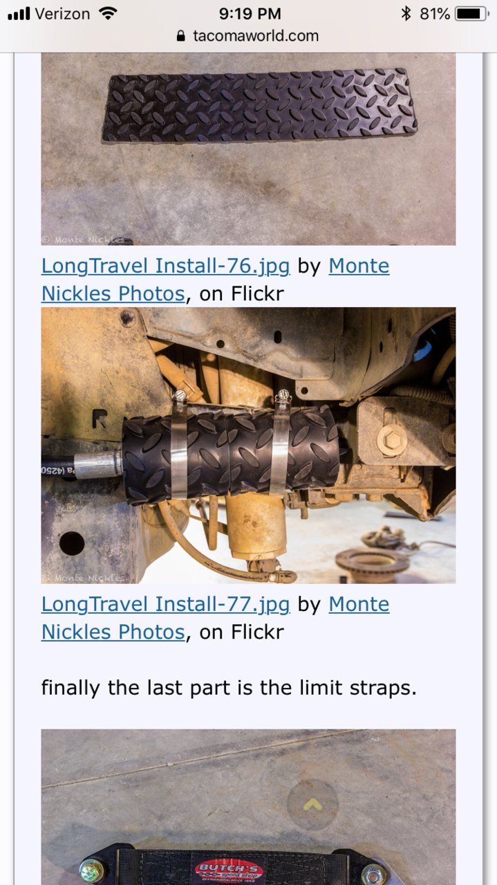

    This is where Monte mounted his, he is LT but bringing it closer to the shock could help push the hose away from your tire. Start looking at builds too man8A21D8E1-A1B2-4734-BDD6-78D7EB306A63.jpg

    @MadTaco461 any suggestions for colton, his 31’s are rubbing bad on his resi hose...colton post a pic

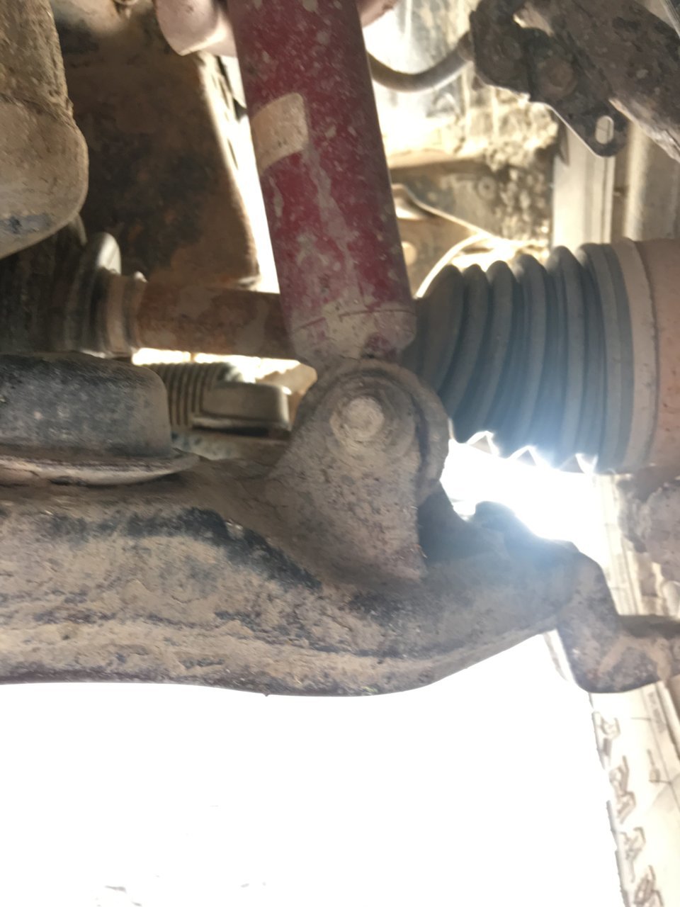

    Would shredded bushing like this cause I big enough change in alignment to wear the inside of my tires?
    Going in for an alignment tomorrow either way but I’m just curious.

    I didnt say wrap it haha he just got new fox coilovers w adjustable resi n it needs a better home. I think cause its so far forward its forcing the hose to be too taught n not hug the frame

    It does seems counterintuiative haha

    He didn't wanna scratch his shiny resis

    I figured that was what he was going for. Not much room in our wheel wells for shit.

    I still think the best place for the resi is on top of the coilover tower, just need to request longer hoses be put on when you order.

    Not on the frame? I guess that takes it completely away from any tire contact.

    A worn lower shock mount bushing will not have any effect on wheel alignment.

    But it like caused the truck to loss 1/4” of lift? I dunno, I need an Alignment anyway, the last month has been hard on ol’ gray.
