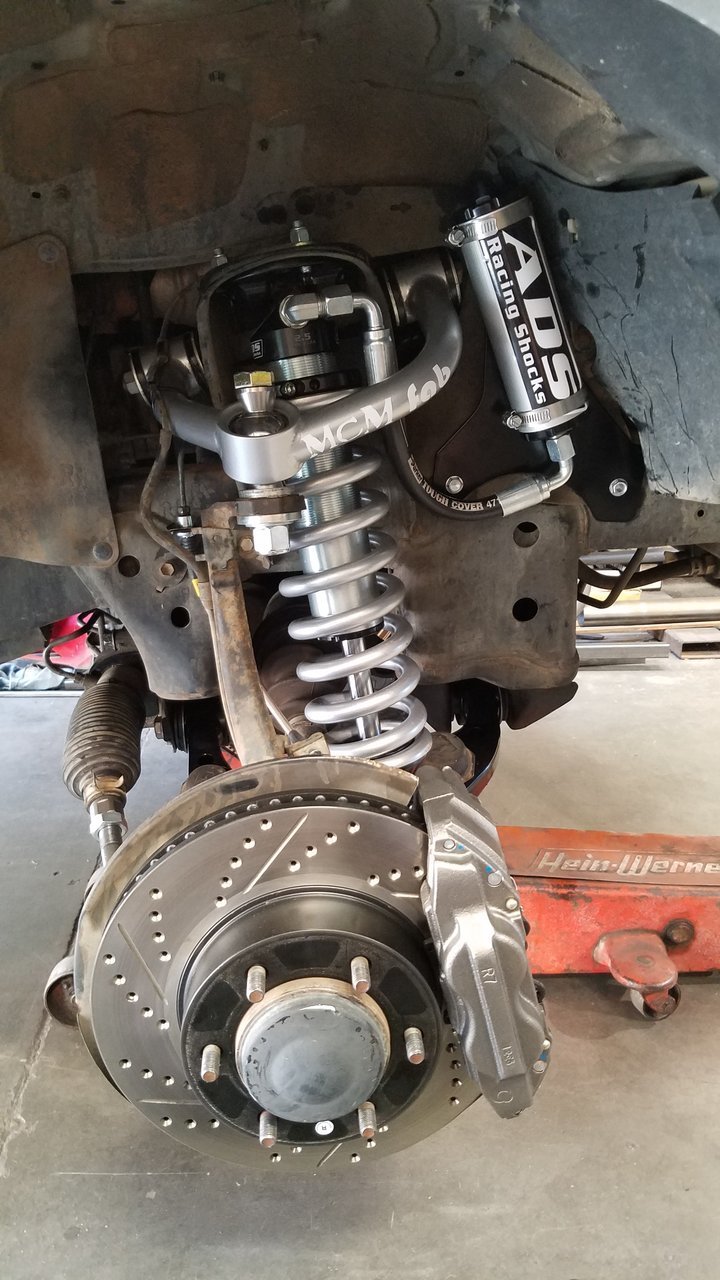

    This is the best resi mount I've seen on a 1st gen:
    By MCM fab.
    Also, resi's don't really help cool. That isn't their main purpose so IDGAF about "wrapping" them. I needed a mount to hold them on the frame. Working just fine. and was easy and cheap.

    Thank you from @Titus94 and for the laughs! It does look pretty dam clean.

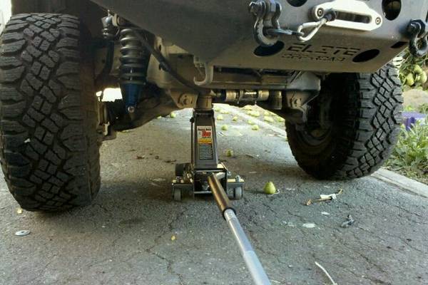

    nice.
    Another cool spot for them is under the skid plate.
    This requires longer hoses though.
