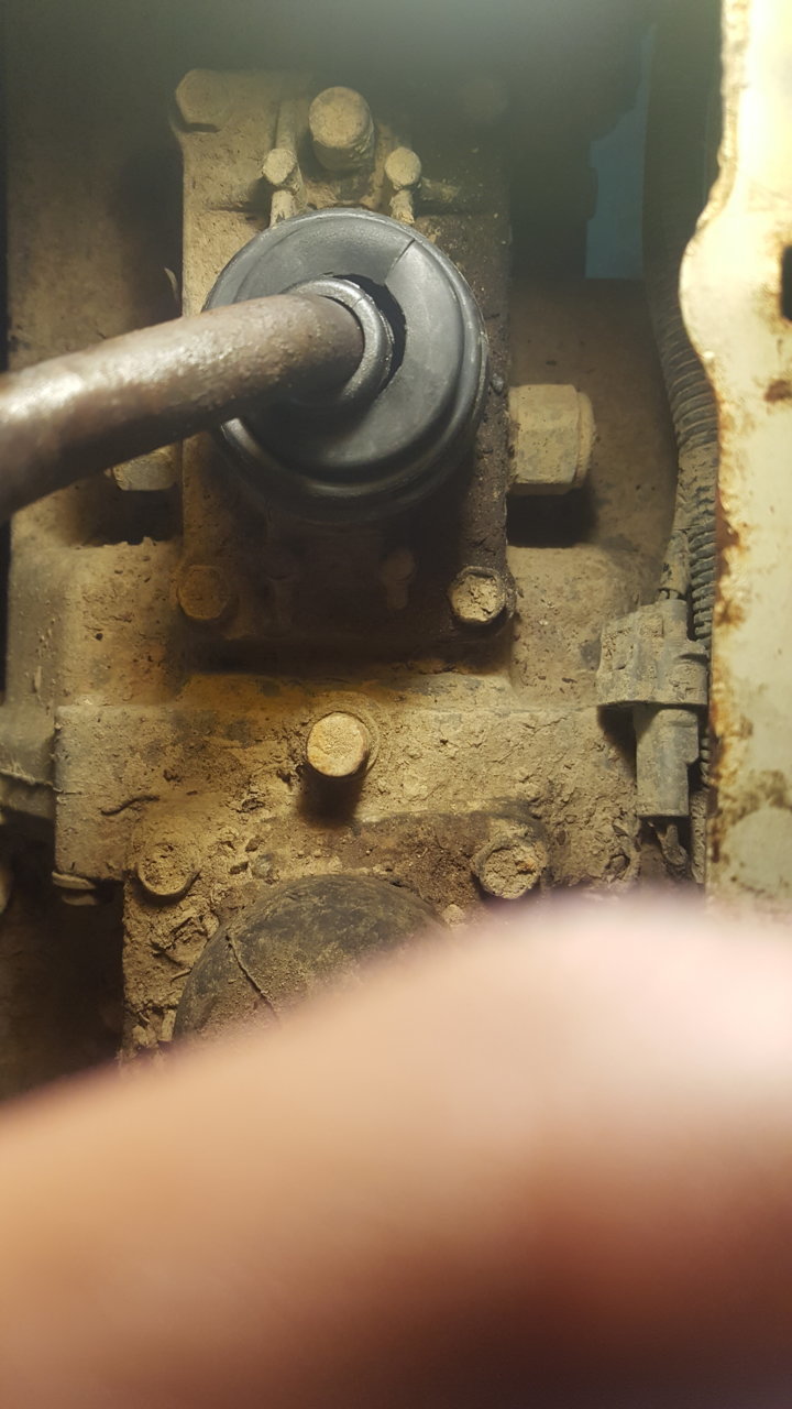

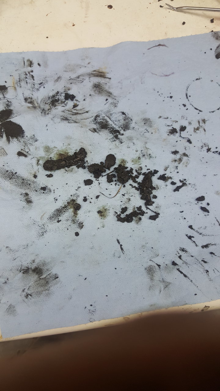

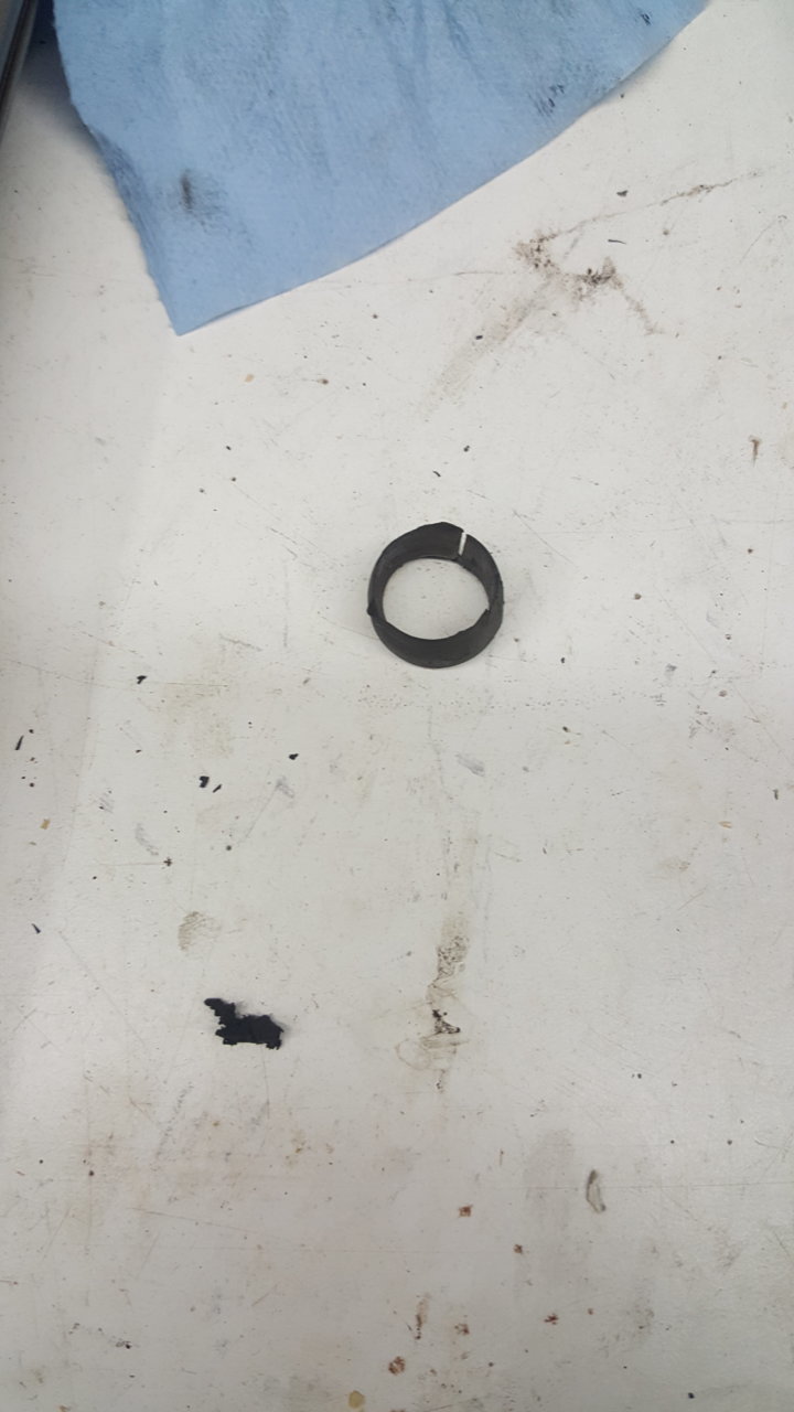

    Finally got around to replacing my shifter seat bushings, needless to say it was much needed. This is what was left of the old bushing. 20180607_184551.jpgNylon bushing was shot too

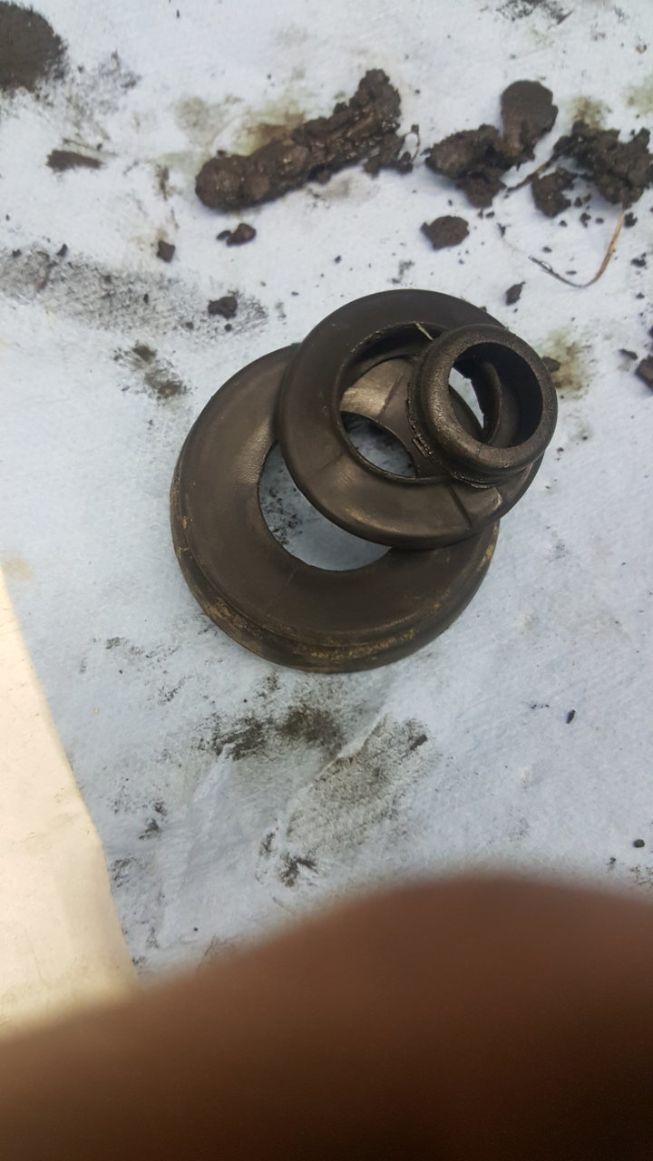

    It's the boot that keeps foreign objects from getting in the trans.
    All in all this cost $28 and should be well worth it. Part numbers 33505-35020 and 33548-31010. It should be a pretty standard part as i believe they use it on many different vehicles. Currently in the middle of front brake pads rotors and a passenger side caliper and waiting on more parts to come in so I can finish. But just sitting in it and running through gears it feels great. Definently recommend doing this if your manual trans feels really sloppy when shifting or if you have a lot of left and right play when in gear. Took about an hour mostly because I had to pick out so many little bushing chunks.

    I replaced all mine with Marlin bushings and it was like night and day. They’re still tight about 6 years later. Can’t say that about everything else getting abused.
