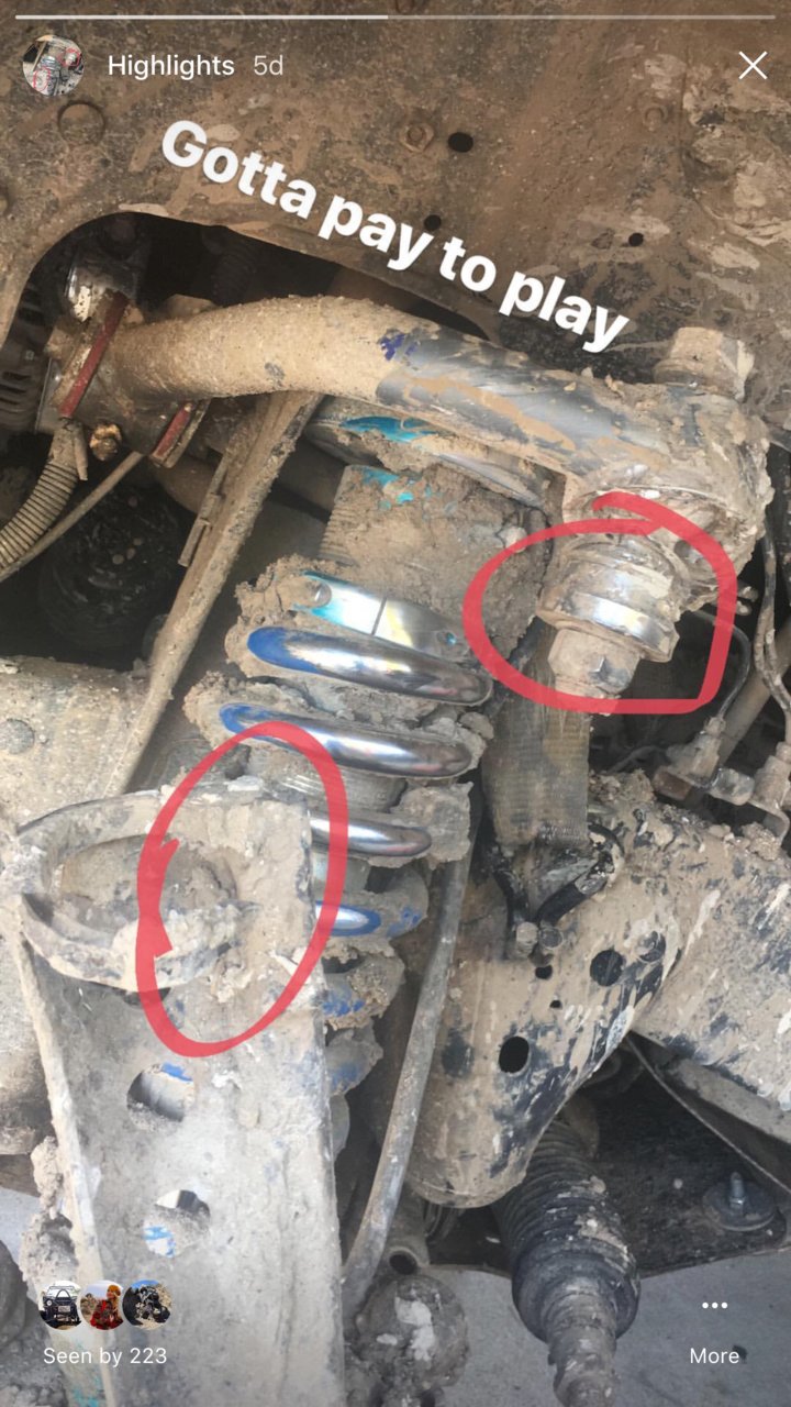

    how are you tighten the bolts? or is it locked in place? What happens if you bend a bolt?

    This is something I really need to get around to doing. I can't believe I haven't tweaked mine yet.
    Is this the common point of failure? I always thought it was bending them.

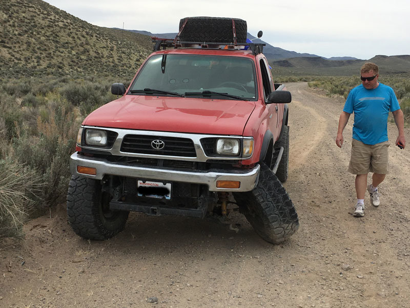

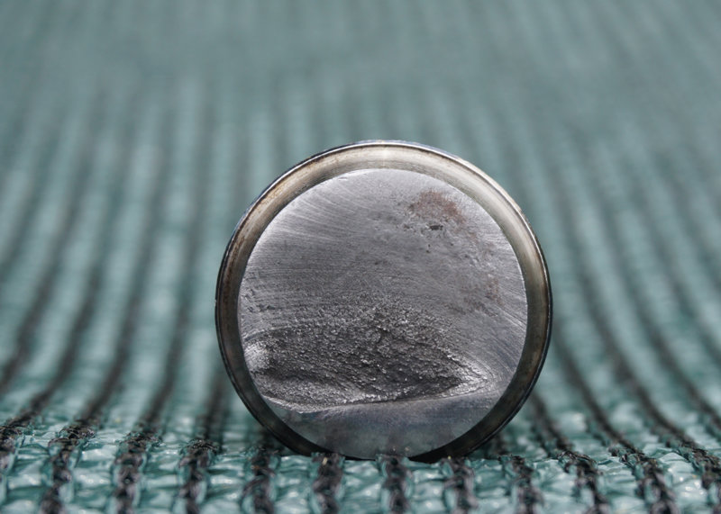

    How do these joints usually fail? I figured the ball worked itself loose and popped out. Mine sheared the shaft. The ball was still up inside. I don't know how failure of the LBJ shaft itself can be predicted except maybe by age or xray, but take a look at this cross section:
    Don't end up like this dude (me)...

    Is the ball sloppy inside causing more stress on the stud?

    Interesting idea. It's a little hard to tell since it sheared flush with the ball so not much to grab on to, but, no, the ball seems pretty firmly stuck in the casting.

    Such as the ball joint geometry is off due to lift?

    Such as having ball joint failure. I've replaced hundreds of these and the trueth is 80% of the time ball joint failure is due to neglectful care of the truck. 15% is lifting it and running tires past it's capacity. And the last 5% is people slamming cheap parts on their lifter over size tire rigs. Guys please stop buying cheap parts. Your ifs suspentisu will live longer even with bigger tires . Or just solid axle swap .
