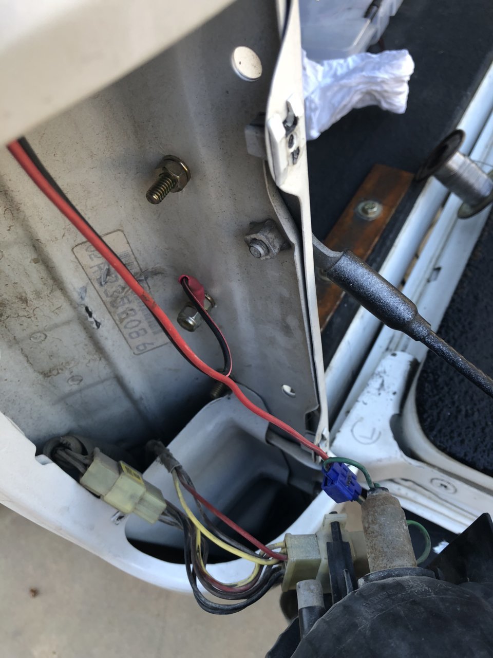

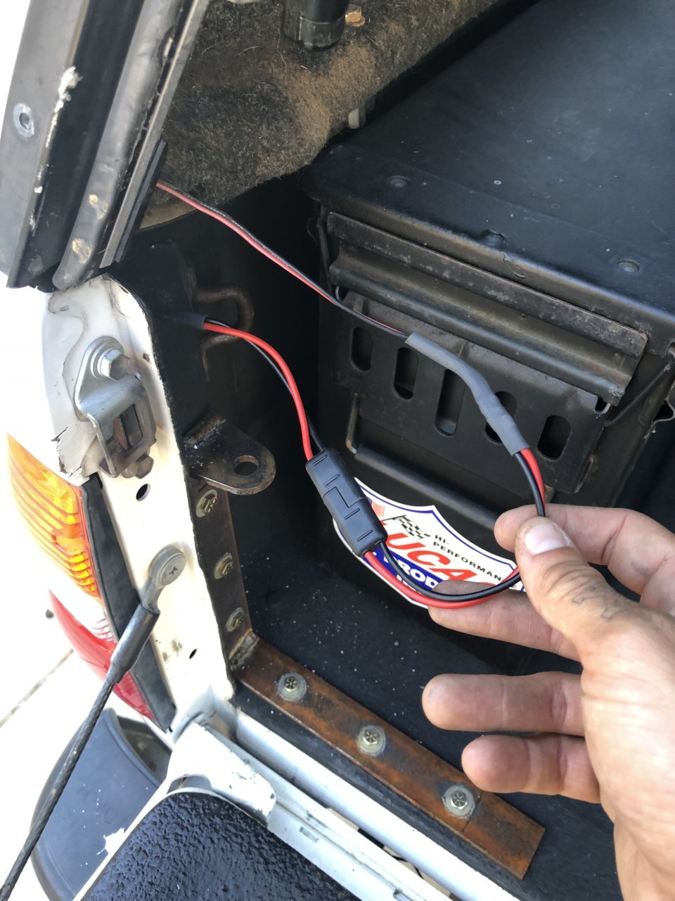

    maybe go back in there and get rid of those scotch locks, find the rest of them and throw them all away. seriously they do nothing but cause problems down the road. heat shrink but connectors aren't that much more money and they work really well.
