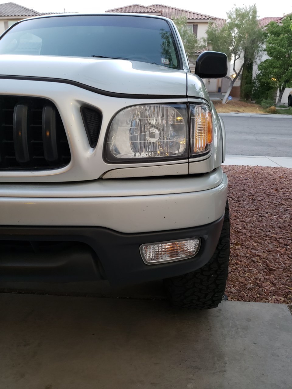

    Replaced my ladies headlights and blinkers.. made it look 4-5 years newer.
