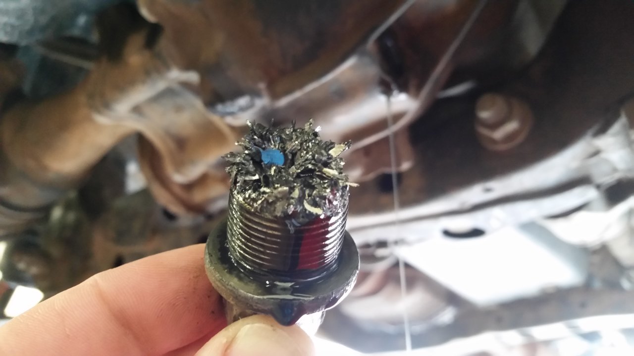

    My front end was making terrible noises going up a semi articulated obstacle Thursday evening. I looked all over for the culprit, but none was to be found. We decided to call it since the way only became longer and worse from here. Going back in the wash seemed fine, no noises or unpleasant symptoms dispite many bumps.
    After a few miles of smooth paved road, it suddenly shook so bad I thought the wheels were coming off! Death wobble? Wtf!
    So I pulled over and did another bolt check. Everything was there, just as it should be. Well obviously there is a problem, so I used the Hi-lift and jacked up the driver side. Hub bearing was my first thought, was tight. Axle bind was next, I couldn't cycle suspension so just spun the wheel. Slight hang up but spun well after. Repeated on passenger side, seemed fine. Decided to continue slowly.
    Made it home 25 miles going 35mph. On the last turn in, it happened again! Terrible sounds and bouncing. Now my mind went to the diff, since the hard turn seemed to initiate the issue. I kept it pointed down the road and parked it in the drive for the night.

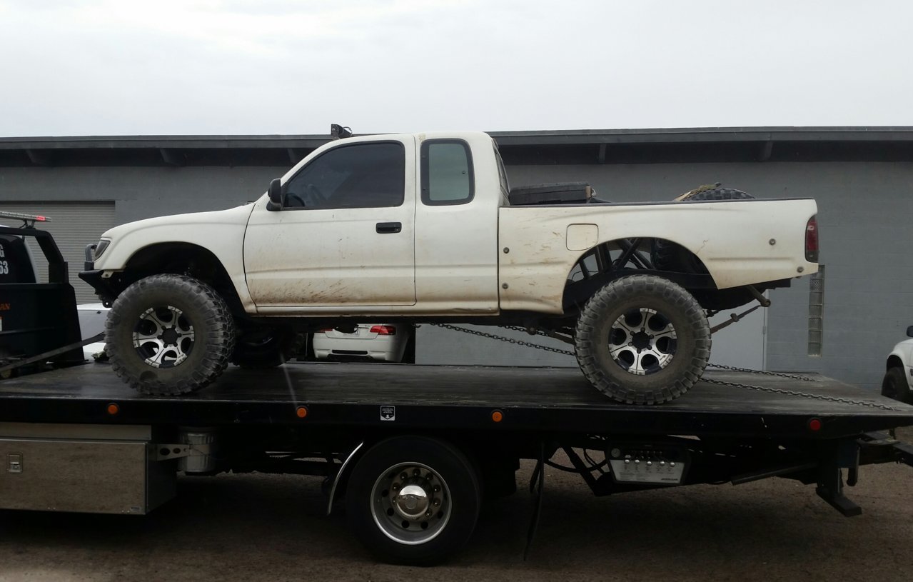

    Had it towed to the workshop in the morning and let it sit for a day since I had work and other issues to deal with.

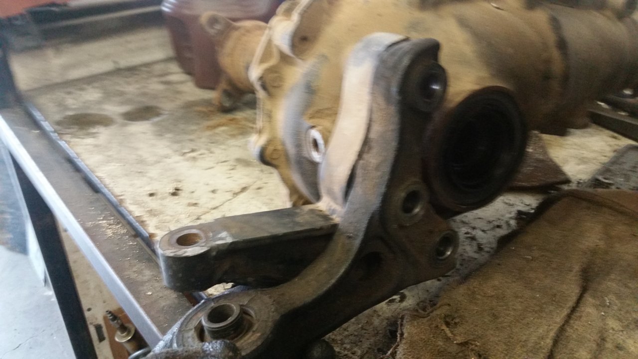

    Today I drained the front diff. Magnetic plug was stoked on how much material it could hold, I was not. Fair enough, now I know the problem.

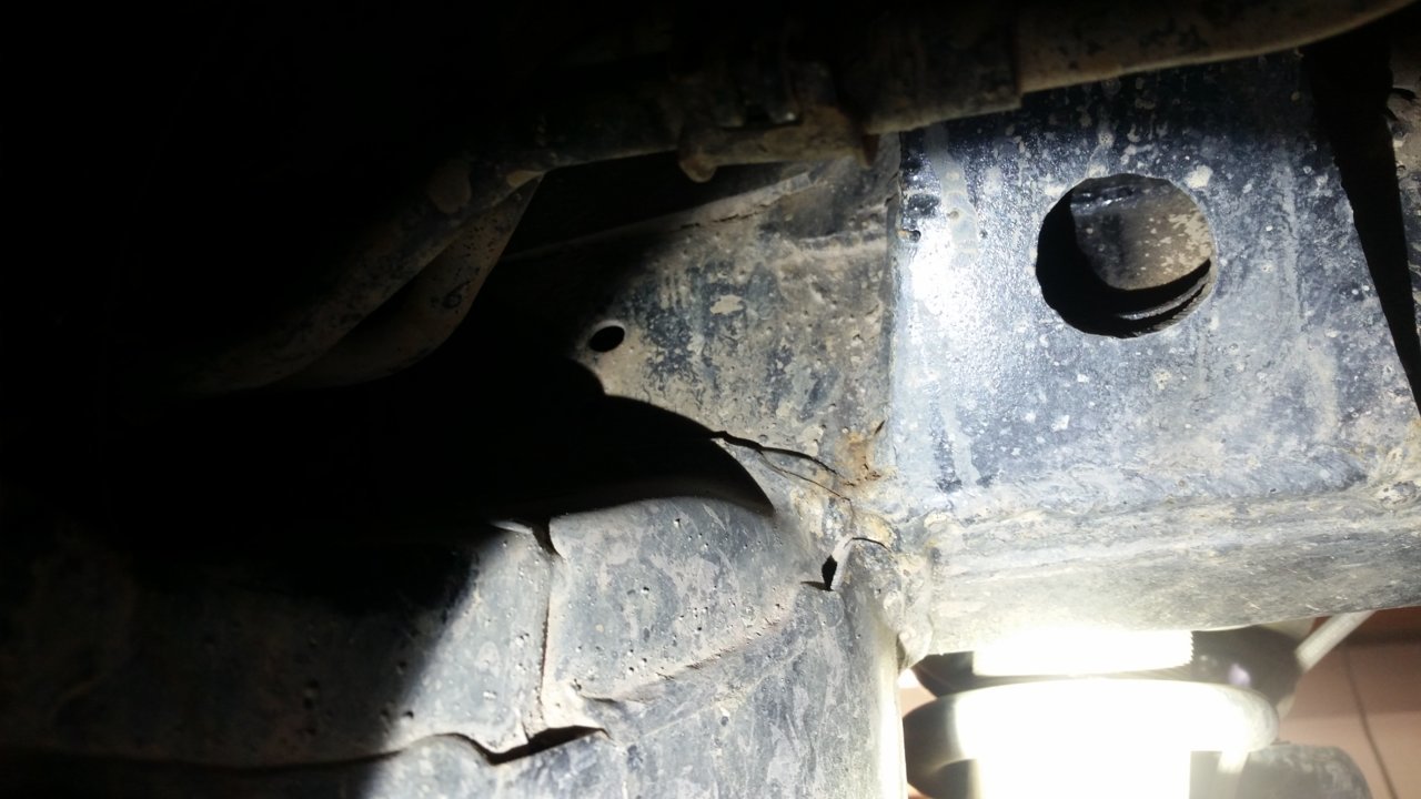

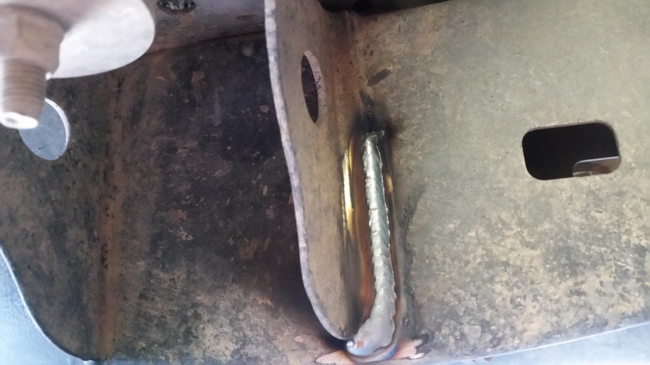

    Once the diff was out I saw some more spider cracks on the frame, so I gouged and welded those too.
    Thankfully I had a spare pumpkin with the same ratio from another project, so that went in. Also took pics of the cool diff drop the previous owner made. Diff drop plus clearance, very nice.
    Put everything back together and on the ground. 4x4 works and no noises turning or driving so far.
    To be clear, I did hit the front end fairly hard the previous evening on a dug out rock. No symtoms at the time. There was a mark on the diff today even with the All-pro skid plate, although they were very close together to begin with.

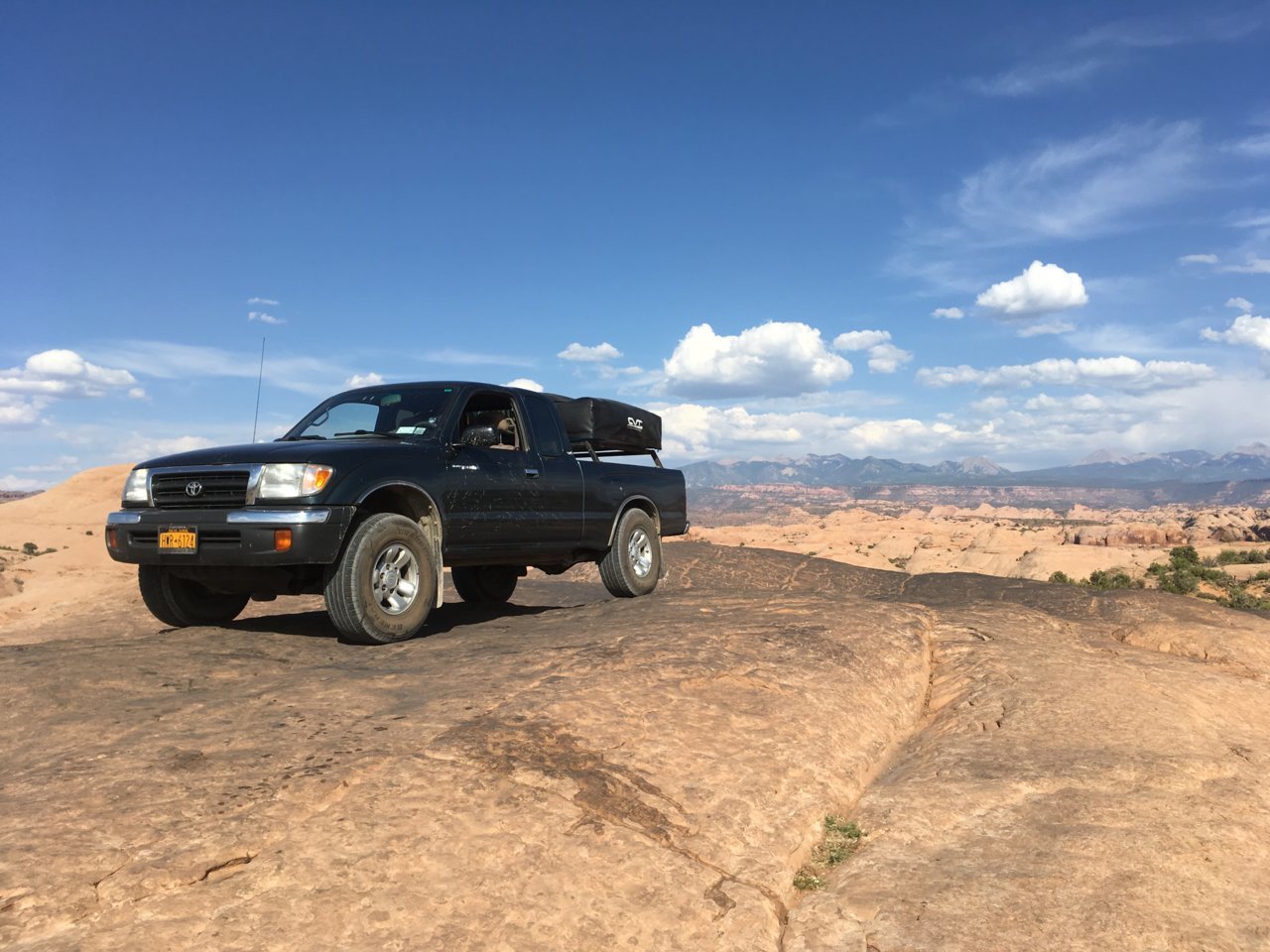

    Floor mats
    I’d shit if I saw that on my drain plug.
