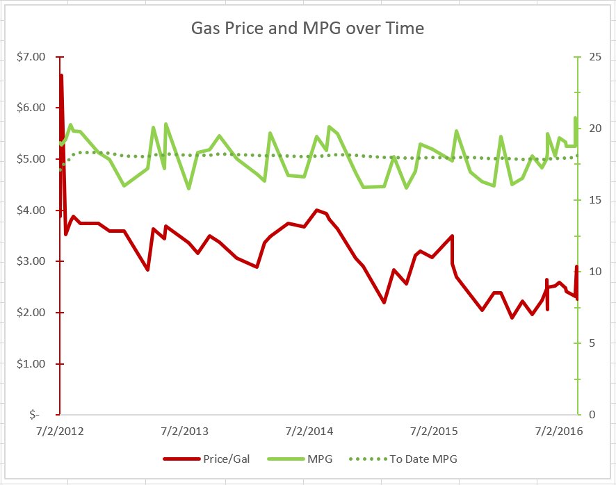

    And - just to make my point that there are much wider swings due to all kinds of things besides tire pressure - here is my truck for the 5 years prior to any mods - so all stock. Same set of tires, same tire pressure the whole time. Driving was consistent as well - commutes to work and trips; 80% plus highway driving. Still, ranged from 15.x to 20.x mpg. But the average over time (any 4000-6000 mile period) is much more constant - essentially the green dotted line; that's why it's way more important to look at that vs. any tank (or even trip, unless it's a De-Tour length one ;)).
    1.6 (10%) is significant over time. It's not significant over the course of less than 15+ tanks of gas though. It could just be an outlier, as there were in my chart above.
