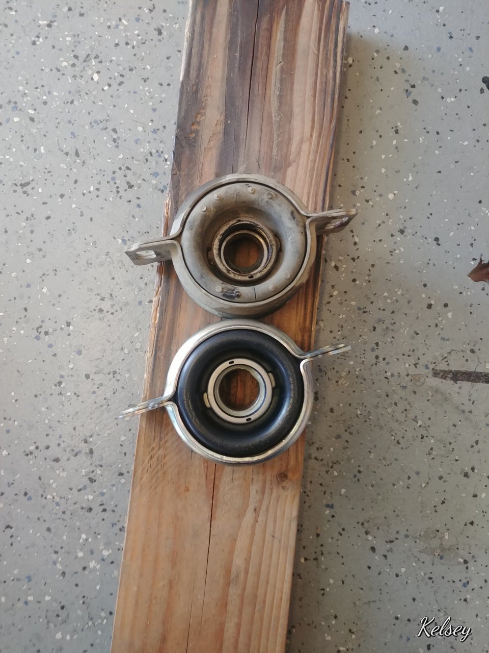

  12. Jun 24, 2018 at 7:49 PM
    david9kelsey
    david9kelsey Well-Known Member
    Apr 24, 2018
    #251491
    141
    David
    Murrieta Ca
    00' Tacoma PreRunner
    Dido. I just did mine. I had a 3 arm puller ready. Didnt touch it. The bearing slid right off. I marked everything and just restaked the nut with a punch and ball ping. Eliminated my "wobble/shake" at 65/70 mph.20180609_142239.jpg

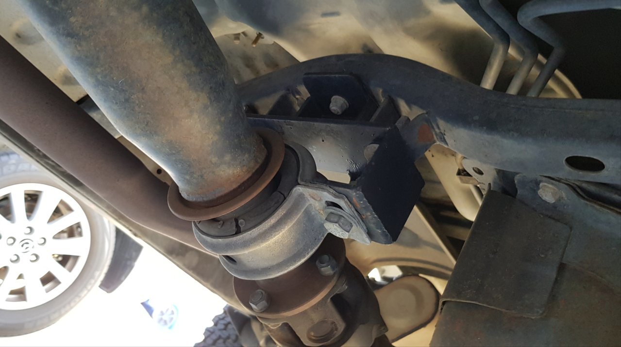

  14. Jun 24, 2018 at 7:54 PM
    HansWorldTravels
    HansWorldTravels Well-Known Member
    Jun 3, 2014
    #131202
    164
    Hans
    Colorado/NY/Germany
    '03 Toyota Tacoma 3.4L Ext Cab TRD
    Roll & Ram repairs on '95 Front end crash repairs on '03
    Lots of good info in that link/write-up. I've got at least a 1/2" of play in mine upto an inch once I push on it. Haven't really noticed any noise or U Joint clunking for the matter either.
    Seeing a big range of prices also... ~$55 partsgeek to $150 as mentioned.
    So is there or is there not a grease fitting in it? I didn't shine a light into mine today... but in this video (from the link) it sure as heck looks like there is one ... https://www.youtube.com/watch?v=vtBHKHGa8Fo
  15. Jun 24, 2018 at 8:23 PM
    zero4
    zero4 Metal Cutter
    Sep 10, 2006
    #31
    5,989
    Will
    SFV, CA
    01' DCab 3.4L TRD
    Donahoe CO, Donahoe Rear Resi, Deaver J59, 16" Pro Comp, 33" BFG AT, Hayden Trans Oil Cooler, Oil Filter Relocator, FM 40, ES Bushings, Beefed CB Drop, Deckplate, K&N Drop-In, DO Bed Bar, Cobra 75 WXST, Firestik Firefly, Philips D1R, Clarion Remote Start, Husky Liners
    Nice. I've never had this drive train shake/wobble that people speak of but maybe it's because I have a CB drop bracket? But I never noticed any shake before having the drop bracket either when lifted. For me the CB drop bracket eliminated the drivshaft yoke clunking though.
    Earlier I said mine has excessive play but really I don't think it does. I know it's supposed to have a bit of play due to the rubber. I've got 215K mi & basically I'm only going to replace it cause the rubber is cracked on mine.
    Damn these things are expensive now. In the tutorial thread it said $147 from Partznet, now they're $180 & some places are selling them for over $200. Well aftermarket ones are dirt cheap. Thanks to ebay can still get em for just under $150. Just bought one for $146.
