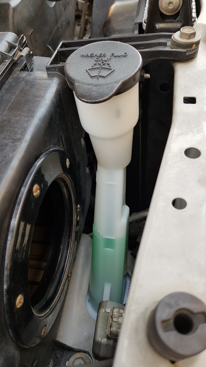

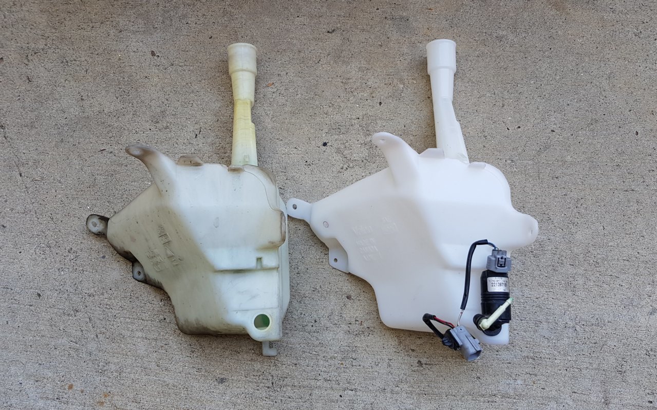

    Got it from a 3rd party Amazon seller. $95 shipped for OEM part, cheapest I could find including shipping.
    They make after market ones for half the price though.

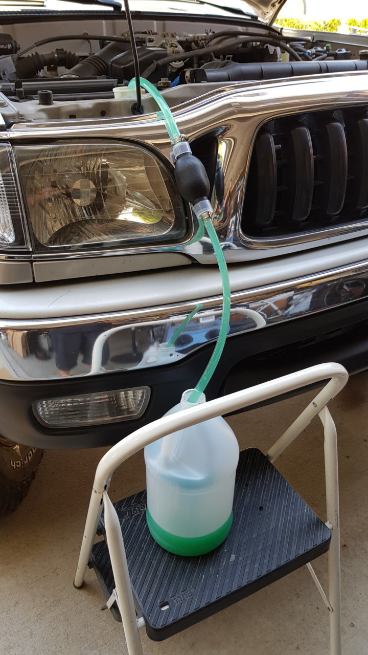

    Wasn't going in, draining out. I could have just pulled the res out of the truck & then dumped it but I didn't feel like getting squirted in the face when I disconnected the pump line. I suppose I could have just capped it though. It had about a gallon in there from trying to fill it last week. Plus I had the inline siphon pump already so might as well.

    Yea I shoulda realized that with how everything was situated haha.
    I know how a siphon works, had another blonde moment.

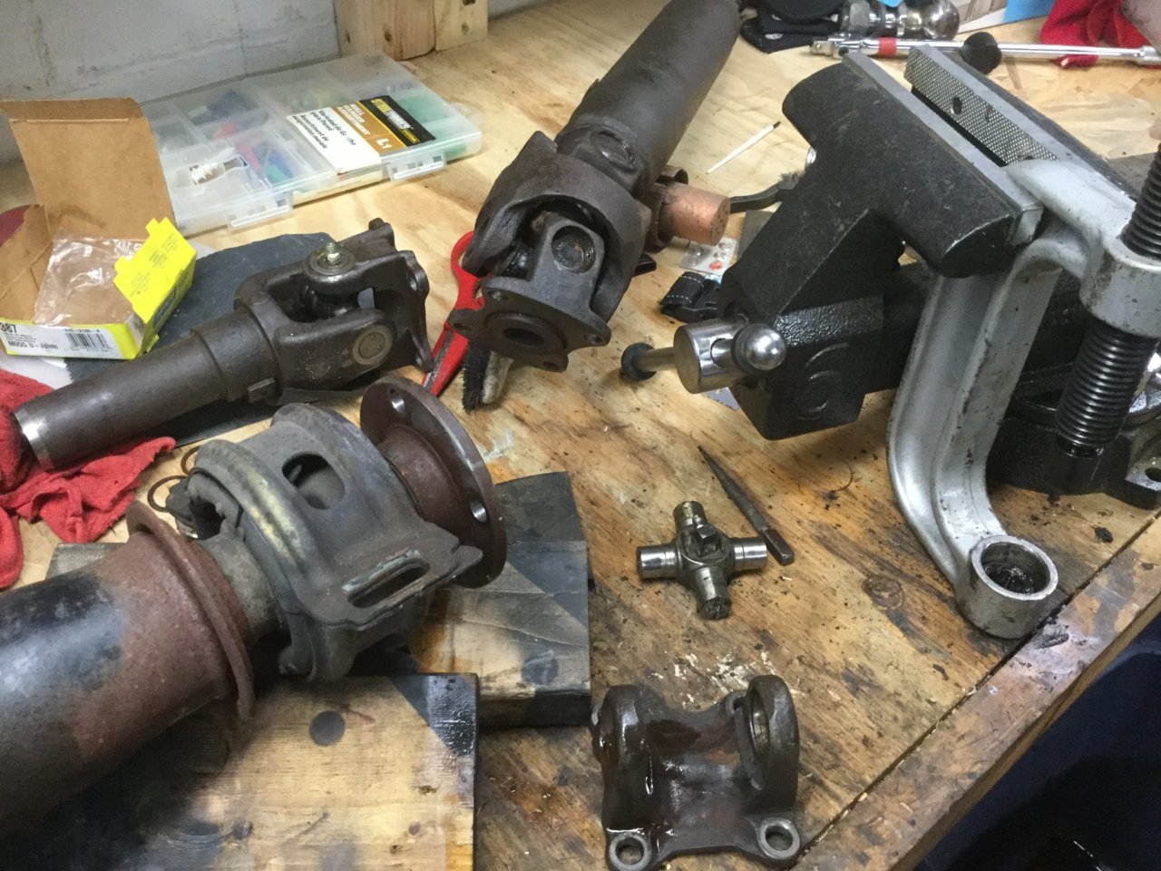

    BFD48BE3-F8AE-4F66-9DB4-D453FC949F9A.jpg what ever it takes.... to get those caps off on the inside clips. once they are sticking 1/2” out hammer the effers on the sides or grap ‘em with a vice and twist.
    I might just be putting in new “outside” clips on the 2 UJs in the Cardan Joint & hoping for the best... those effers aren’t coming out no matter how much one pressing them 1 way or another. I think there is some super secret order one must disassemble it... Toyota has all sorts of “secret code” numbers stamped in it.
    hoping for a simple Center Bearing changeout.
    Oh... just actually looked at the center bearing.... guess it needs replacement for certain! :D

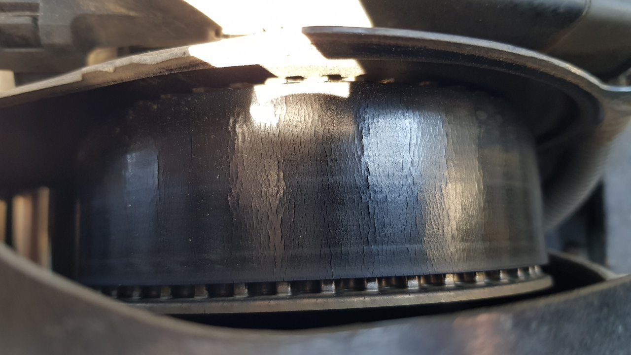

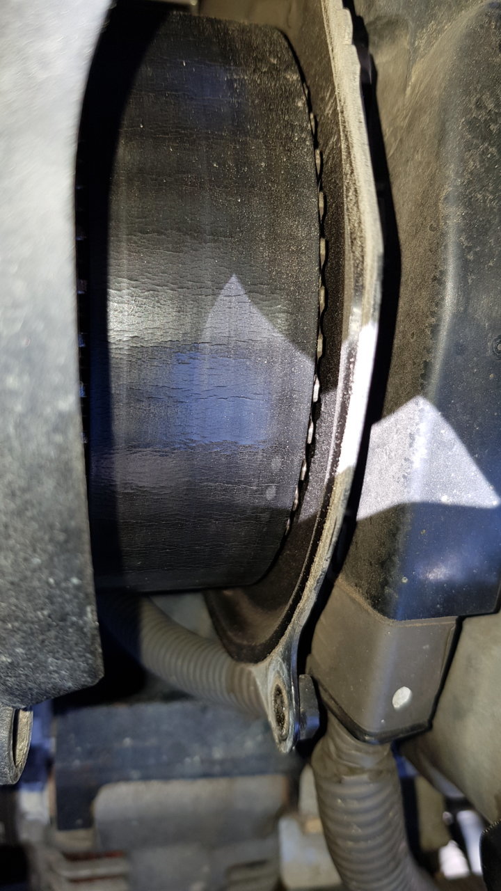

    You got me worried so I looked at mine today. Not nearly as bad but yeah I guess I should do it soon. I've had the new timing belt & water pump sitting in the garage for a couple of years too. Haha
    213K miles

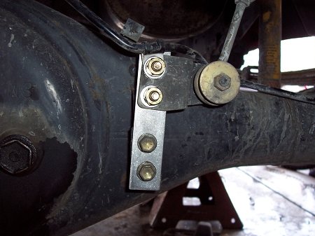

    call me dumb on this one.... but we’ve got an oversized coathanger that comes out of the porportioning valve, 3” of threaded rod for adjustment and a rubber swivel. I tend to find it hard to believe that the “oversized coathanger” would not get bent out of factory OEM shape if one looked at it funny - let alone bungied it up to the cross-support during rear diff work or was otherwise effing around in the area.
    From reading another tread on this, seems as though one is best to determine what is “up” and what is “down” (front or back brakes), loosen the threaded adjustor rod, and adjust accordingly. My threaded rod is pointing a good 20 degrees away from the PV (towards the passenger side).... and I haven’t the sl

    I need to do this too! How much of a hassle was it to install? Also, how much did the new bottle cost?
    Thanks!

    Didn't get it yet, should be here tomorrow.
    This is the one I purchased.
    https://www.ebay.com/itm/SENT-PRIORITY-Toyota-4x4-Carrier-Bearing-95-04-TACOMA-93-98-T100-37230-35130/182597823616?ssPageName=STRK:MEBIDX:IT&_trksid=p2060353.m2749.l2649
    Here's another one that's cheaper for $143 shipped. Seller is in CA so I would have got charged tax & is why I purchased from the other seller.
    https://www.ebay.com/itm/T100-TACOM...919962&hash=item3d40a01e54:g:vswAAOSw1JhZYBFj
    It was really easy. Hardest part which was not hard at all was disconnecting the plug for the pump & level sensor if yours is dirty like mine.
    To avoid getting wet drain the fluid if there's any in there or have a vacuum cap ready to cap the nipple on the pump when you disconnect the hose. My fluid was brand new so I drained it first to recycle as much of it that I could to reuse it.
    I paid $96 shipped Prime 2 day for it on Amazon for the OEM one. There's aftermarket ones available for about half the price.
    https://www.amazon.com/gp/product/B00FZRYURC/ref=oh_aui_detailpage_o03_s00?ie=UTF8&psc=1
