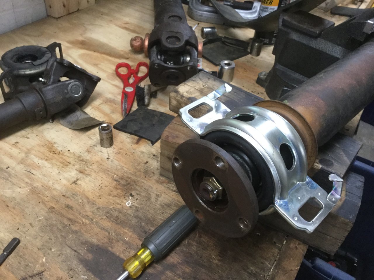

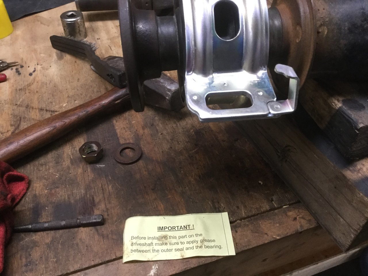

    then whats this mean?

    I got one off ebay for $146 as well and it was legit OEM
    I put grease on the metal part where the bearing slides onto the shaft but you don't need to put it inside the rubber

    What was the torque again? 120ish, backed off to 70ish? Cant find that post again

    It’s like 123 and then 51 or something I’ll find it.

    134 to seat it, 51 to hold it.

    I wish anything else on the driveshafts was half as easy as this. No gear puller needed. Less time required than breaking loose/removing the two flanges on either end of this section.
    I guess I’d rate this as not worth those 3x OEM prices you guys paid based on ease of replacement. I’d be (now) more likely to pay gold prices for each of the UJoints... not sure how replacing UJoint is so stuck in my mind & not that complicated/difficult. It seems something I’ve done on at least 3 vehicles in the past 25 years. :|

    Yea, I'm with you on that one. If it's easy to replace, and it's not a safety or performance issue, I go cheep.

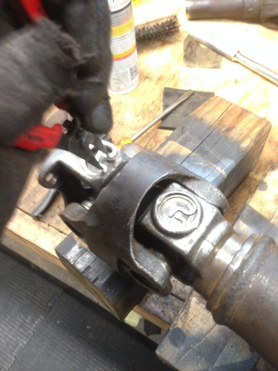

    Double Cardon UJoints - 2
    Hans - 0
    Countlesss hours reading why I shouldn’t touch it, 1 “hold my beer moment” to take a hammer & press to it just because I can.
    24 hours wasted
    But hey, I managed to install 6 (of 8) new outside ring clips (the last are 2 RCHs shy of fitting in) and not completely jack the thing up.
    New strategy - pumped it full of grease, check every couple days and keep an eye out for a replacement.
    New center support bearing and the UJoints at the rear diff & transfer case. Front driveshaft UJoints can go eff themselves! :D
