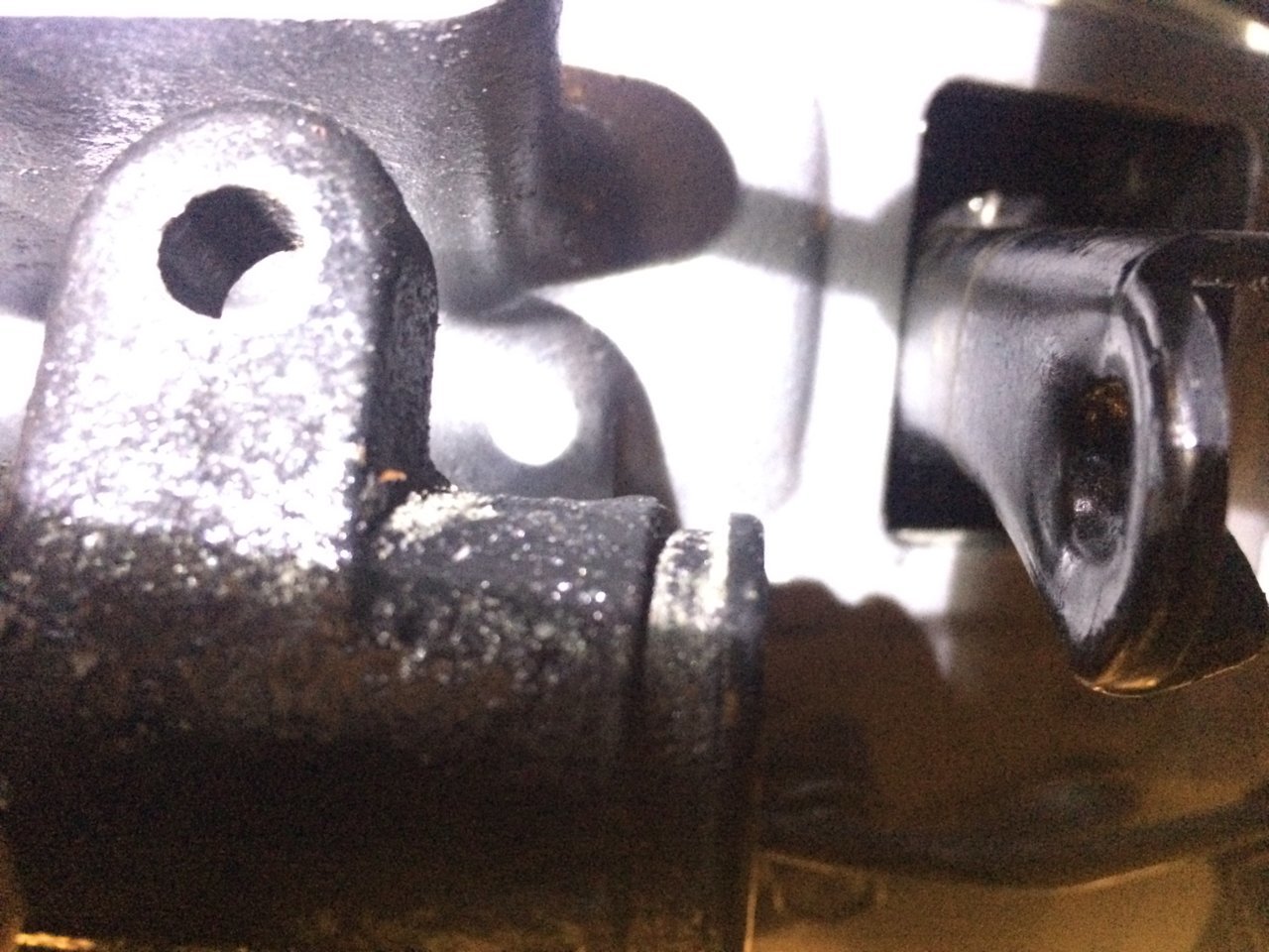

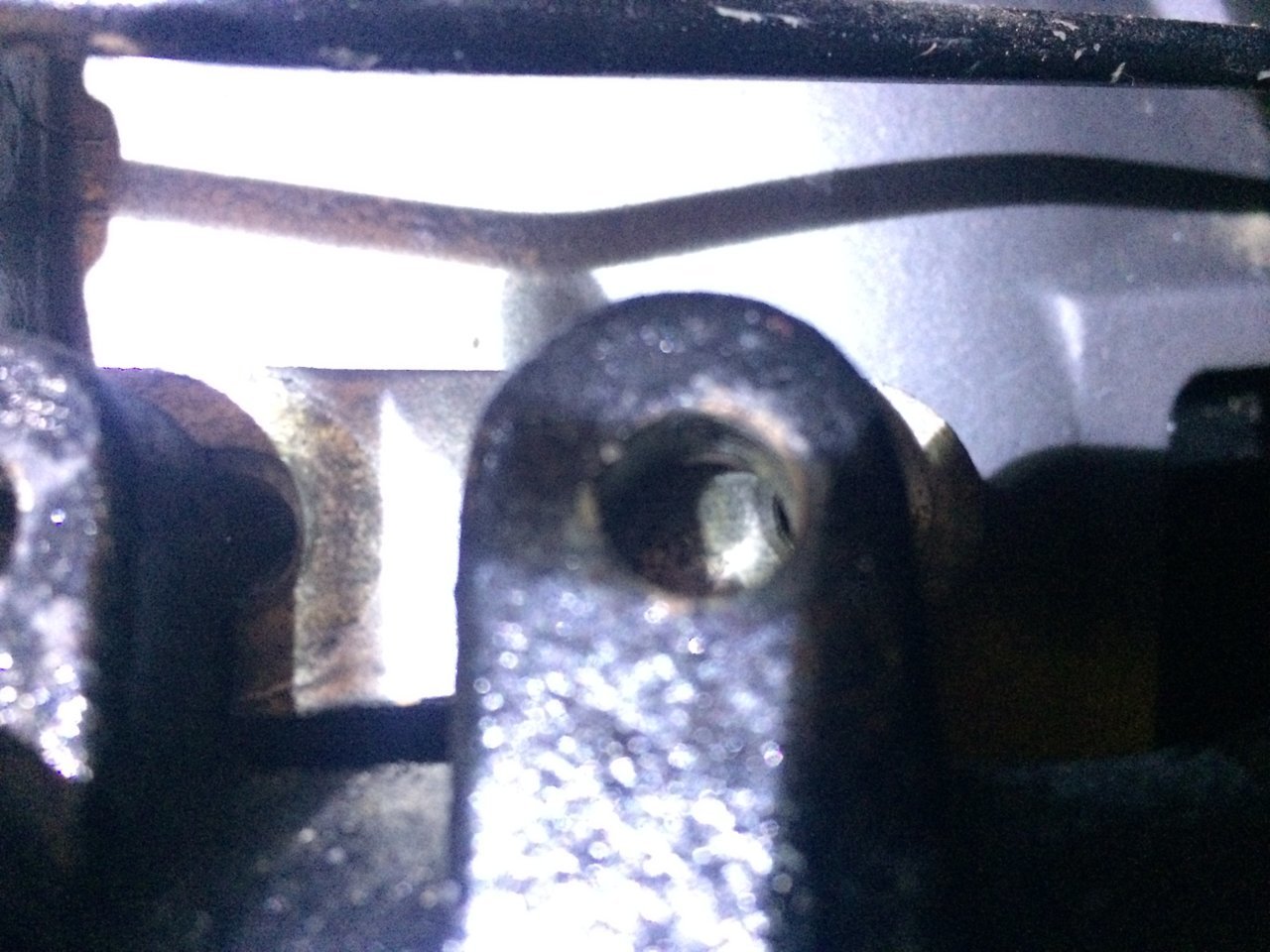

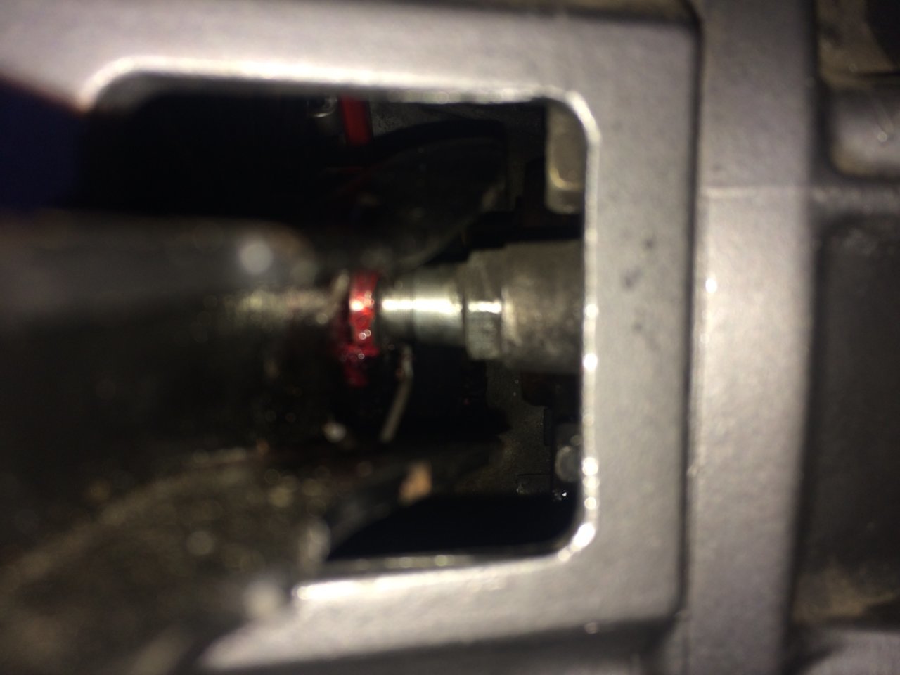

    Go with the c-clamp and bleeder valve open technique you're saying?
    I drained the master cylinder a fair bit last night so I bought some dot 4 brake fluid. If it works I'm guessing I should just flush the system?

    If crack the bleeder valve you should be able to push it in by hand.

    Tried that last night - wouldn't budge - maybe I'm a girly man :pout:

    Use a clamp. The clutch pedal is all the way up correct?

    Yes, but that shouldn't matter once the bleeder valve is open since there's no mechanical connection between the slave and master cylinders right?
    Edit - tried a slider clamp and same thing. I'm thinks it's seized in there after sitting for a year and it was rusty before that. Next step is replace the slave cylinder I'm guessing. Looking for the best price on a quality one. Is Aisin the way to go?

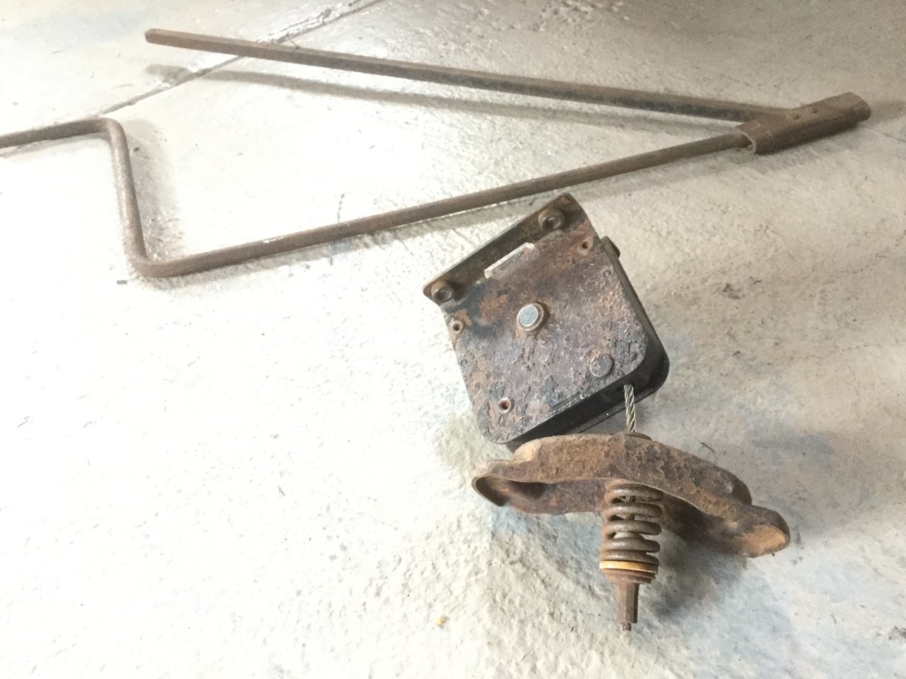

    Called the dealership about 4 bolts for the “engine rear mounting bracket” to “transmission” which a yotatech thread listed as 14mm head - 10mm x 1.25mm x 22mm... https://www.yotatech.com/forums/f116/cross-member-transmission-bolt-size-210153/ and they couldn’t locate them without a part number bc their system scrubs older vehicle parts out over time... he said it was just as easy to get from a hardware store.
    Asked about the frame recall - no go for mine (good & bad - as I just cleaned a bunch of it up, but a new frame would be nice.)
    Asked about any other recalls - and this popped up for the LBJ assemblies. That could be really good as I’m planning on doing those bushings anyways (Energy Suspension Bushing Kit just arrived Thursday), but maybe I’ll get new LBJ installed free of charge. :) Recall # 50J - https://repairpal.com/recall/05V225000
    And a very critical recall “The spare tire in the subject vehicles is located underneath the rear of the vehicle and held by a spare tire carrier. A lift plate on the carrier is used to help raise, lower and retain the tire. During its manufacture, the lift plate may not have been sufficiently coated with anti-corrosion materials. If the plate is insufficiently coated and the vehicle is operated in cold climate regions where road salts are frequently used, road spray can reach the carrier assembly and corrode the lift”
    Should I stop wasting my time cleaning this up and maybe they’ll just give me a new 1 AND the spare tire crank (I never had) and thought to fabricate with another relic & poached from my old man?
