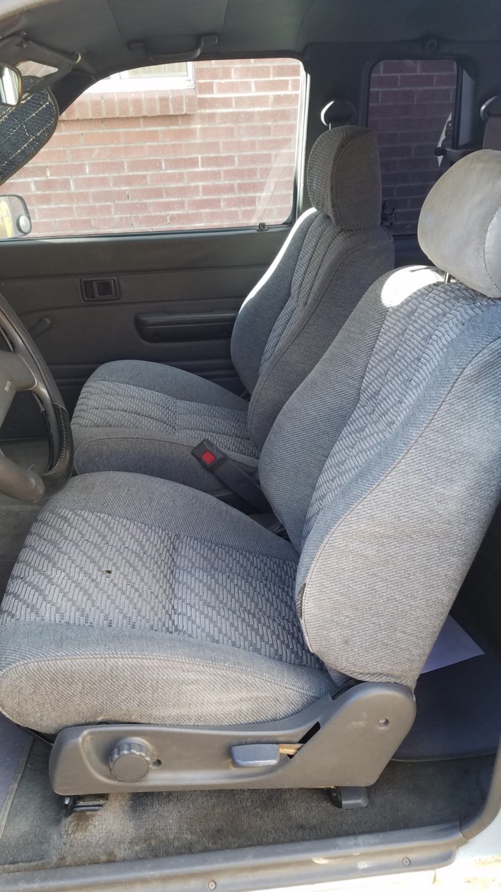

    Seeing how my Tacoma is out of circulation until I get my gears done, I spent a little time on my 1989.
    New to me 4Runner seats!

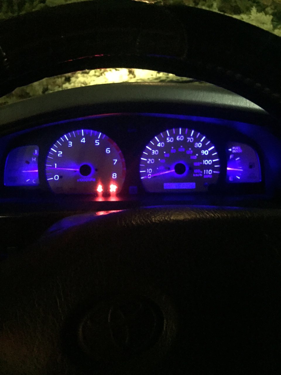

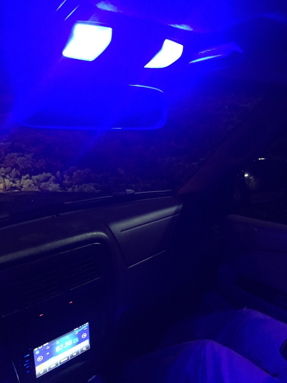

    F8A4B9D5-6E1D-40DB-965D-14B979D48E5D.jpg 135B73BC-9666-4904-AFF8-9CDD0583DD7C.jpg New memeber here. Today I replaced the standard bulbs of my map lights and the orange bulbs from my intrument cluster with blue LEDs. Took a little while to get it all apart and back together but I think it came out great.

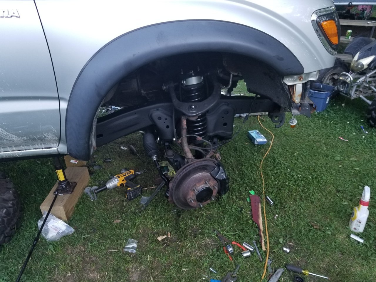

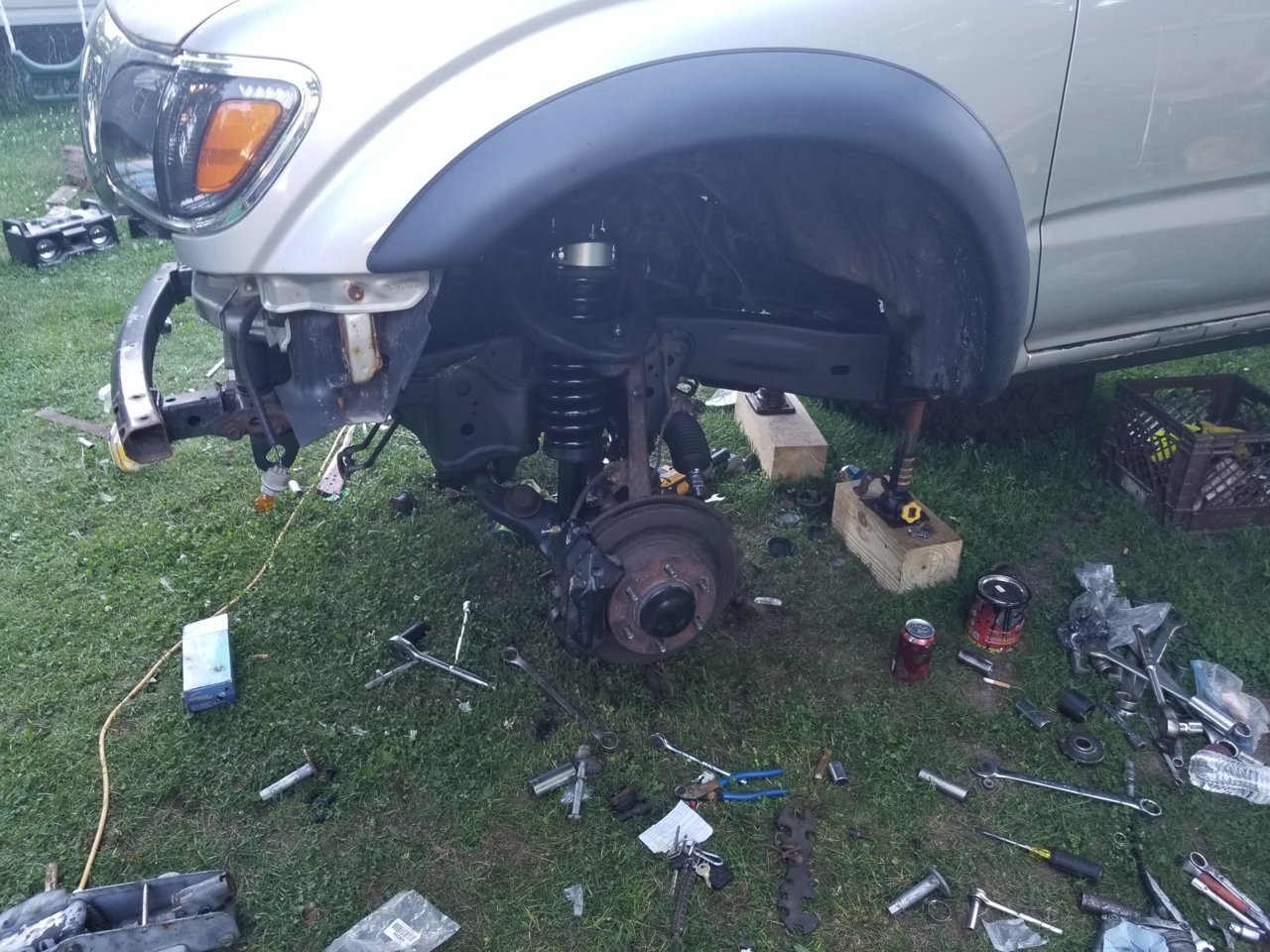

    Hey Kids, Whoever picks up the most tools wins: (Insert prize here)!!!

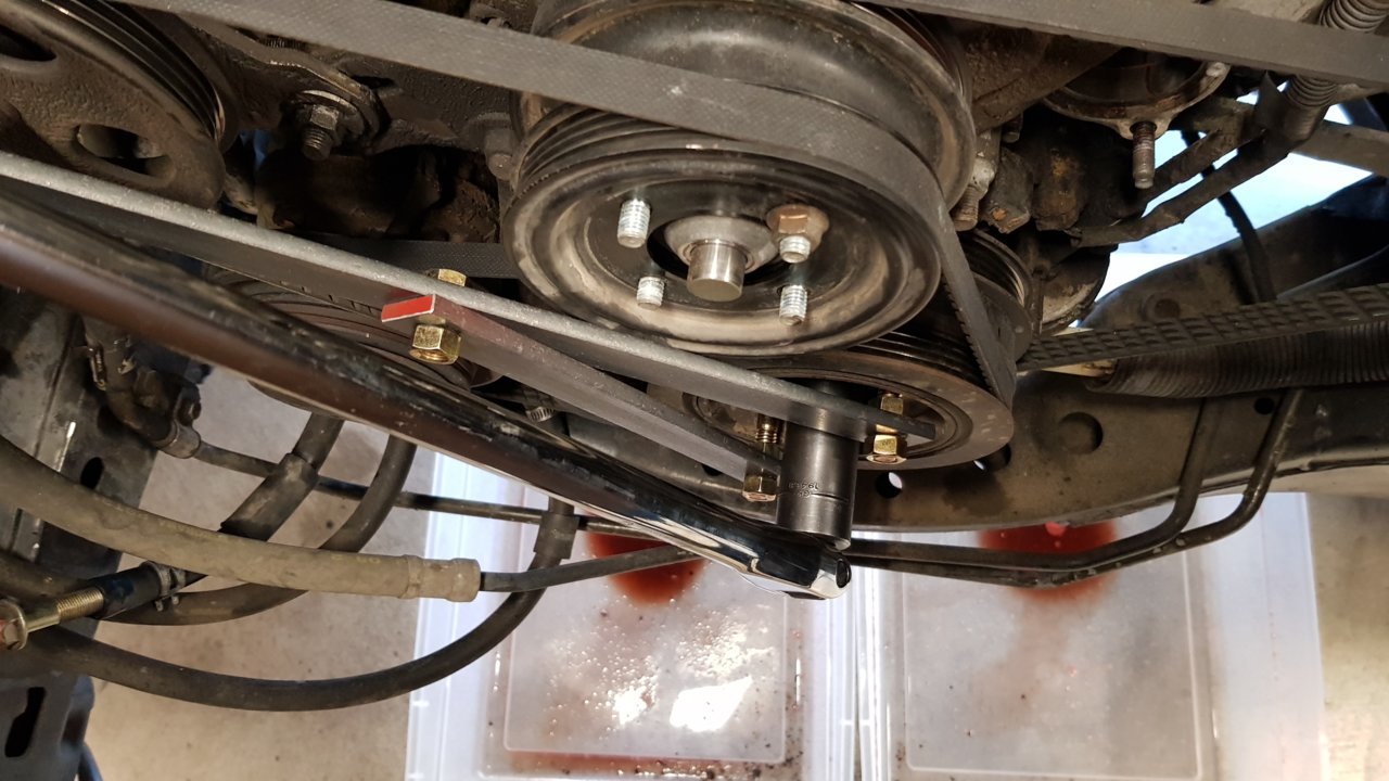

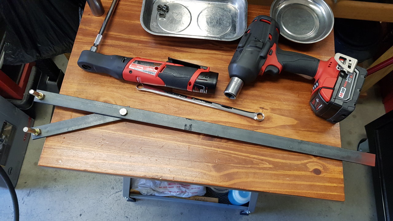

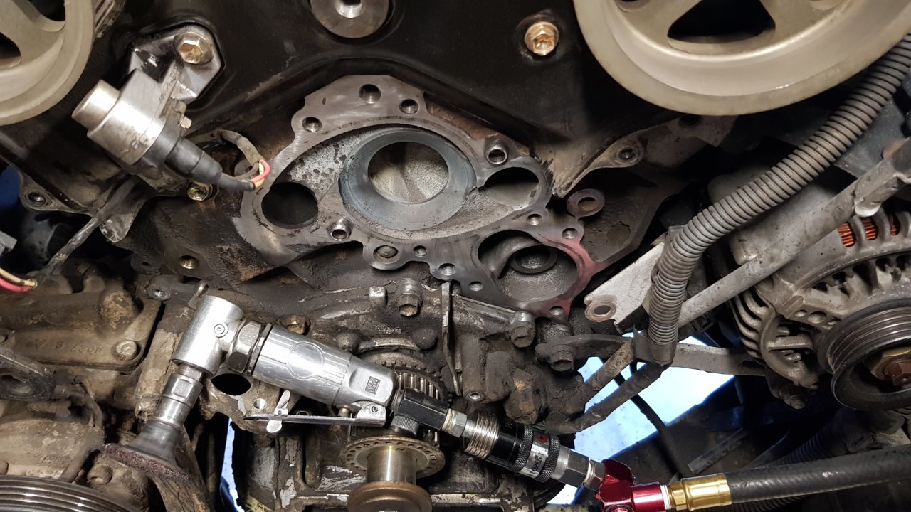

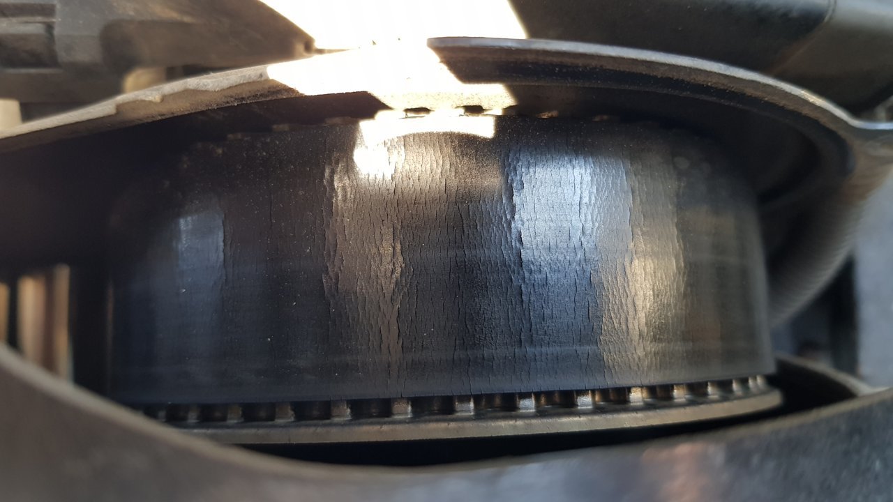

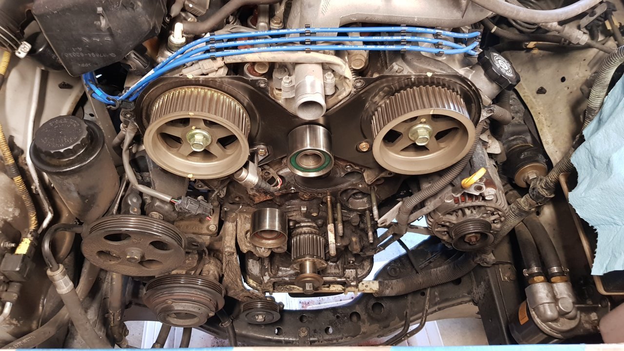

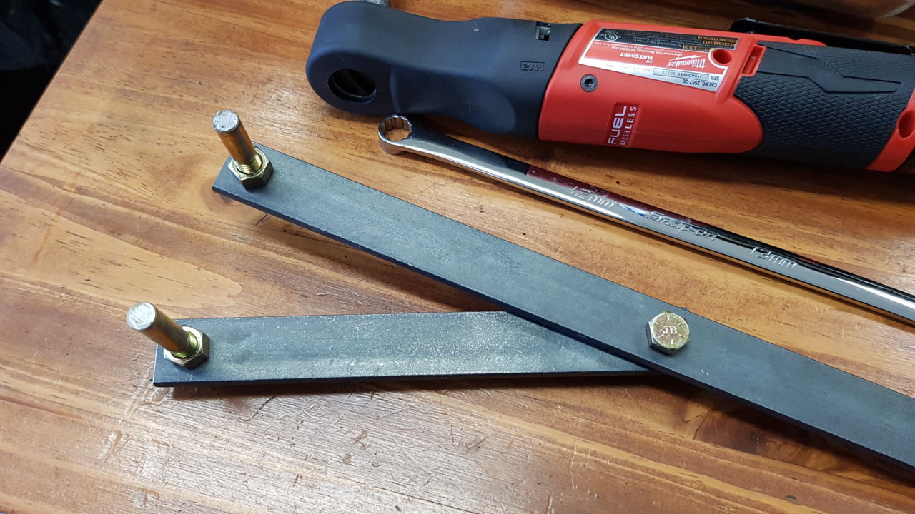

    Replaced timing belt today, 214K mi on it, along with water pump, tensioner, tensioner pulley, idler pulley, & radiator hoses.
    Neither of my air & electric impacts would budge the damn crank pulley bolt. I know lots of guys use the breaker bar & starter method but I didn't want to. Made my own pulley holder & worked great, cost me about $15 & 20 mins. Used it to hold the pulley to retorque the crank bolt too.

    What did you use to make that tool?
