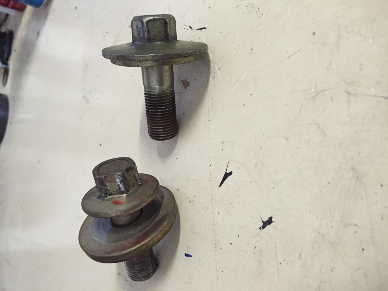

    After extensive *online* research and finding that there are in fact two kinds of crank pulley bolts - one with a separate bolt and washer and later one with a built in washer. The second one is supposedly re-usable.

    And interestingly they had two different torque specs - the original was like 184 ft lbs, but never seen that one show up on a truck on here or in any of my 3 engines lol
    Here it is: and I had it backwards - the originals had a built in washer image.jpg

    I have the original 2 book Toyota FSM, my copy says 217 ft/lbs & my crank bolt was the one with the washer that is not removable from the bolt. 217 is what I torqued it to.
