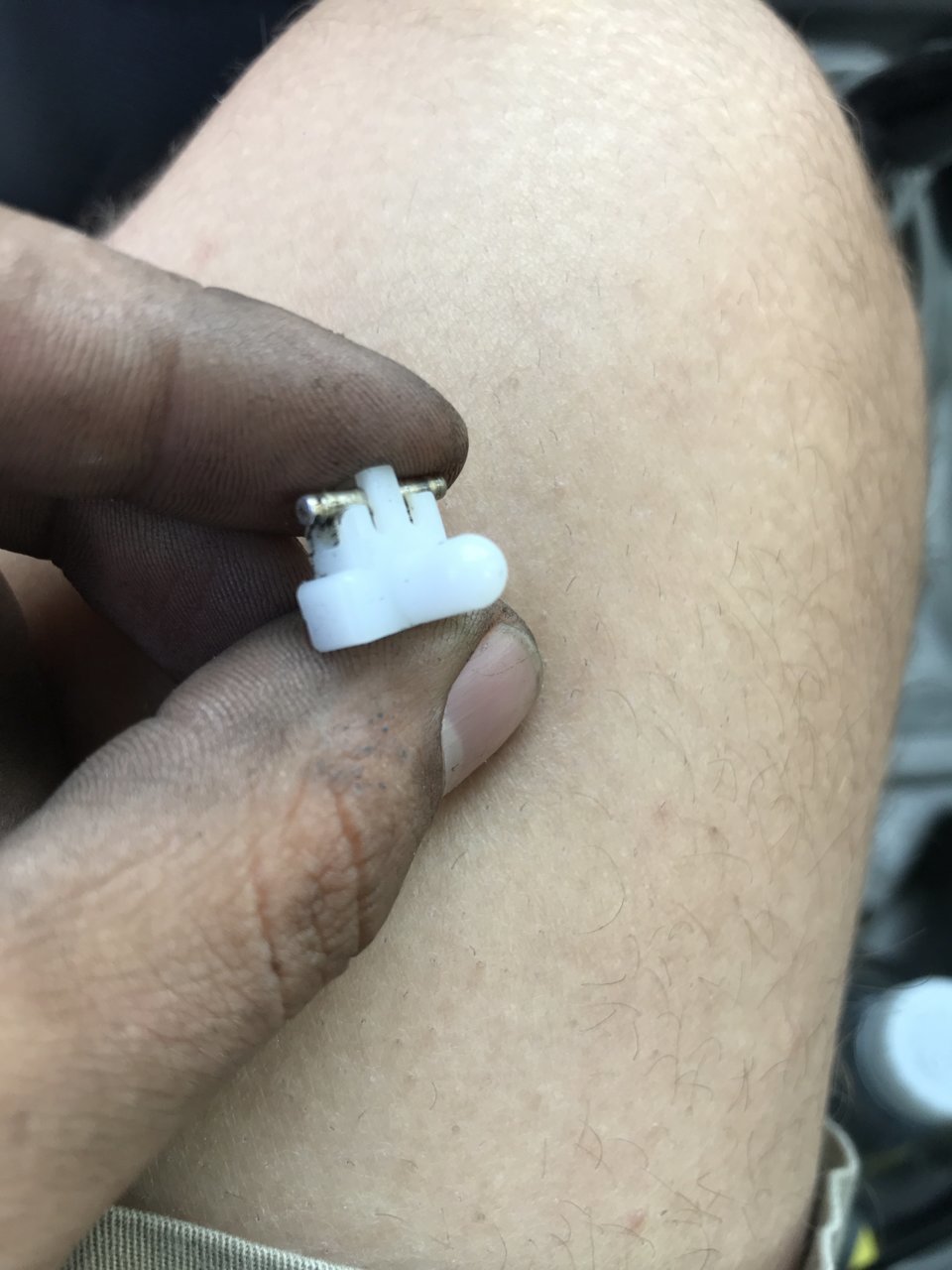

    Anyone know what this is? Came out my steering collum

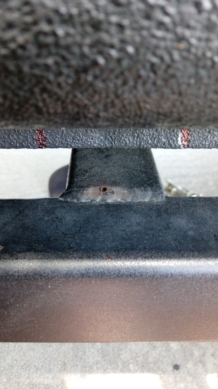

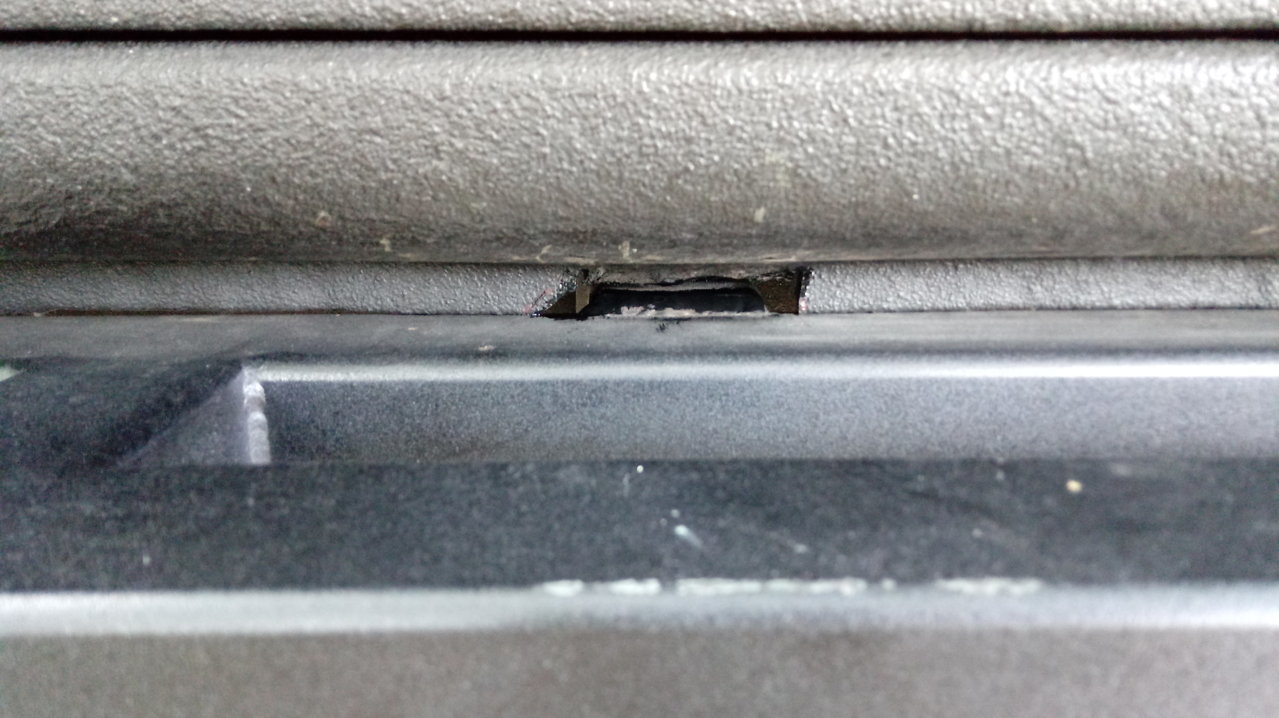

    My suspicions were correct. Squeaky bastards were rubbing the pinchweld. 0704181456.jpg
    After some sawzalling, hammering, painting, and cursing we have this.
    Also quieted my leaf springs with some white lithium spray grease. Hopefully it will last a few weeks at a time, but its easy enough to reapply. Should ride quieter than your grandmas LeSabre now.
