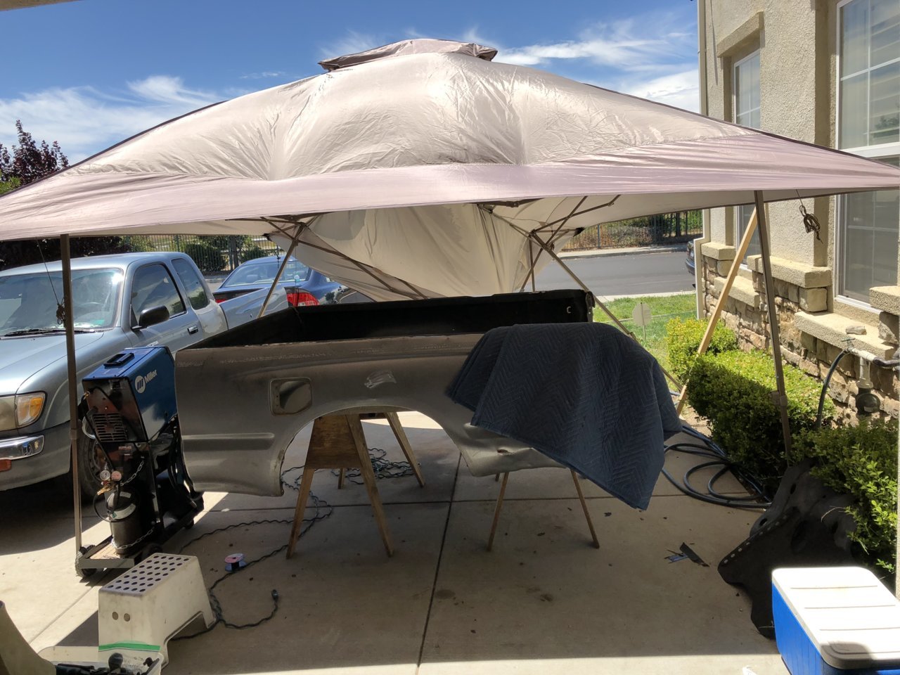

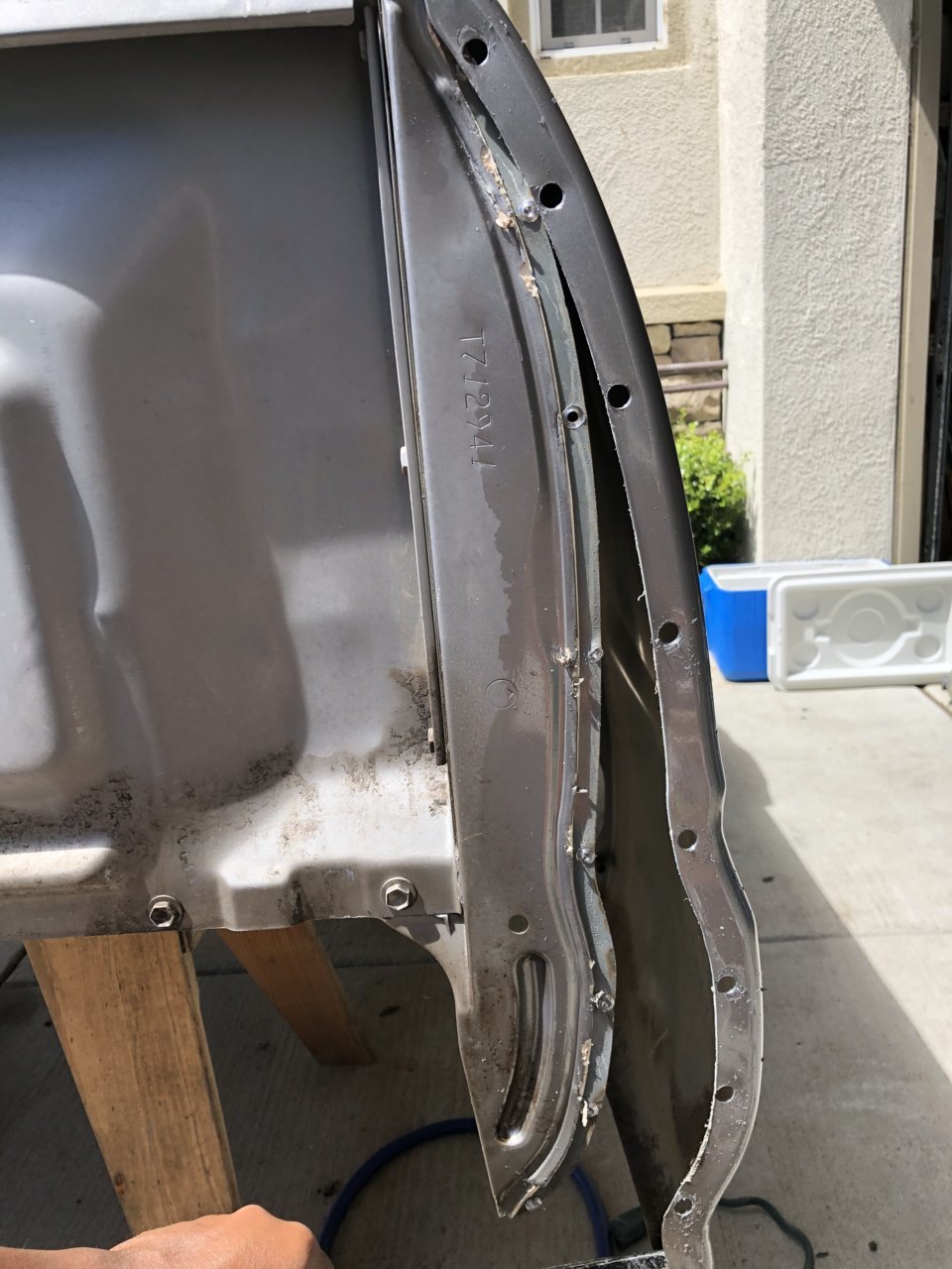

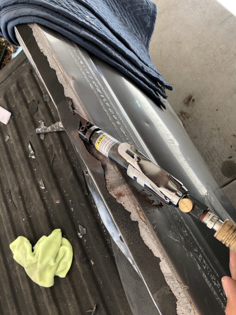

    Making progress on removing the bedsides on my donor bed. A good spotweld bit is absolutely imperative.
    A nice pneumatic air scraper helped to remove the spray-in bed liner.

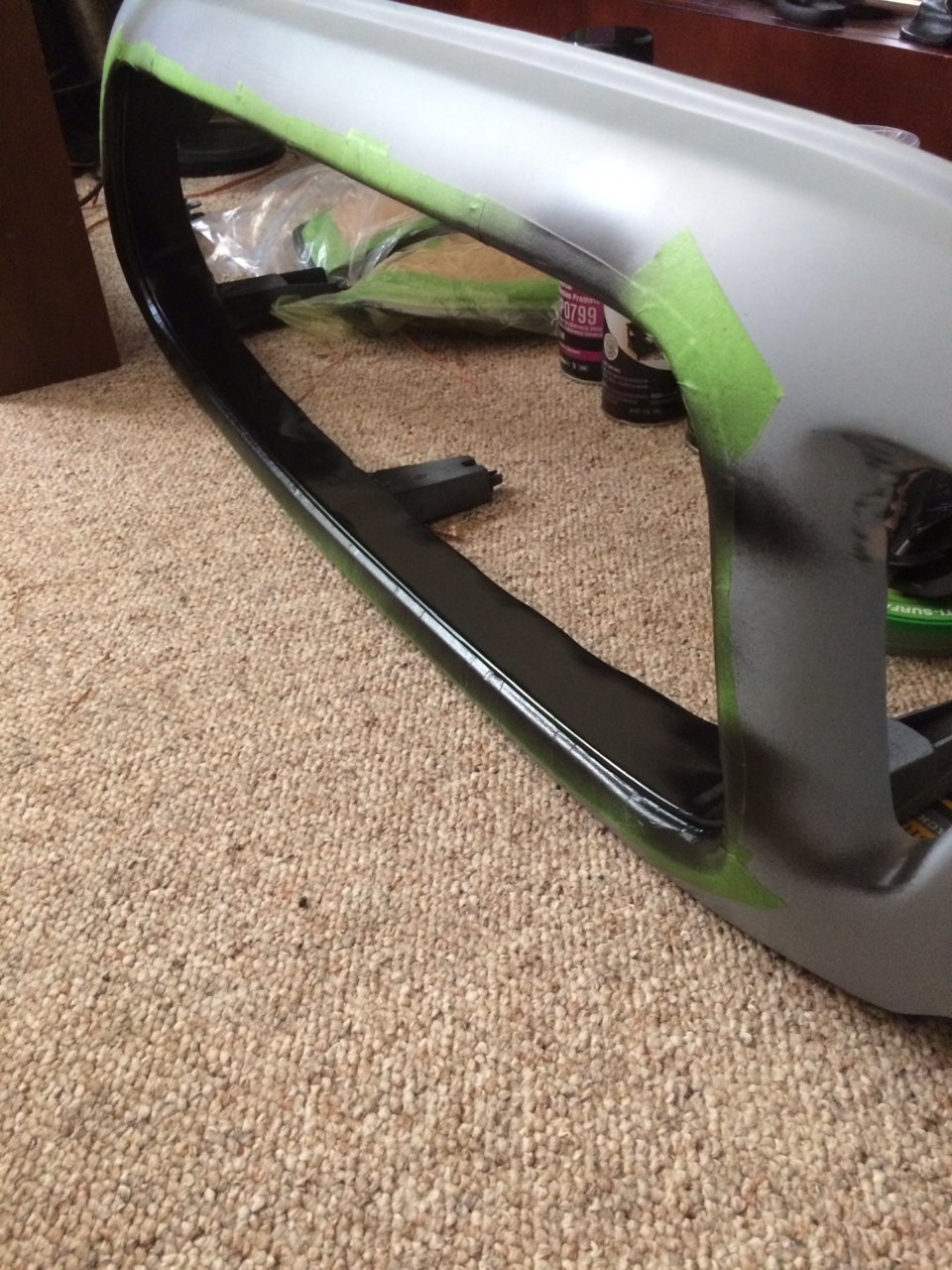

    Worked on my Satoshi a little more today. The mesh is semi-gloss so I went with a black semi-gloss for the inner lip to match. Bad idea. It highlights all the imperfections. Should’ve went flat black, or just done better with the sanding and Bondo.

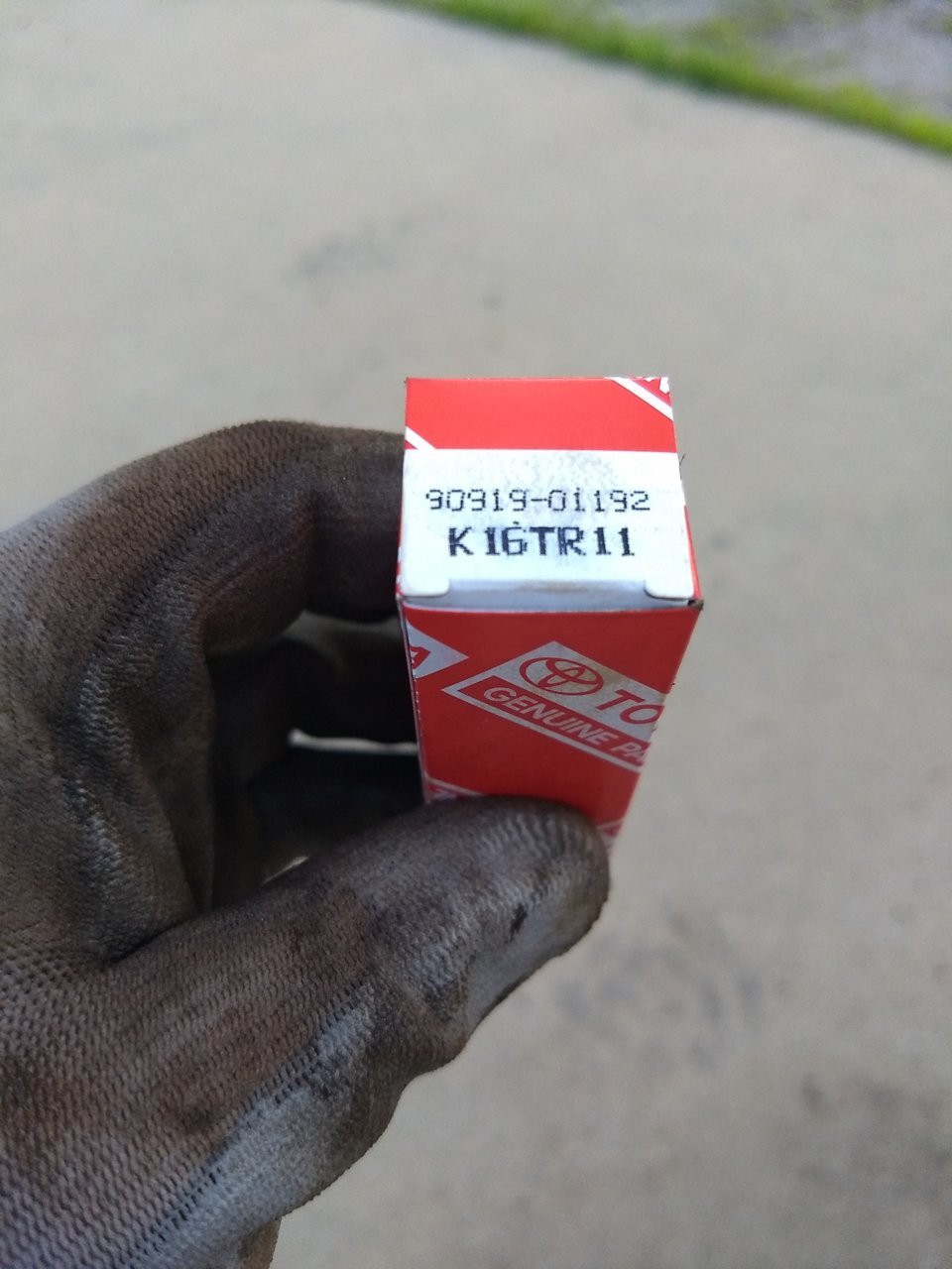

    :eek:Where are the 2nd electrodes?

    It's just more crap some po put in there...

    Thought that might be the case. Did you put the correct ones in?

    Of course...
    Here's one of the boxes with the part number
