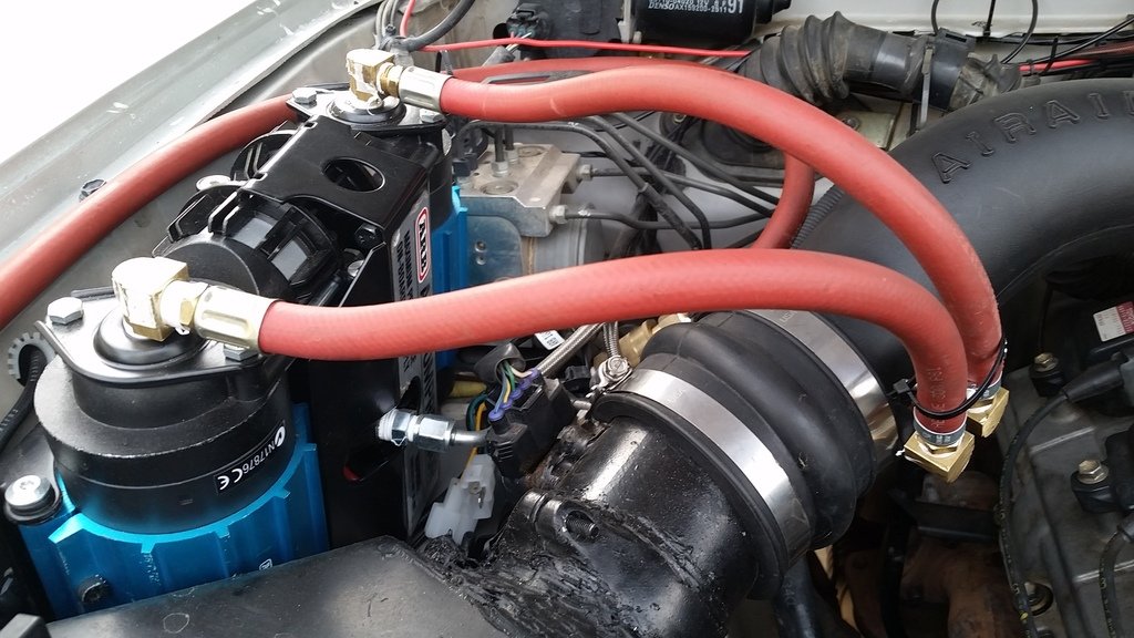

    i might have to steal your idea... that looks like it'll work fine... i was going to have my father cut a custom bracket out of aluminum, but fitment might not be easy.. your idea looks clean

    I use mine for my ARB pump, but yeah its tight. Plus stock air box is a POS

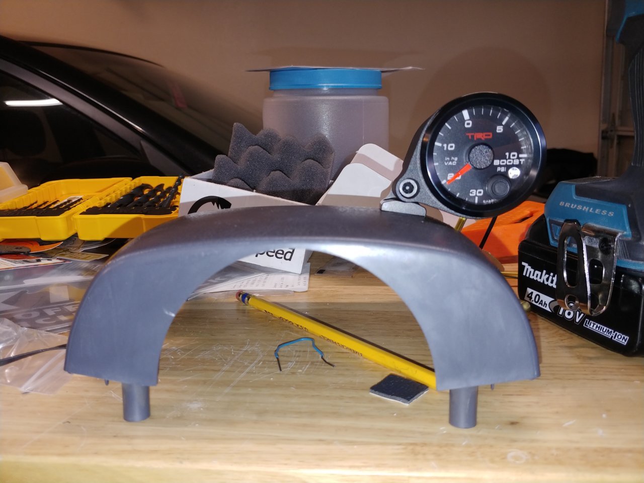

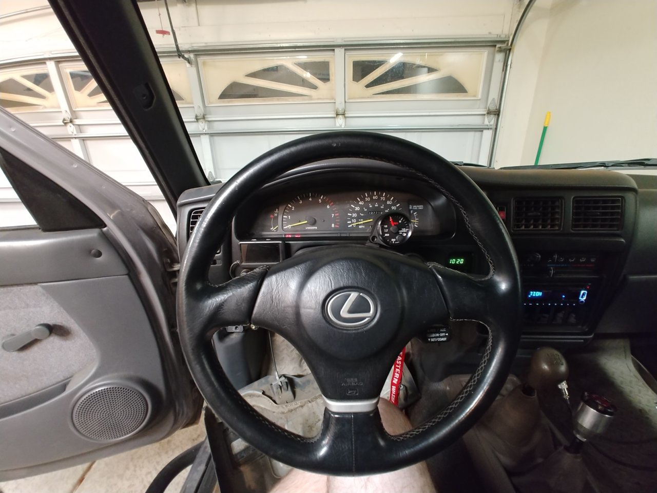

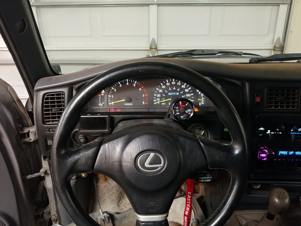

    Thanks, it is called "The Belmont" and it's from CravenSpeed. The finish is really nice and it has all the hardware. Just had to make my own drill template and friction fit piece (my gauge doesn't have threads coming out the back to secure itself in the cup)

    but its blocking your trip gauge! :boink:

    It wasn't particularly accurate, I use the ones on my Ultra gauge seen hiding off on the left. That is calibrated for the tires

    Tight? I couldn't even get it to fit on my truck even trying to connect it to the stock air box first outside the truck. There was no way I could get the MAF side coupler on, even tried pushing the airaid tube far into the TB side coupler. But after I shortened it, went on with ease & now has room for the couplers to flex with the engine.
    I don't know, I actually like the stock airbox. When I bough my truck in 04, PO installed a complete K&N FIPK intake. That thing sucks for offroad dusty conditions. I sold it for good money & bought a complete used intake off a guy on TTORA for $40. It came with a K&N drop in filter already inside it too. Been using that ever since. I did do the deckplate mod to it back then but whatever, it was a waste of time & money also. ;)

    Okay so I love this idea and might steal it for my Viairs but it would be easy to do before the MAF on mine. Does your truck ever go a bit rich from those sucking more air than the truck is using haha

    Oh and to update...guess what fits perfectly? Going to give it a go in the morning.

    Oh I love the stock air box but its badly designed. The way they weld the plastic neck to the box is too weak, I've had the neck break several times, did a fix that worked but then smog would not pass so I just keep getting new air boxes. Aftermarket ones are even worse.
    Only time I ever run the thing is at idle, truck just sips air at that point so there is zero issues. Only reason it may come on for a second or two would be to keep the lockers going.
