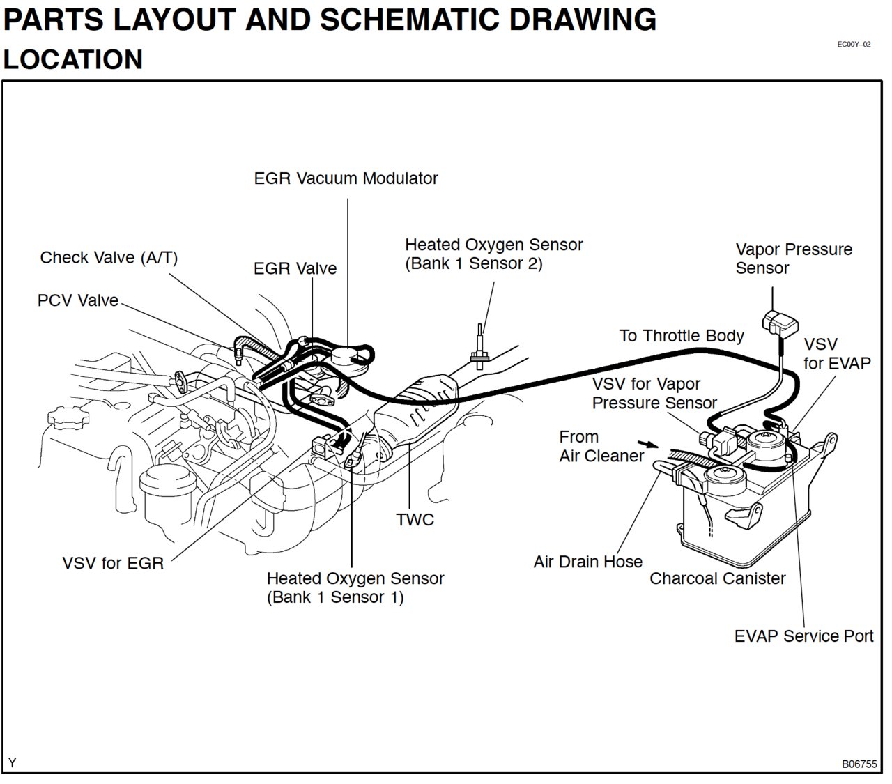

    I believe your masking tape hose just vents into the frame rail. The open nipple goes to the intake box.
    The extra part looks like the check valve that goes near the EGR. It could also be 4x4 vacuum related, but I'm not sure.

    Thanks man - I haven't installed my airbox yet so that's why I haven't hooked up the other line. I've seen a video where a guy has that port I'm talking about just open to the atmosphere. I guess that's why it could vent to the frame rail w/o any problems. Weird it seems to be overlooked in a lot of vsv diagrams!
    I'm still not sure about the other part - it's a one-way valve and my truck wasn't equipped with egr... could be 4x4 :notsure:

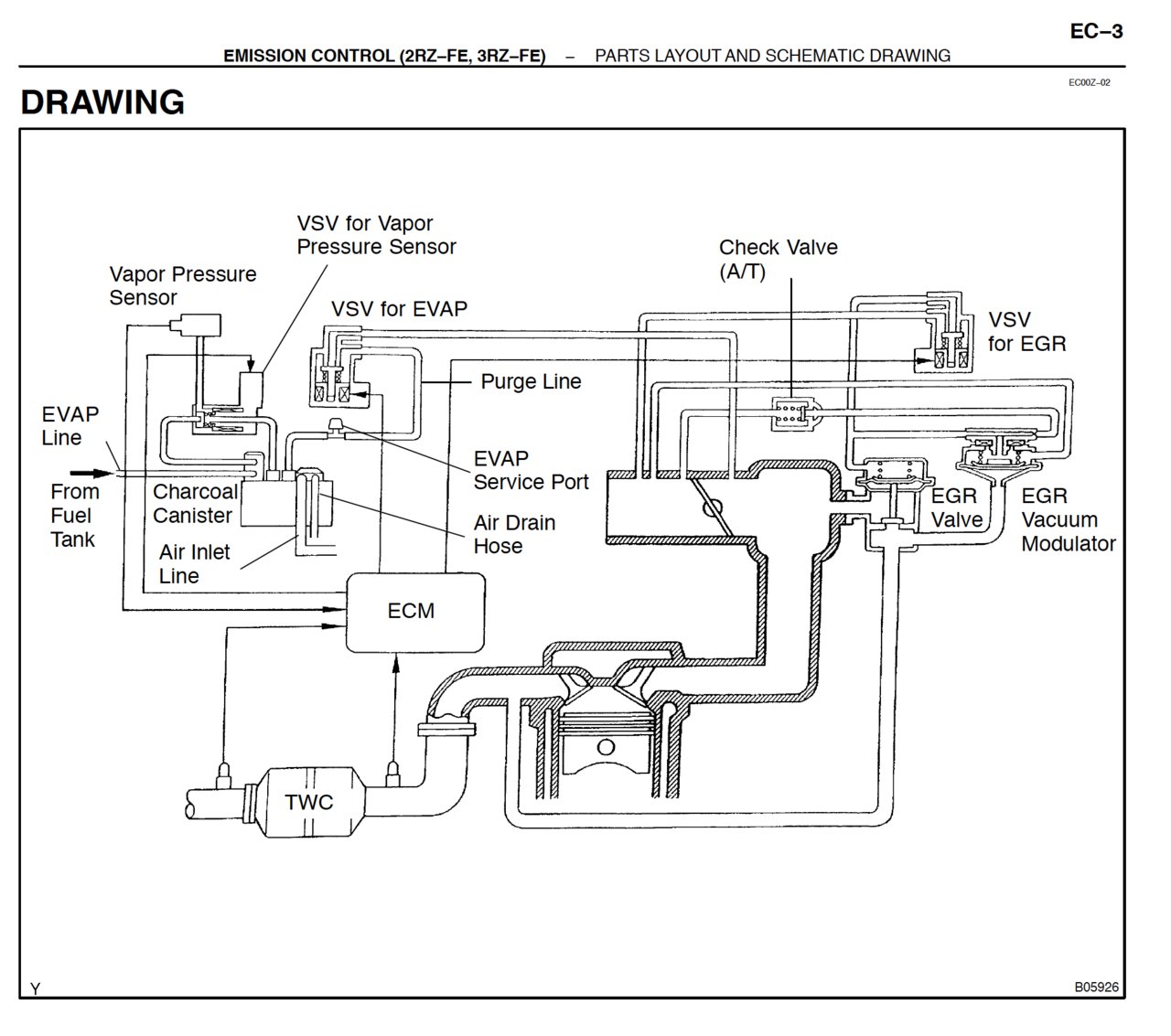

    This should help!
    Screen Shot 2018-07-11 at 4.25.27 PM.jpg Screen Shot 2018-07-11 at 4.25.39 PM.jpg

    So it is a drain hose - lol in the other picture it has it disappearing into nowhere and I guess that's why - I didn't understand the diagram never seeing that callout before! Thanks a lot Noah!

    That's where it purges over pressure when the engine is off.
