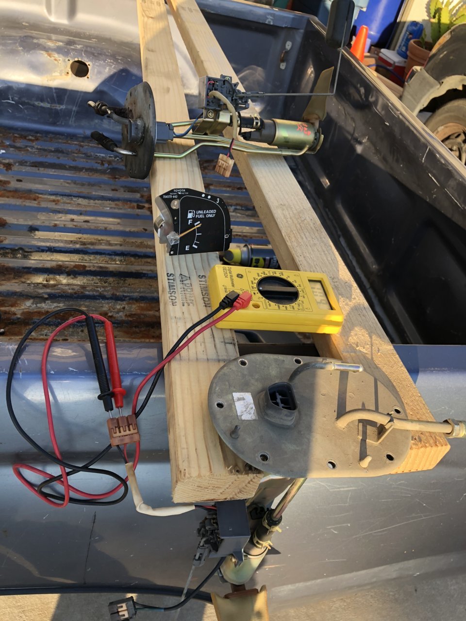

    The fuel gauge in my 5-lug is dead. I suspected a bad fuel sender so I bought a new fuel sending unit from a junkyard. I tested the resistance on both senders against the FSM specs and they’re both fine.

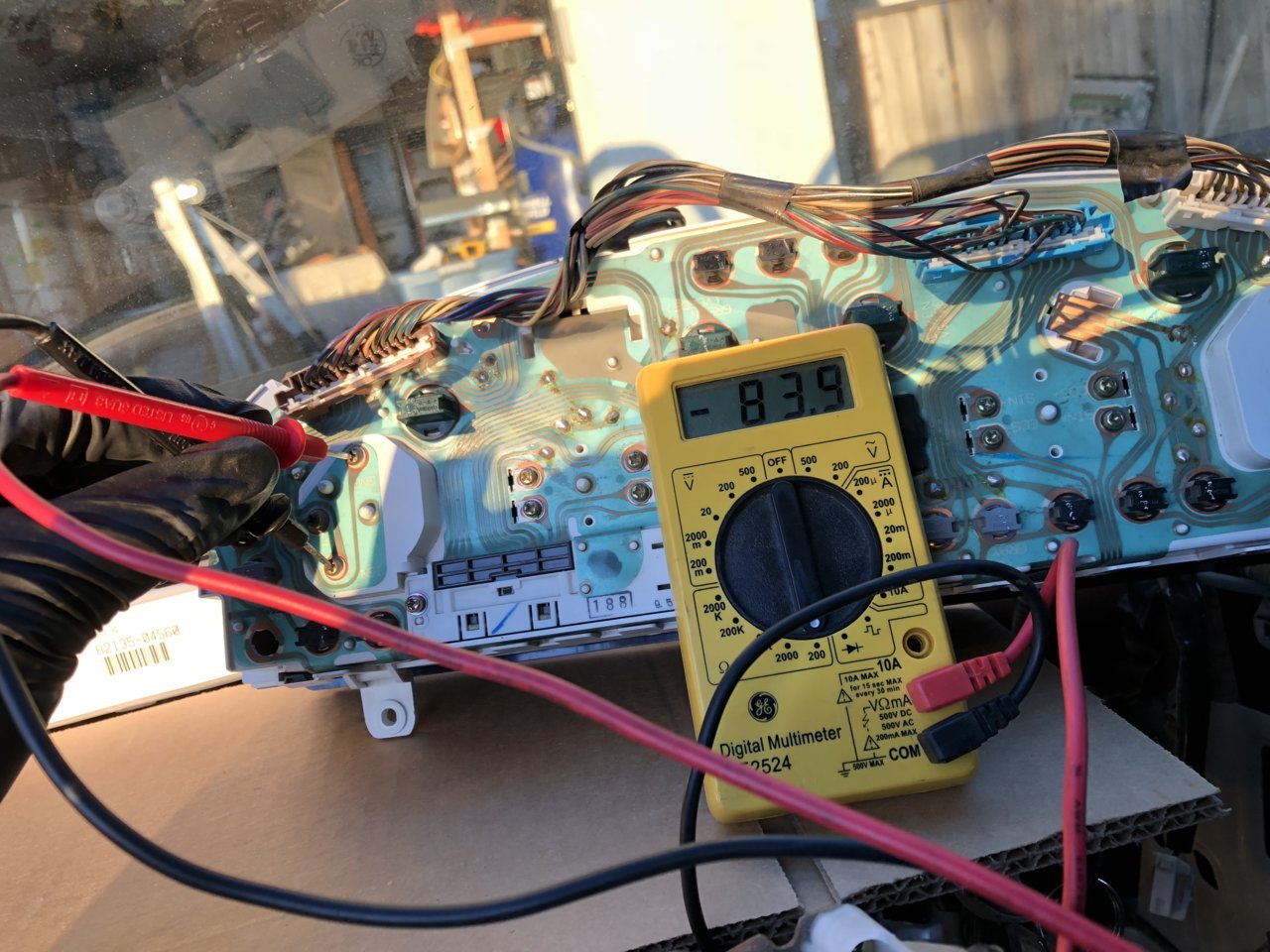

    Now it points me to the fuel gauge itself. I tested the points on the cluster and the resistance values are all wrong. There’s the unlikely culprit - a dead fuel gauge.
    I bought a replacement gas gauge from a 4Runner. However, the resistance is completely different. I can’t use it. Now I either have to buy a new cluster, or find a new fuel gauge.
    The fuel sending unit on the 5-lug is in remarkable shape. The one I bought from pick-n-pull is rusted, dirty, and has a clogged fuel sock. The 5-lug fuel sender with a date code of 1997 looks like it was put in yesterday. Incredible.

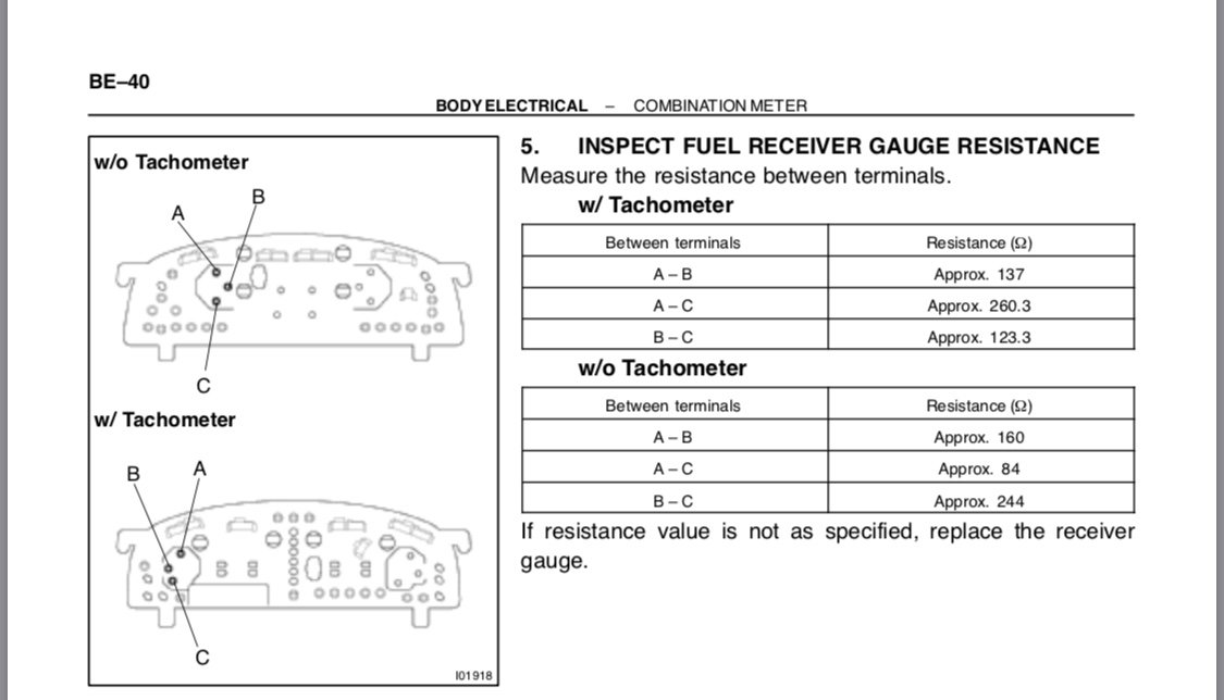

    The value for the gas gauge between points A and C is supposed to be 260.3 Ohms according to the FSM. It’s not. I got a reading of 83.9 Ohms. Therefore the gauge is faulty.

    I have a spare cluster I can pull the fuel gauge from, what're the values supposed to be from the sender.

    Oh man that would be amazing. Here are the correct values:
