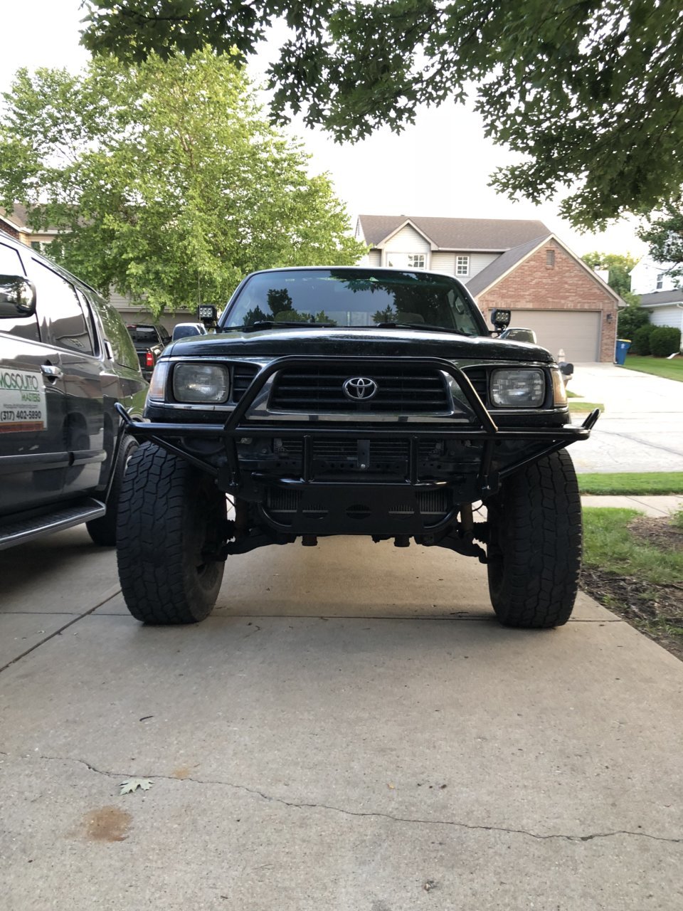

    Some much better pics of the bumper. I had to drill out the factory holes that bolt in on the sides and didn’t think it through enough to realize I’ll only be able to get one of the two bolts in on the either side.

    My all pro bolted up no problem with all the bolts. Why didn’t yours work?

    The two bolts that are on the sides that hold the factory bumper in place were stripped to hell so I had to drill them out and use a larger bolt and nut, I tried to tap them but the tap wasn't biting and there wasn't much room to work.
    Everything lines up perfectly, it's my fault I can't get the nut on the backside because it's almost completely boxed in back there. I may be able to get a longer bolt which might help give me a bit of room to slip the nut on the back side, my fear with doing that is ever taking the bumper off though.

    I guess it would be possible to notch the factory radiator bushing mount to gain some clearance for a wrench back there :sawzall:

    Did you use the all the factory bolts on yours? It seems like the ones that would be used to hold the factory tow hook on would be way to long if you don't reuse the tow hook. Did you reuse the tow hook? Sorry for the spew of questions, just kinda popped up in my head.

    I didn’t reuse my tow hook. But all the bolts fit just fine. Minus the ones that go into the front of my bumper the head was smaller then the hole on the bumper so i had to find some washers to make it work.
