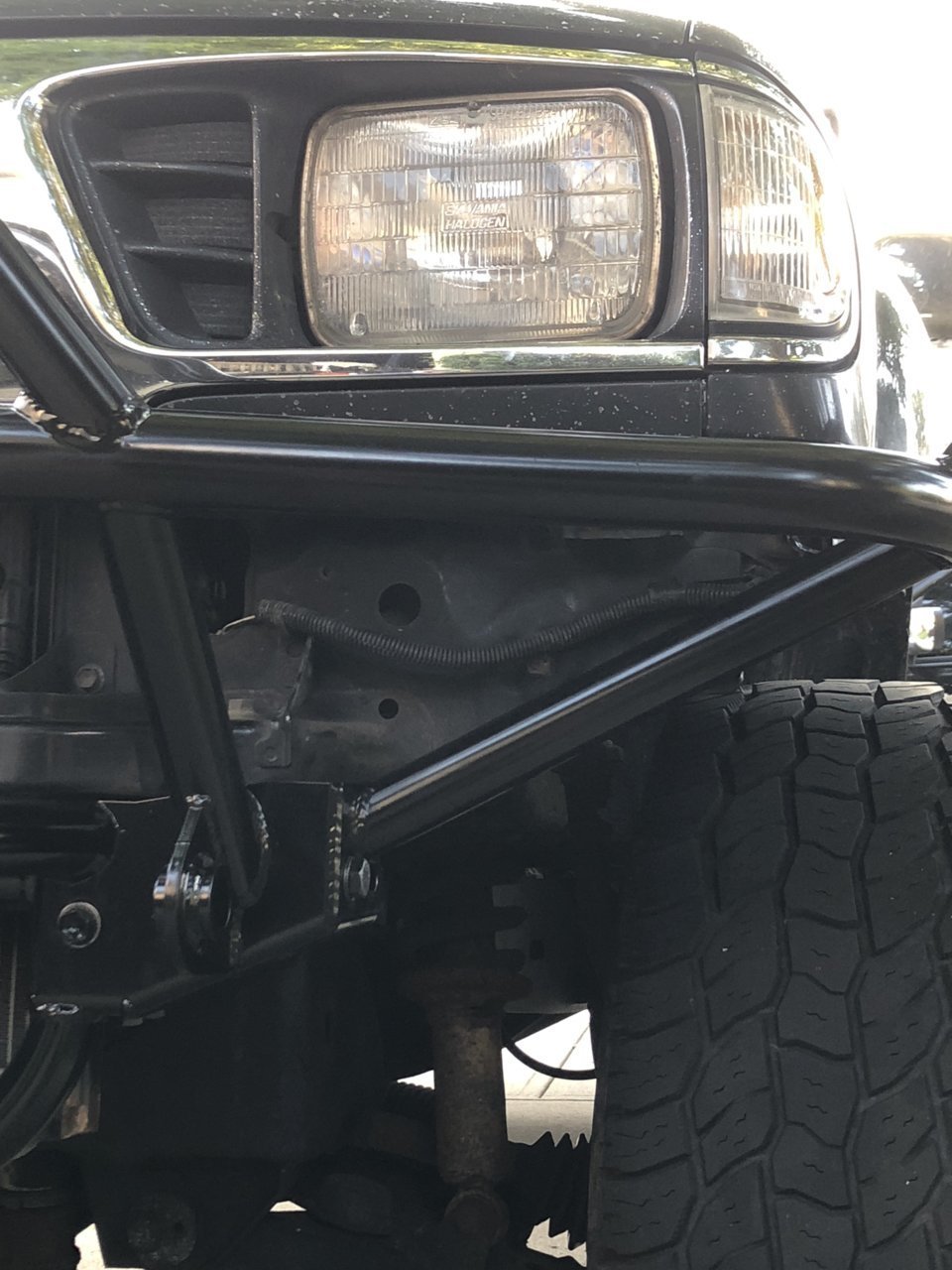

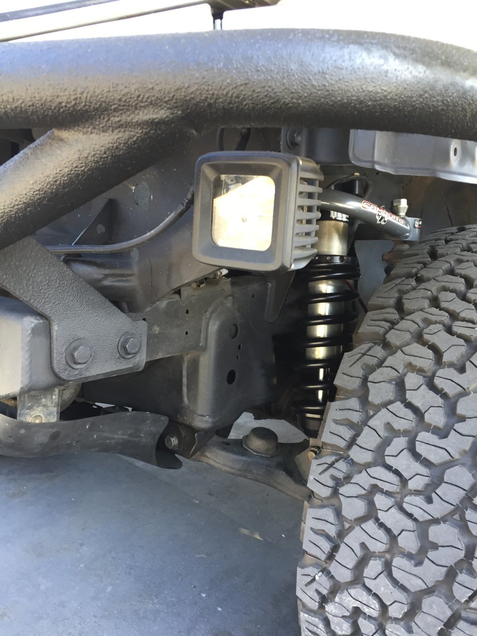

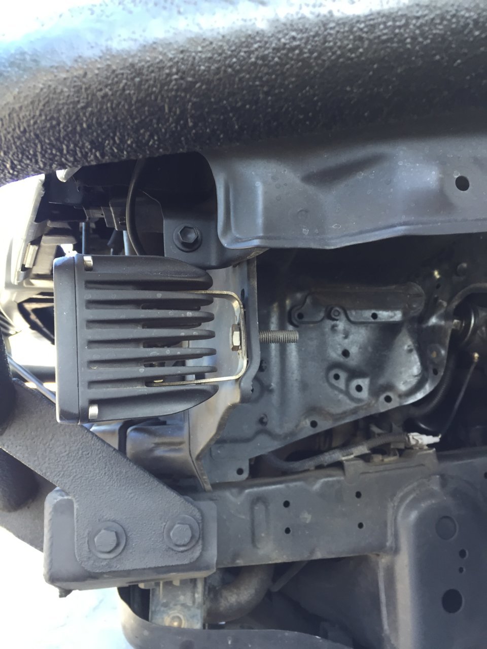

    I installed my pods onto the sheet metal right here. Didn’t have to change anything. They mounted right up with supplied hardware. Really easy.

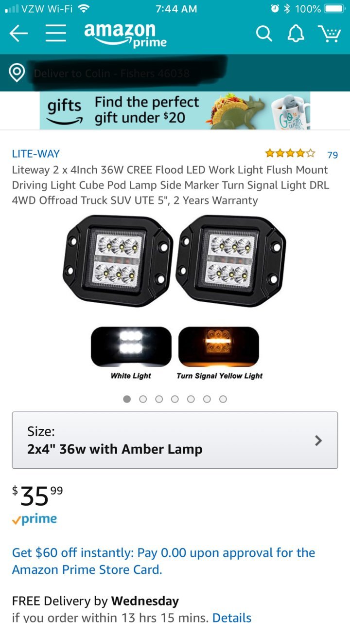

    That is the other option I was looking at, I am going to be using mine as turn signals but when I saw those I thought they look good as fogs/DRLS as well

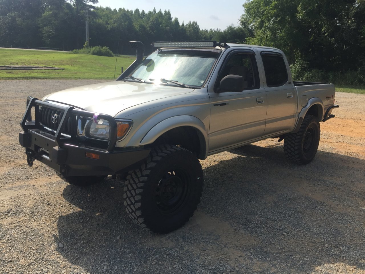

    42 inch light bar, ARB bumper, snorkel,rear trail gear bumper, Frankenstein’s rear leafs,
    Great no problems at all

    How much do those weigh?
    Seems like that spot could be prone fatigue if they are at all hefty. It is sheet metal after all.

    Thats spots pretty ridget and tbose dont way all they much. But thas being said if he is doing alot of off road he should probably reenforce that spot because thats pretty thin metal

    Yeah its thin there but seems pretty solid, I doubt it would bend it if you used washers and spread the load out a bit. It is a concern of mine though and thats why I kinda liked the idea of the flush mounted ones.

    I've spent a lot of time rebuilding these trucks. I don't think I would be comfortable bolting these to that sheet metal.
    If you did little wheeling, then it would most likely be fine.

    Add big fender washers!

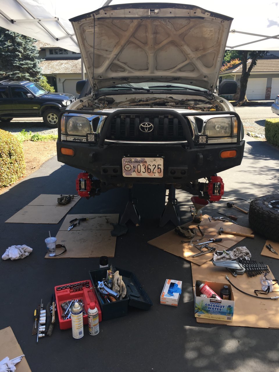

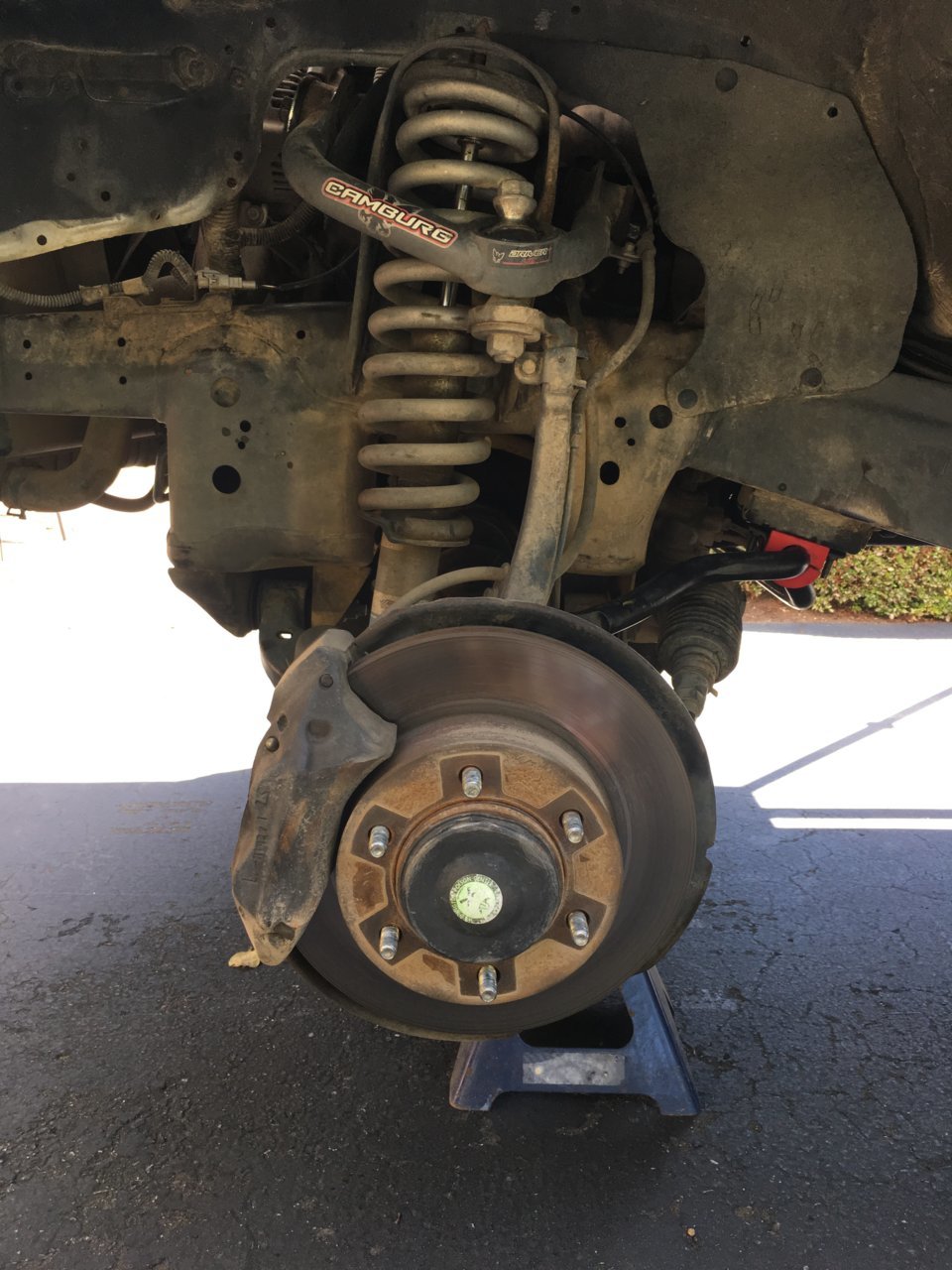

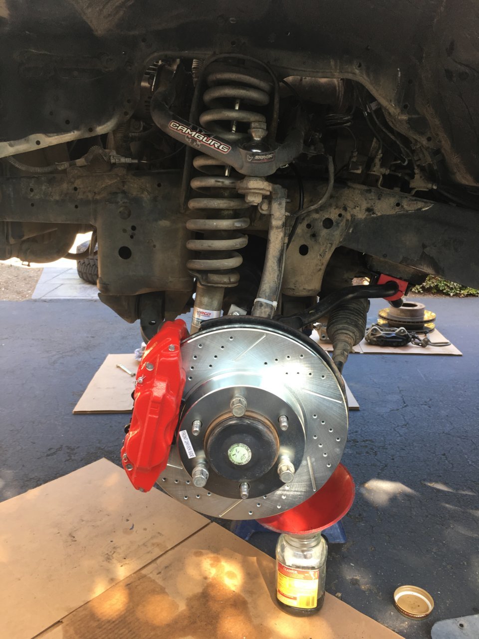

    Installed Tundra Brakes and SS lines:
    Tundra Brake from Amazon via Callahan (drilled and slotted rotors, red painted calipers, some sort of pads)
    LCE SS lines with 3" extension
    The major P.I.T.A was the connection between the hardline (at the frame) and the softline -> super cramped area to get tab out and then disconnect the hardline 10MM.
    The 10MM wrench was NOT a crow's foot type of flange wrench so wrench/nut contact points were not good. Correct tool(s) are important.
    old crap:
    mid deliciousness:
    sweetness!
