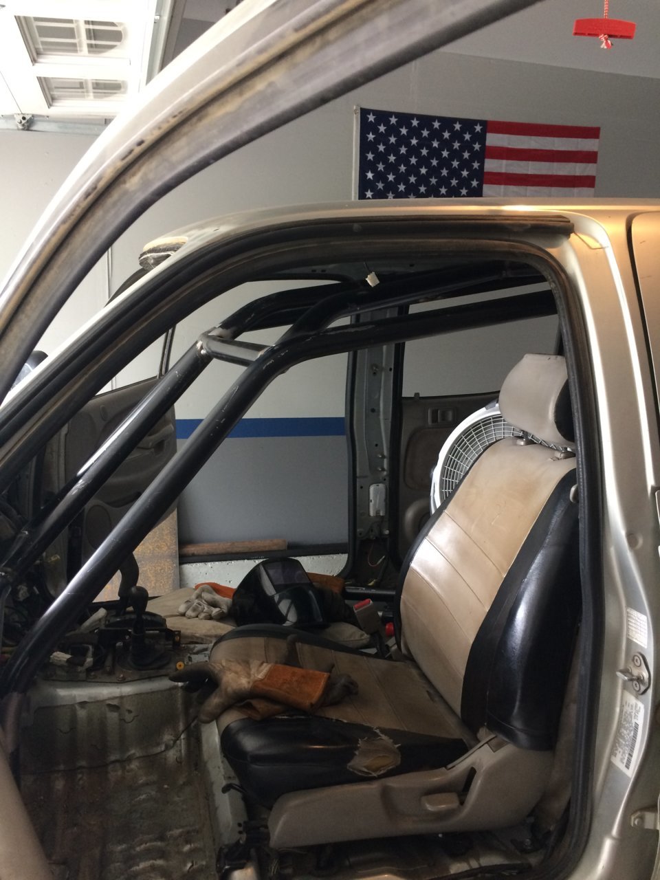

    Hummm ok yeah I’ll have to reconnect everything. Truck is in pieces.

    Its the company truck
    That roll bar might be in your Perfield vision a tad bit

    Not when I’m wearing these.
