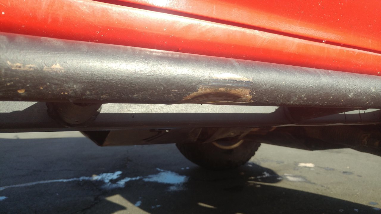

    Inspection revealed a nice dent in my driver's side large main tube underneath the door. I have no idea if that tube is HREW or not.

    Your sliders are also 1.5" tubing with no scab plates.... and yes I wanna watch the dummy's head fly right into the camera

    This happened to mine on a trail out here a few months back....came down hard on the passenger side and I had my friend with me who's a big dude riding shotgun (6'3" ~300 lbs)
    Mine are HREW and welded to the frame for what it's worth

    Yeah I’ve seen that video. It’s a good example. Shot I’m even using HREW in my bed cage for the tire carrier and in the engine cage. I’m only using DOM in the main parts.
