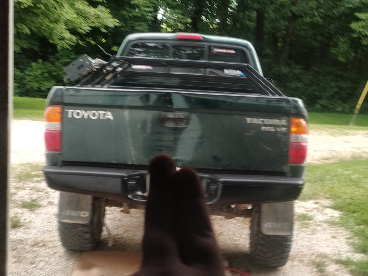

    what road
    Jan 28, 2014
    #121762
    22,855
    Dallas
    Indiana
    2001 tacoma sr5 trd
    alot still need done
    way new bumper is on. my ears hurt from the impact lol
    BYJOSHCOOK and Sperrunner like this.
