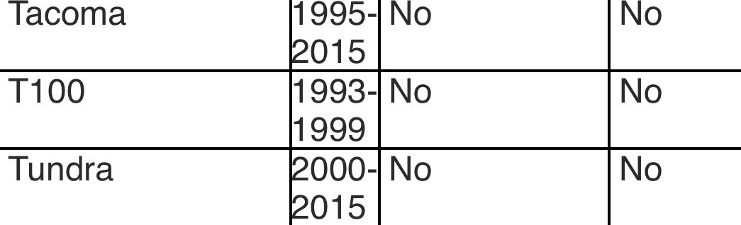

    You’re right I was thinking of Automatic for the oil pump. If it’s splash lubricated, what’s the issue with flat towing?
    I read a lot of threads on Google on other forums asking about flat towing a 1st Gen. A lot of them say no, it is not advisable and will cause damage to your transmission.

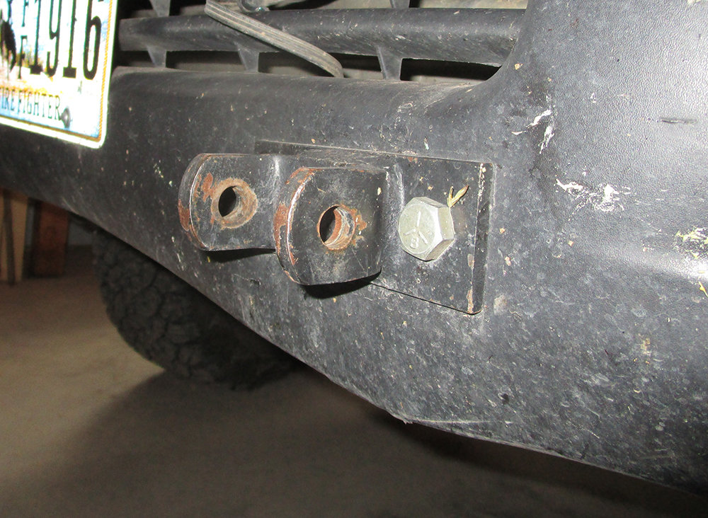

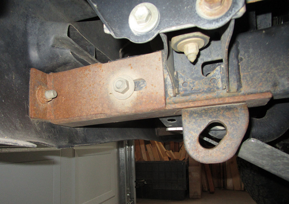

    I use one of these: https://www.northerntool.com/shop/tools/product_200514171_200514171
    I had a guy make some extensions off the front of my frame to attach it to. Here are a couple of photos that show the part he made:

    Fascinating. Other bolt on options I’ve seen run in the sub $1000 range. How much did you pay?

    I can't remember how much the guy charged me to make the extensions, that was 17 years ago. I know I paid less than $100 for the tow bar. The one I linked to is only $89.99 and it's the exact one I have been using for all these years.
