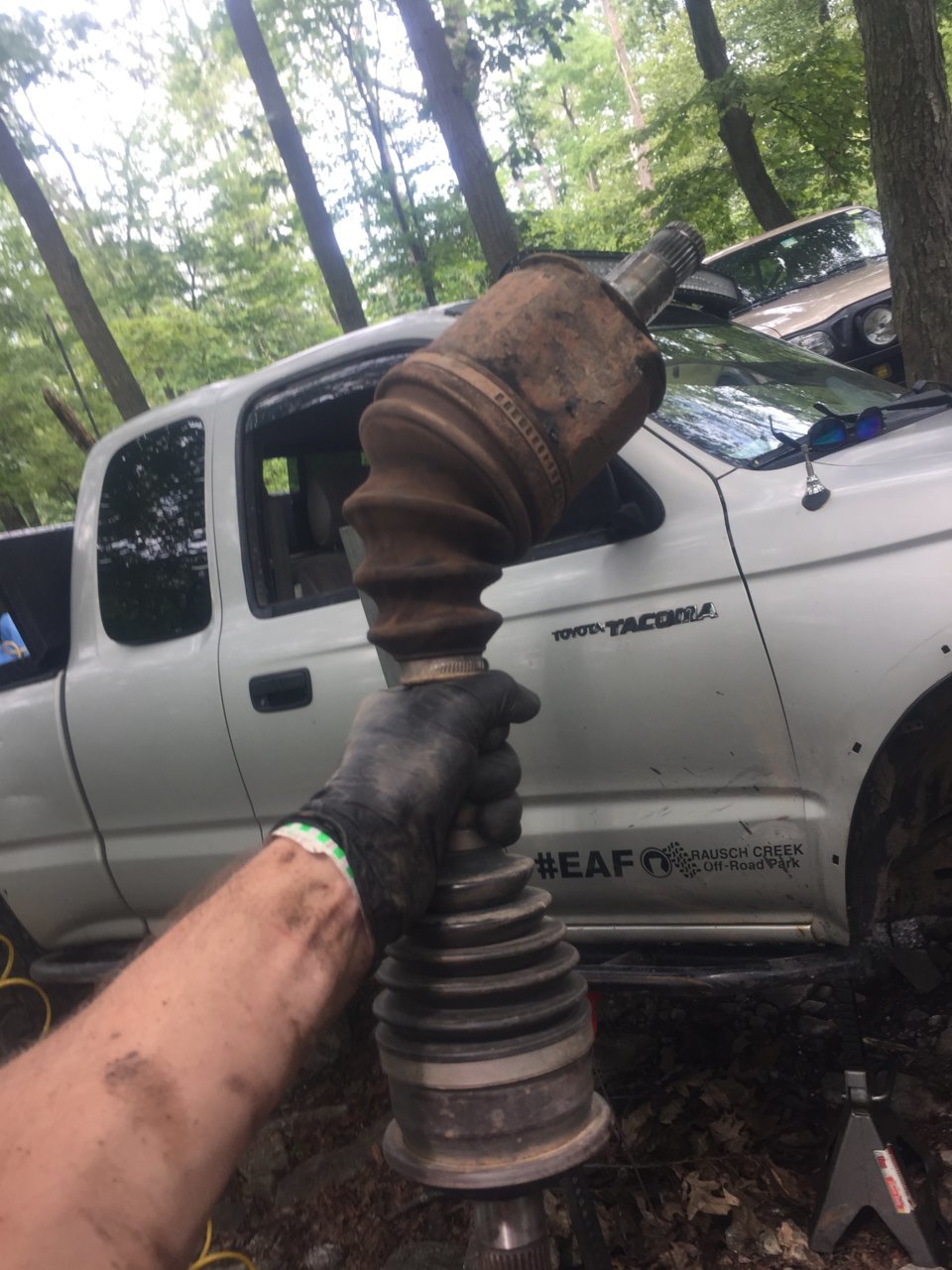

    Drop bracket lift and booger welds
    Broke a thing, then fixed it and broke another thing the next day. :anonymous:
    The place I broke my second thing on (and subsequently did not make the obstacle) I watched a built bronco roll on HARD minutes later.
    jubei, Prayn4surf, ClevSix and 6 others like this.

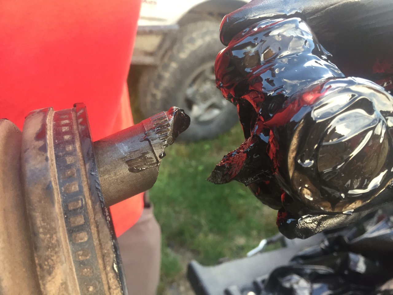

    That's exactly how my passenger side CV looked when it busted on me. Broke the inner joint...could still drive it just fine as long as I was in 2wd. In 4x4 it felt and sounded like I was driving over potholes.

    Same but the outer joint... Mine clunked around like crazy though

    That's what I was expecting to happen since I have ADD as well, but when I disengaged 4wd the clunking went away and I could drive around seemingly like normal. Figured it was because the joint connected to the wheel was still intact, I guess

    Yeah not exactly sure what other thing I broke. Passenger side is def disconnected now but the CV looks fine, so the current working theory is something in the ADD tube blew. The snap was much quieter than when this CV went.

    Could be either the shift fork broke/ seized, or.......
    You broke this guy.

    ouch, damn I must have gotten lucky then. I was telling someone about it and they told me that the inner joint rarely fails, it's usually the outer joint and that I may have broken something else. But that was 6 months ago and after replacing the CV it's been fine, so I guess I somehow managed to actually only blow the inner joint.
    Happened when I turned into a gas station and forgot to switch 4hi off...the roads were covered in ice up in the mountains but the gas station was covered and had dry concrete. Won't make that mistake again
