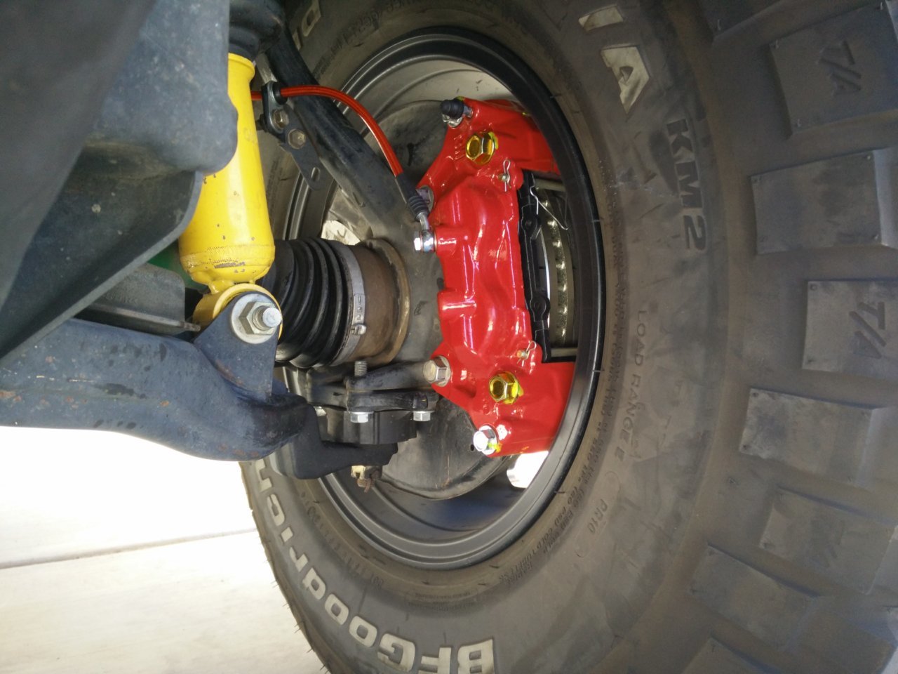

    Will scs f5's 16" 3.5bs fit over tundra brakes? the 13wl calipers

    All SCS will work with all Toyota Trucks as long as they fit the corresponding lug pattern

    Yes.

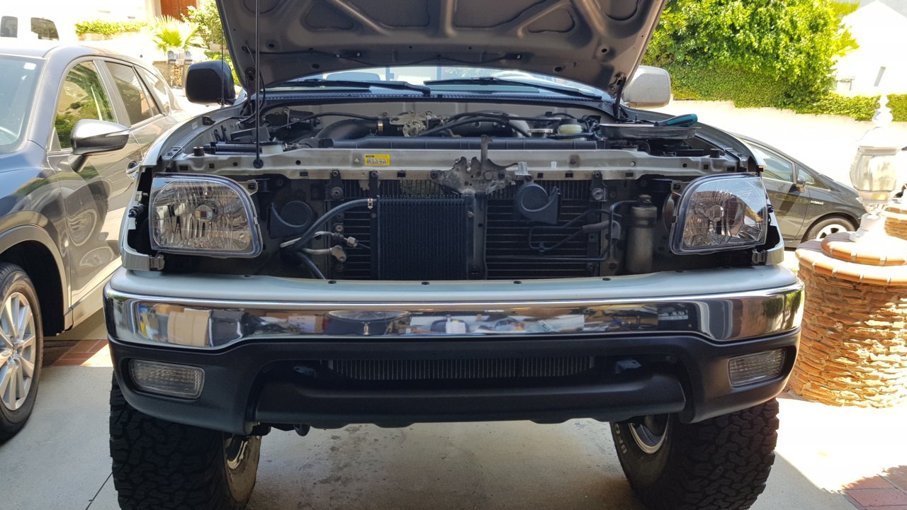

    Replaced headlights & battery terminals. Since I was going to have the grill off I replaced the trans oil cooler hoses too (one of them was starting to show cracks)

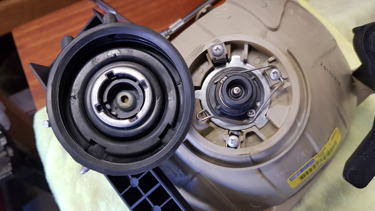

    The HL grommets that came with the new aftermarket lights are much better than what I was using for my HIDs. HLs would always fog up anytime I drove through a flooded road or wash my engine bay. Of course I still had to modify them but these seal nice & tight over my igniters where my old ones didn't do shit.

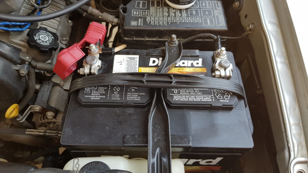

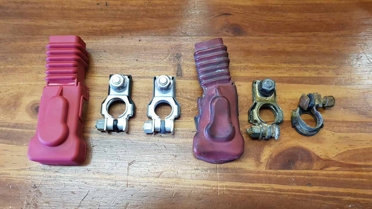

    Don't know which Toyota the neg terminal comes off of but I had to cut the old one & modify it to work. Can't buy a stock replacement terminal, have to buy the entire ground harness. Like this one much better. My stock were so corroded the pos terminal was about to fall apart. I thought about getting some nice aftermarket ones from a audio shop but whatever, bought these on sale.

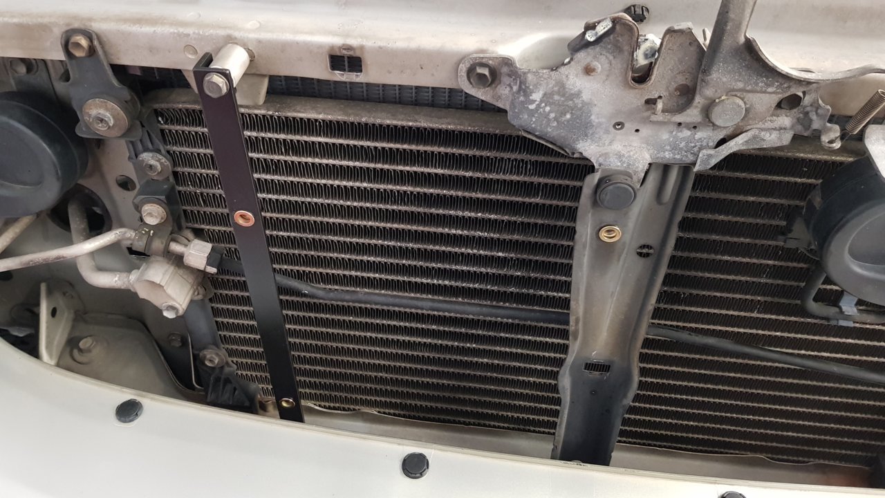

    Since I have a rivet nut gun now, I installed nutserts for my trans oil cooler, no more having to fumble with nuts on the backside.
