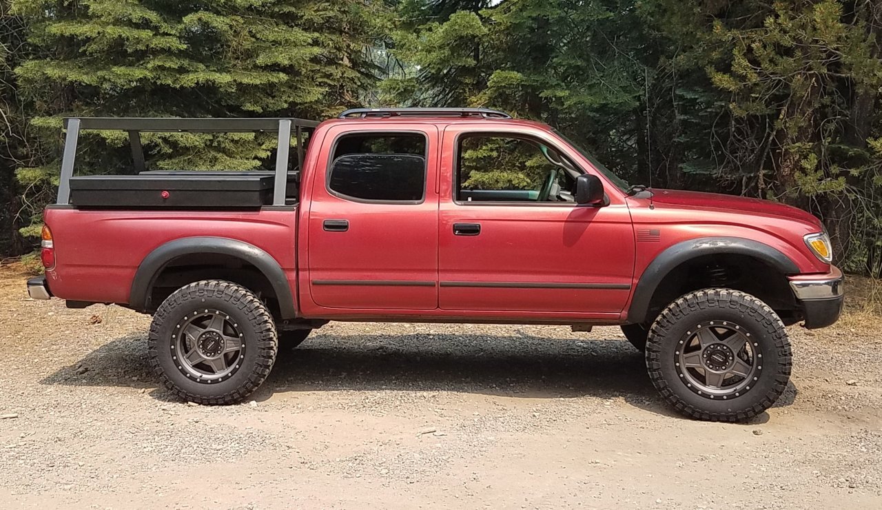

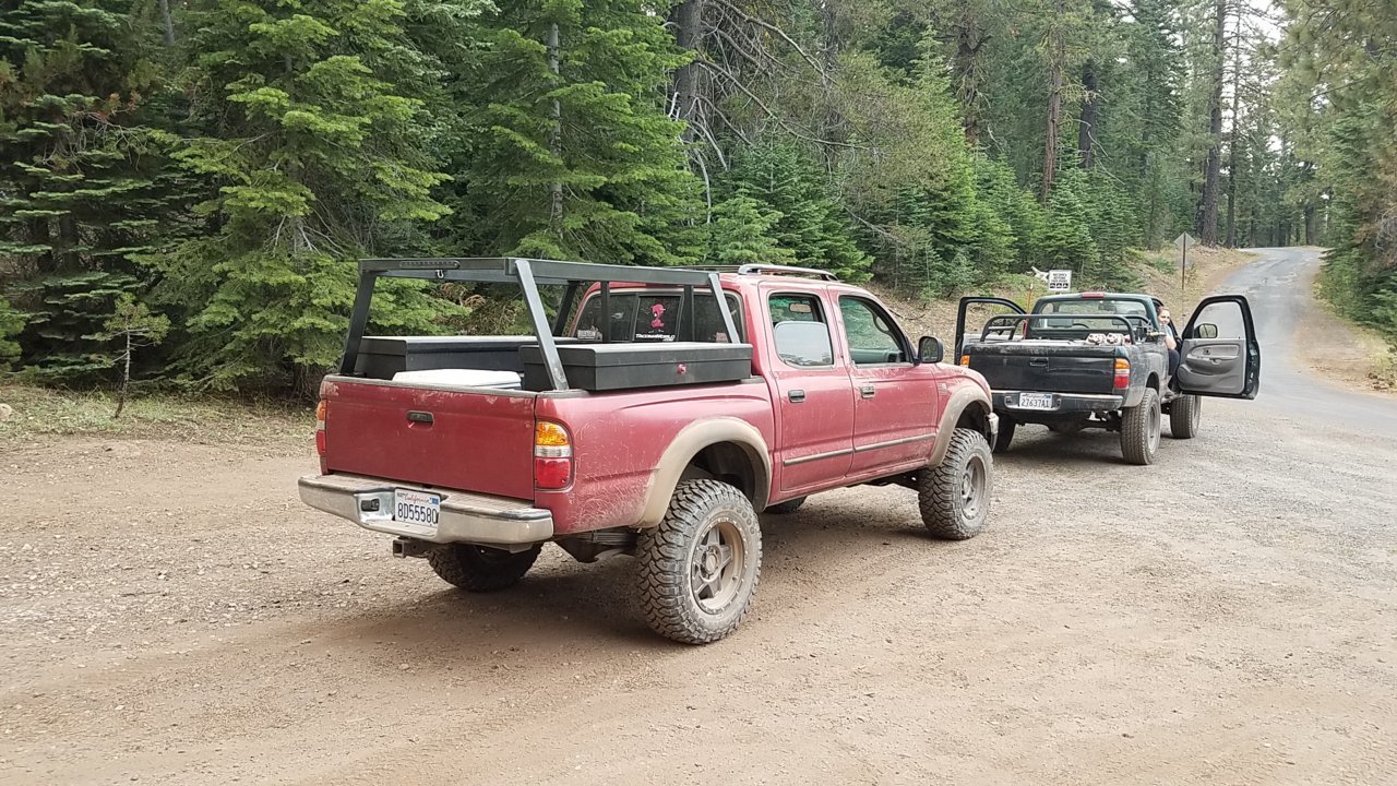

    I aleady have the same setup on my truck. I've been running a borrowed set from @FirstTimeFirstGen heres some pics.

    You can see I don't have a bumper or winch (yet). But I LOVE the way they ride. Doesn't ride like a Cadillac... but it's not a Cadillac.
