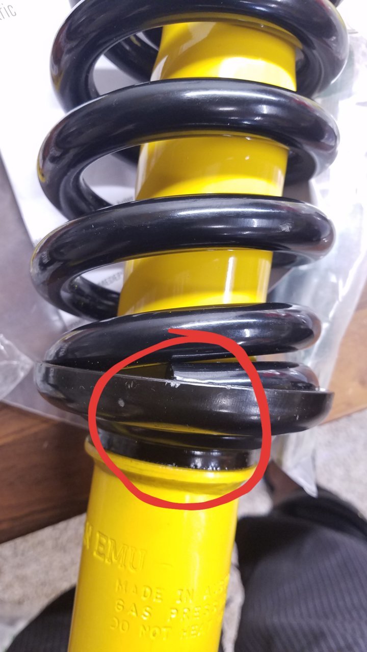

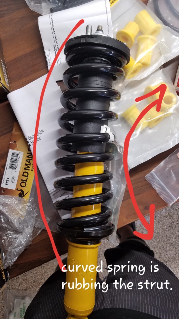

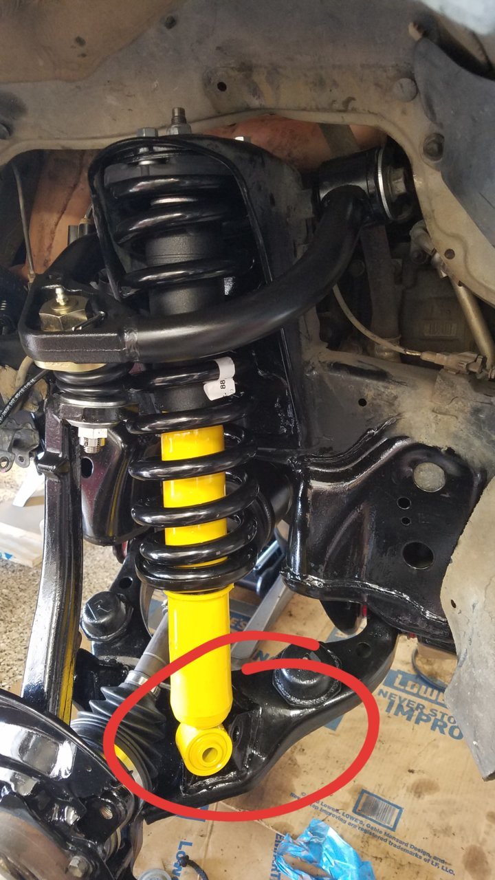

    this is why i bought my own spring compressor... i cant trust people for stuff like this, you can probably rent a spring compressor from auto zone, compress the spring to where you can rotate the shock and get it in the right position.

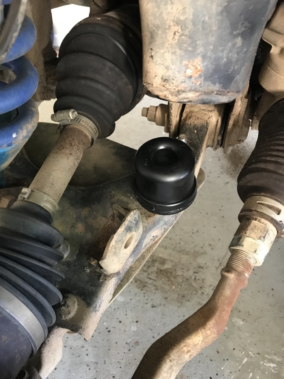

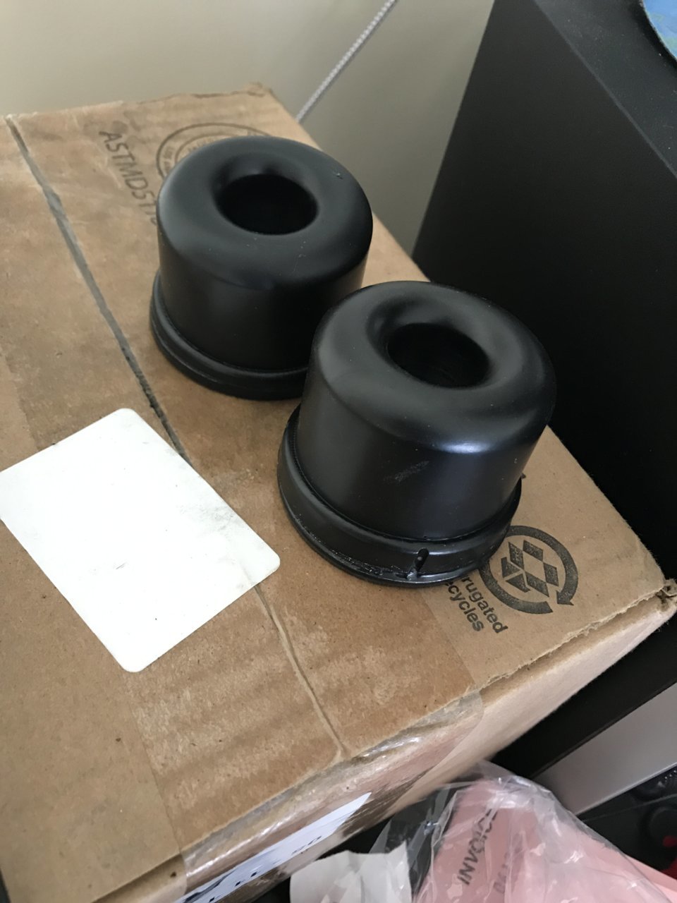

    Installed my new bumps yesterday. Now just to go use them!

    I'm brand less... o_O I make them at my house in the good ol' State of Arizona. Just a small time forum member offering something back to my friends. My girlfriend made me a very nice website so I can look big :). The current version bump stops were a collaboration of 50+ forum members personal input as well as applied industry knowledge. Its been really cool having everyone's help, I have made several new friends from engineers, a crazy Chemist, to stay at home dads that have no way to go out and wheel so they just read about wheeling on the forums collecting knowledge (getting ready for that "one day") and on and on. Plus I personally am a plastics and rubber guy with a background in rapid prototyping. We have a very good product that has made a huge wave in the small world of bump stops. there is no other bump stop on the market short of hydro/gas bumps that even comes close.
    I am familiar with issues of the center hole filling with debris with other brands, Unfortunately the center hole is a necessary evil because it allows for mounting of the bump stops with out the need of welding. With our design we did our best to try to eliminate any potential issues such as
    - All of my bump stops mount using JIS 10.9 Flange bolts with 14mm hex head. No Allen head to fill with dirt.
    - When the bump stop makes full contact with the strike plate material/mud can still be squeezed out of the cavity. Any dry material in theory would fly/jump out as the LCA cycles. the bump stops rubber is slightly angled to help address this concern.
    - Should sand, mud, gravel remain in the cavity the rubber material used to build these bump stops is stronger than any foam. My bump stops can take a ton of abuse. I just posted a video showing one of my front bump stops in action check it out; toyotabumpstops.com

    +1 for @Plastics Guy bumps...I haven't gotten to really test mine out yet but according to the strike plate they've seen some compression already and I haven't noticed it one bit...which is a good thing.

    Yup @Plastics Guy is the “brand” so far the best option out there for first gens that I know of.
