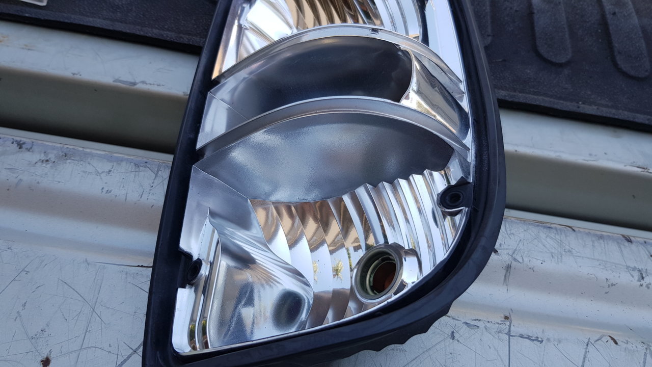

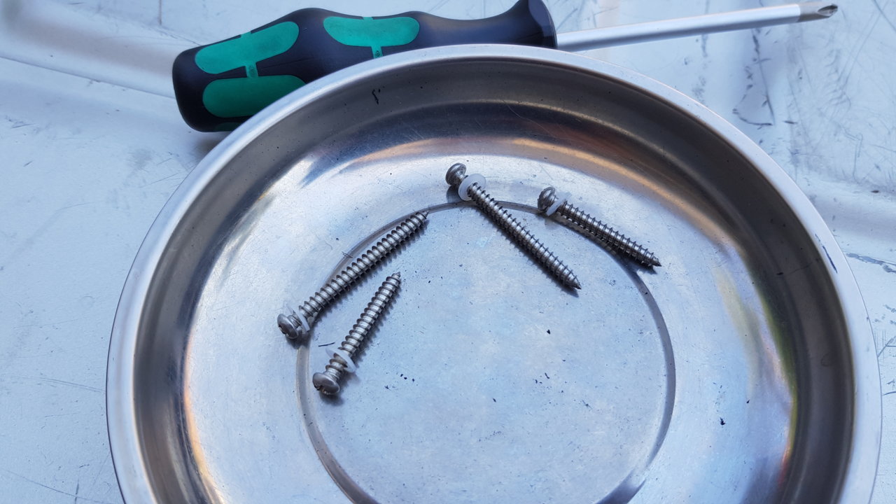

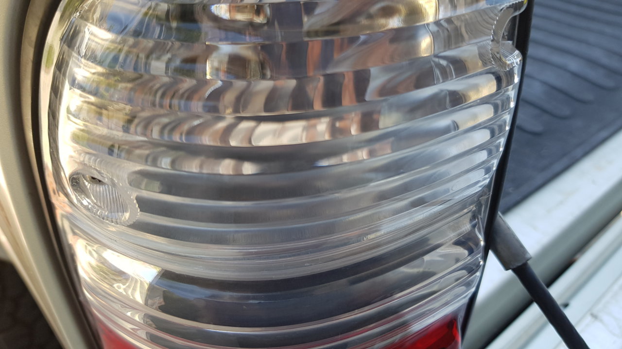

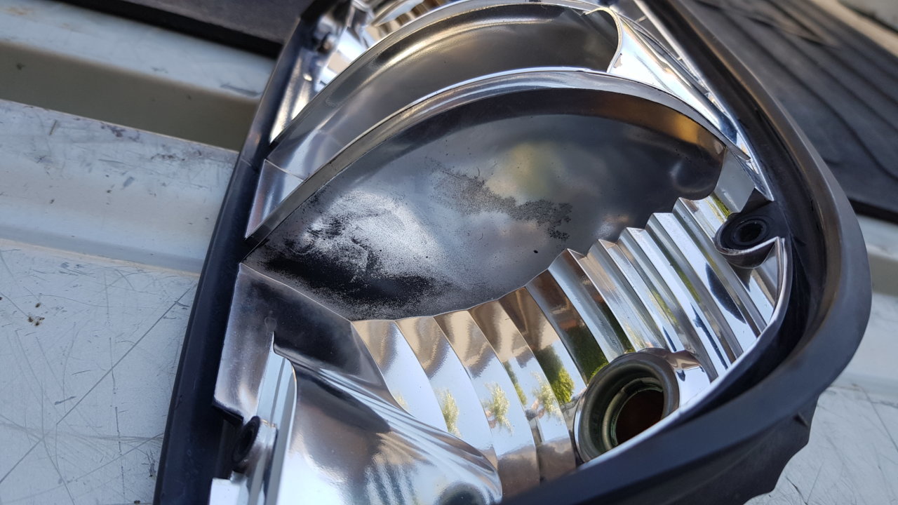

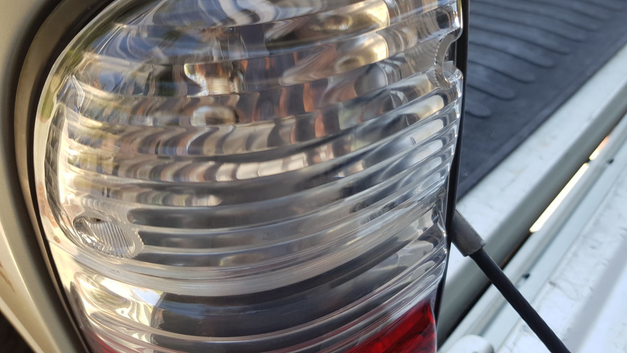

    I noticed my left tail light had dirt inside & I could see black, reflective coating was wearing away. Opened it up & it was pretty dirty. Washed out the dirt but still some of the reflective coating was gone. Looks like it's been like that for a while.
    Turns out the plastic washers on the screws were disintegrated & caused the loose sealing. Well Toyota doesn't sell the housing seperately & none of my local junkyards had a good one or would sell me just the housing. I have 2 sets of aftermarket housings laying around but for some reason they cause different weird issues when either one or both are plugged in. Didn't feel like troubleshooting to rewire them.
    Used some "chrome" rattle can & lightly dusted the area. Would've came out better if I layed a nice final wet coat but I didn't want to cover any of the stock reflective coating as much as possible. Plus you can't mask off with tape on the reflective coating, tape will peel the coating off. Decent results to hold me over until I find a stock replacement housing someday.
    Also put on some new nylon washers & will order new lens gaskets tomorrow. I flipped my gaskets in the meantime. So if you haven't already, check the plastic washers on your screws & your lens gaskets.

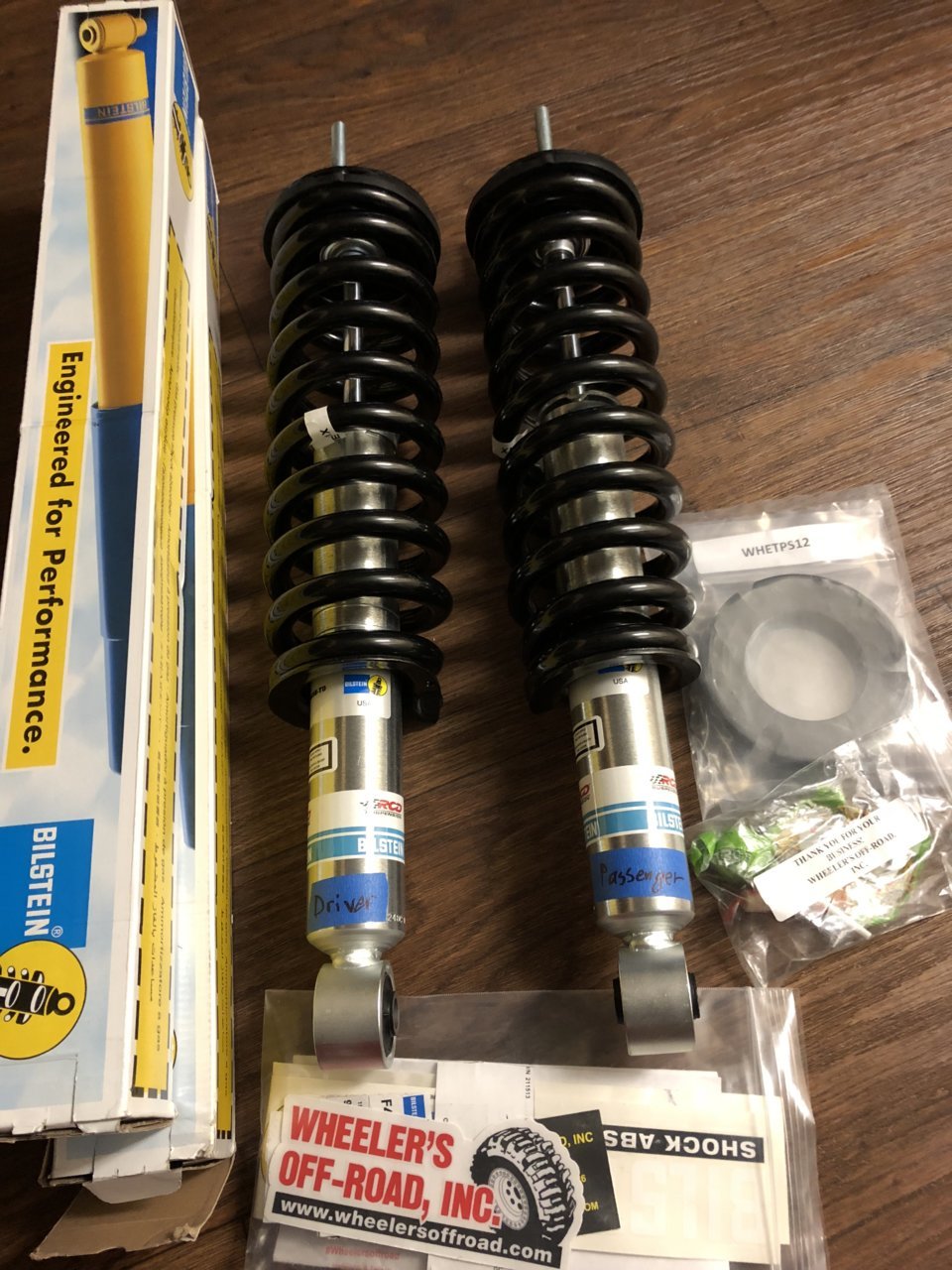

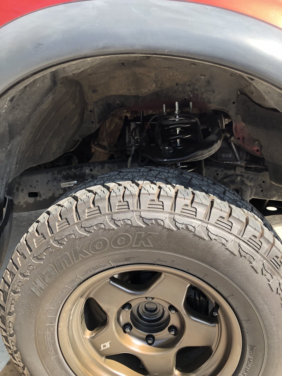

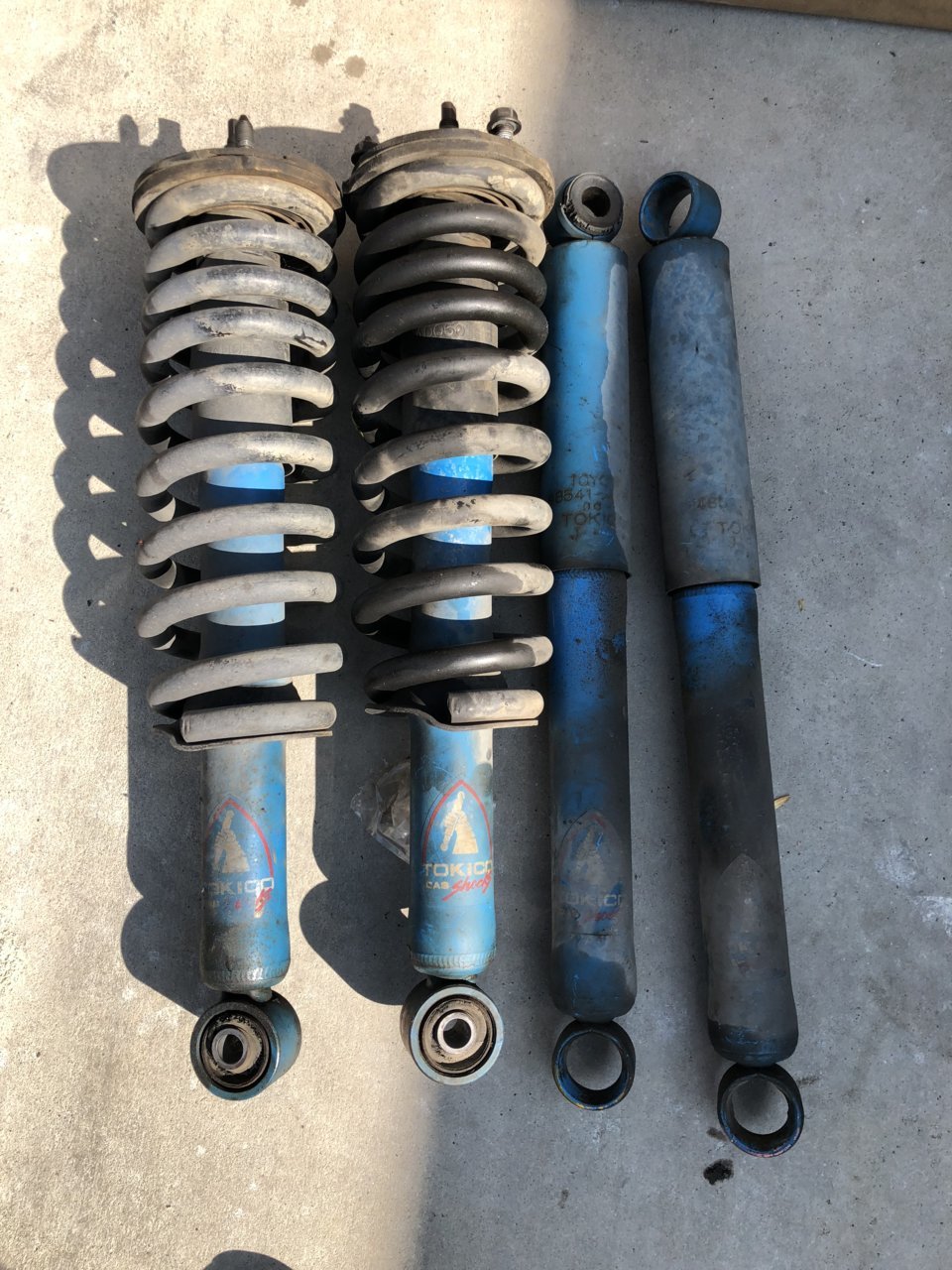

    Out the old tokicos and in the new 5100's with 881' way to much lift IMO hopping the go down icon 3 aal progresive is next for the back .

    Those are 881s? No way...something isn't right. 881s shouldn't give more than 2", that looks higher than 3"

    Yeap 881's i saw the sticker on the coils and yes i got more them 3" inch lift i also have 1/2 top plate spacer on driver side an 3/8 on the passenger side .

    Like half inch spacer? That’s giving you like a 1” lift right there

    Yea man 1/2 spacer on driver side and 3/8 spacer on pass side the rig sits at 39" from ground to fender event both sides
