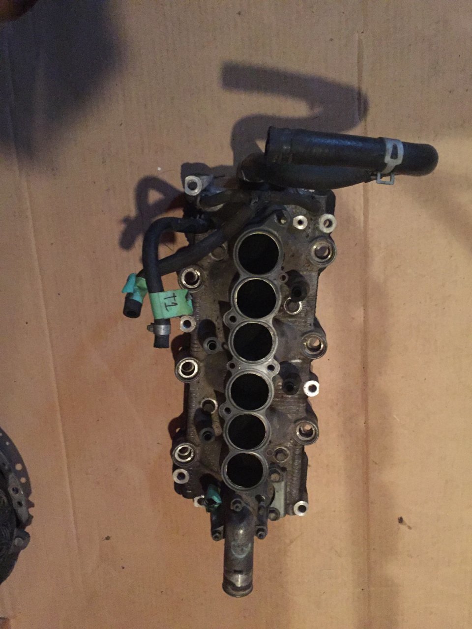

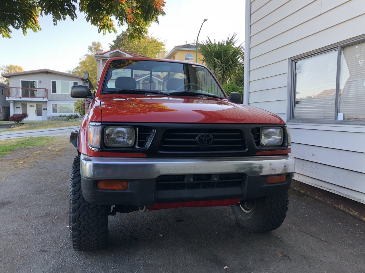

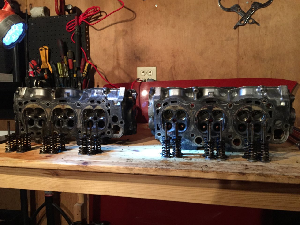

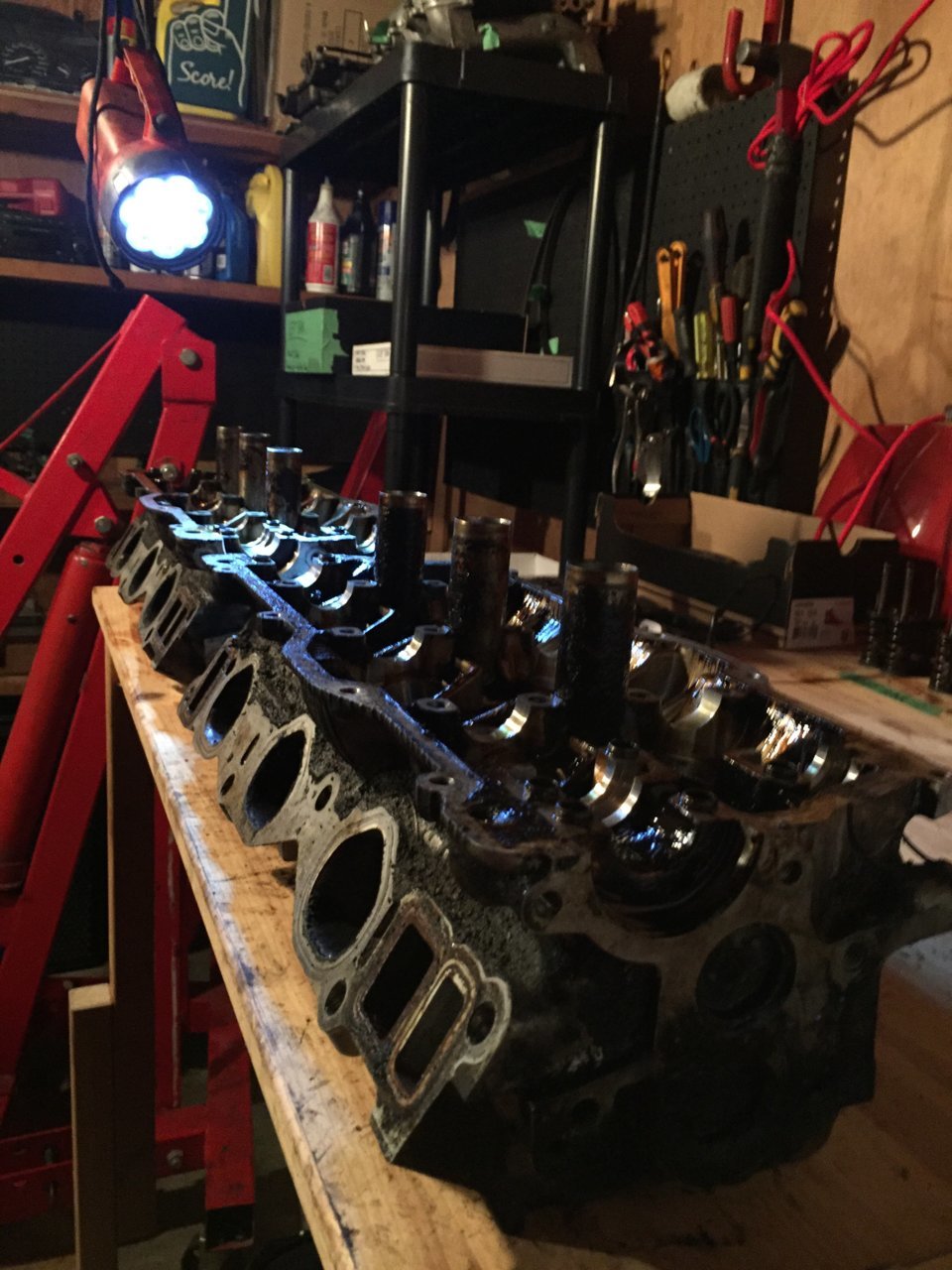

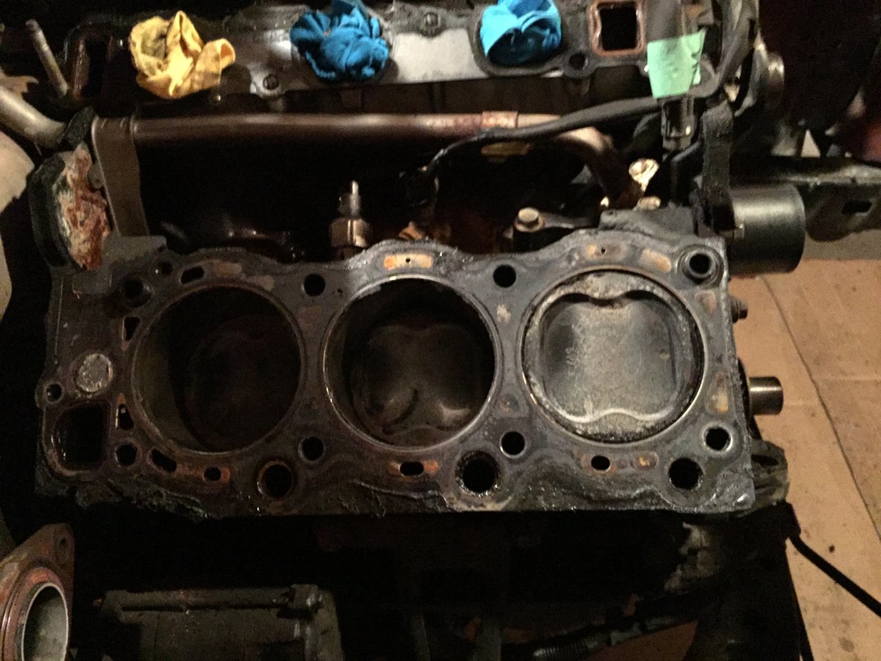

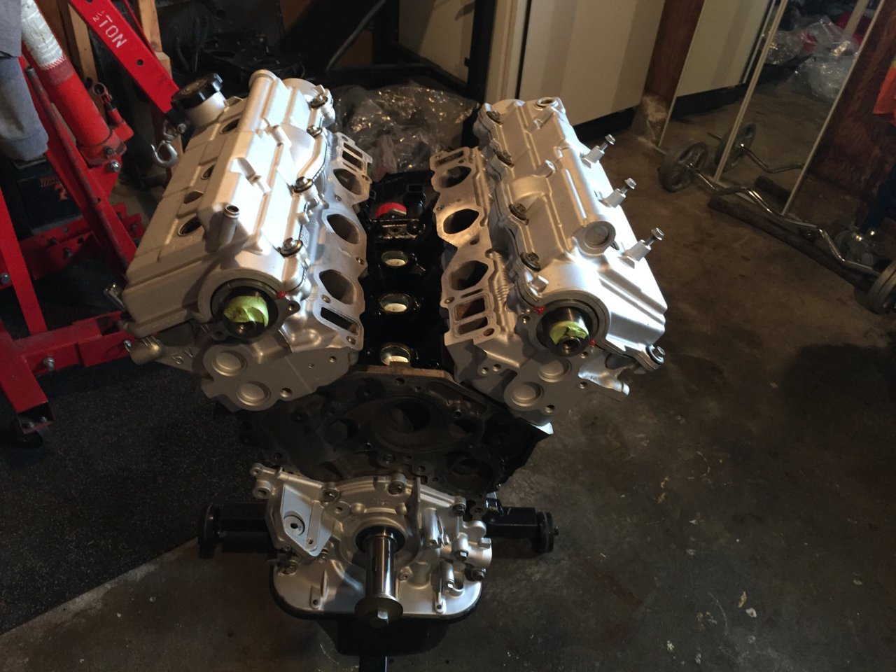

    What’s up fam?

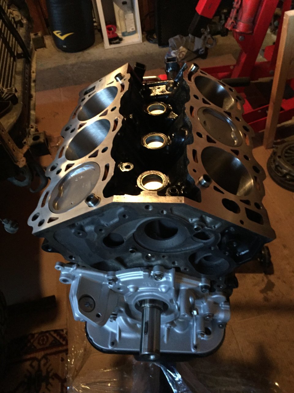

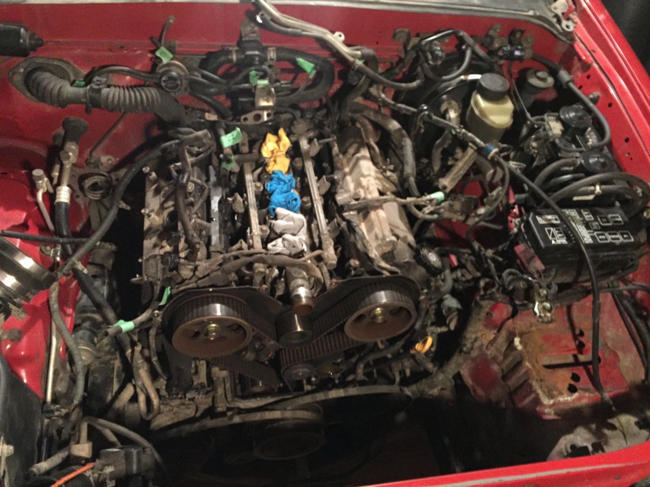

    Just want to share all the work I put into my ‘96 Taco it took me half a year to do this type of big job and it’s also my first time working on a 6 banger 4x4 project. It turned out to be ok.. but I went through a lot of work.. I put in blood, sweat, and tears, on this big project... I was spending a few hours every weekend working on it.. Honestly, there was a time I was gonna give up on it but I just pushed it through faced the obstacles and by having faith to myself it turned out to be alright.. I’ve just done my first 500 miles break in I changed the oil and filter right away, no leaks, engine running smooth, no knocking sound, shifting smooth, no more white smoke, no more rubber gunky smelly coming out from the exhaust..

    Nice! you've got a rare taco there too. Love my v6 single cab. Great job.
    JM_604[QUOTED] likes this.

    It a clean ride bro.

    Thanks fam! I appreciate the love.

    Thanks bro! I appreciate the love.

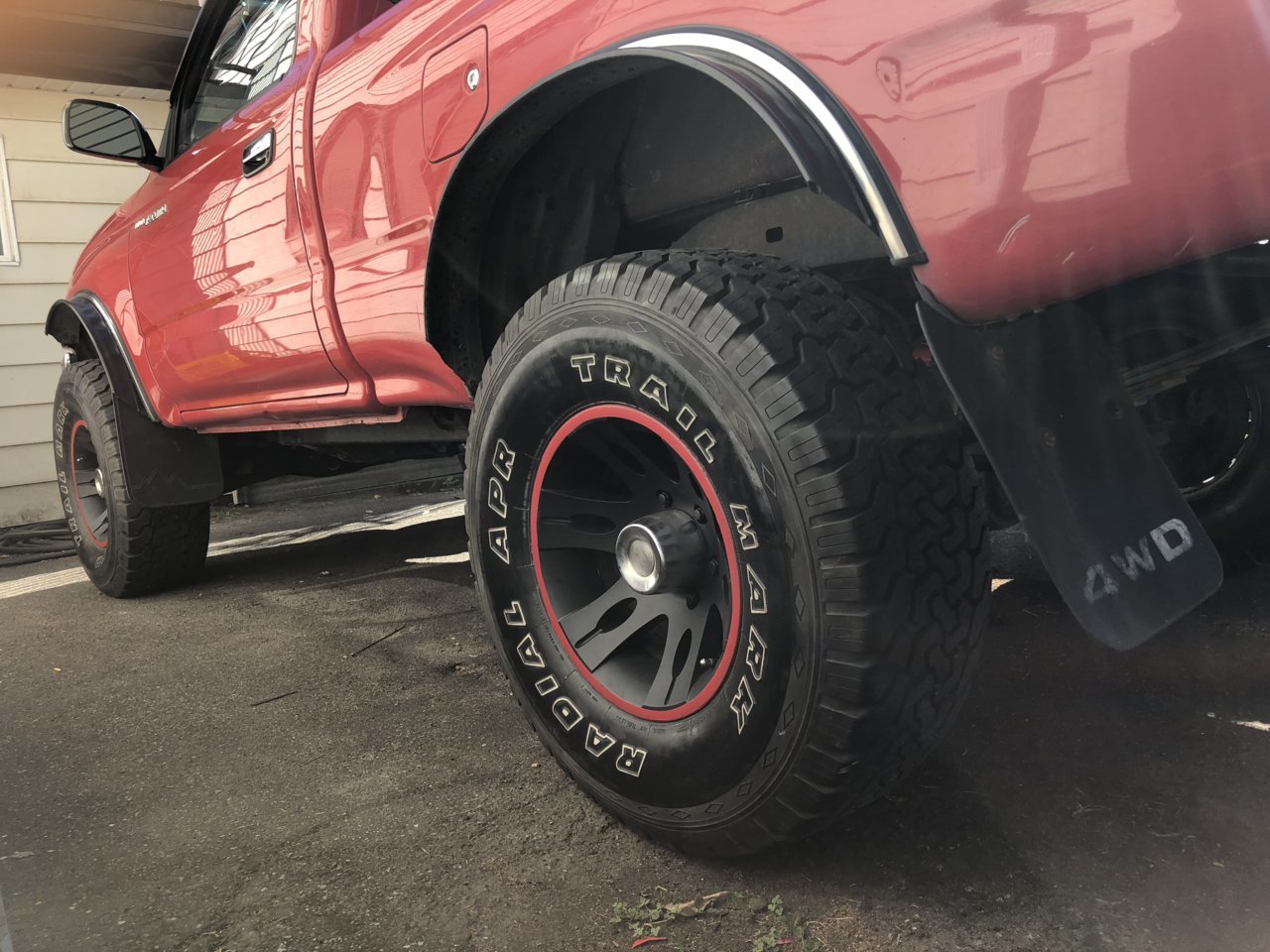

    Awesome work! I love what you did with the wheels too!!! :D
    I have a set of the same ones :)

    Thanks fam! They’re good rims you painted yours? I appreciate the love.
